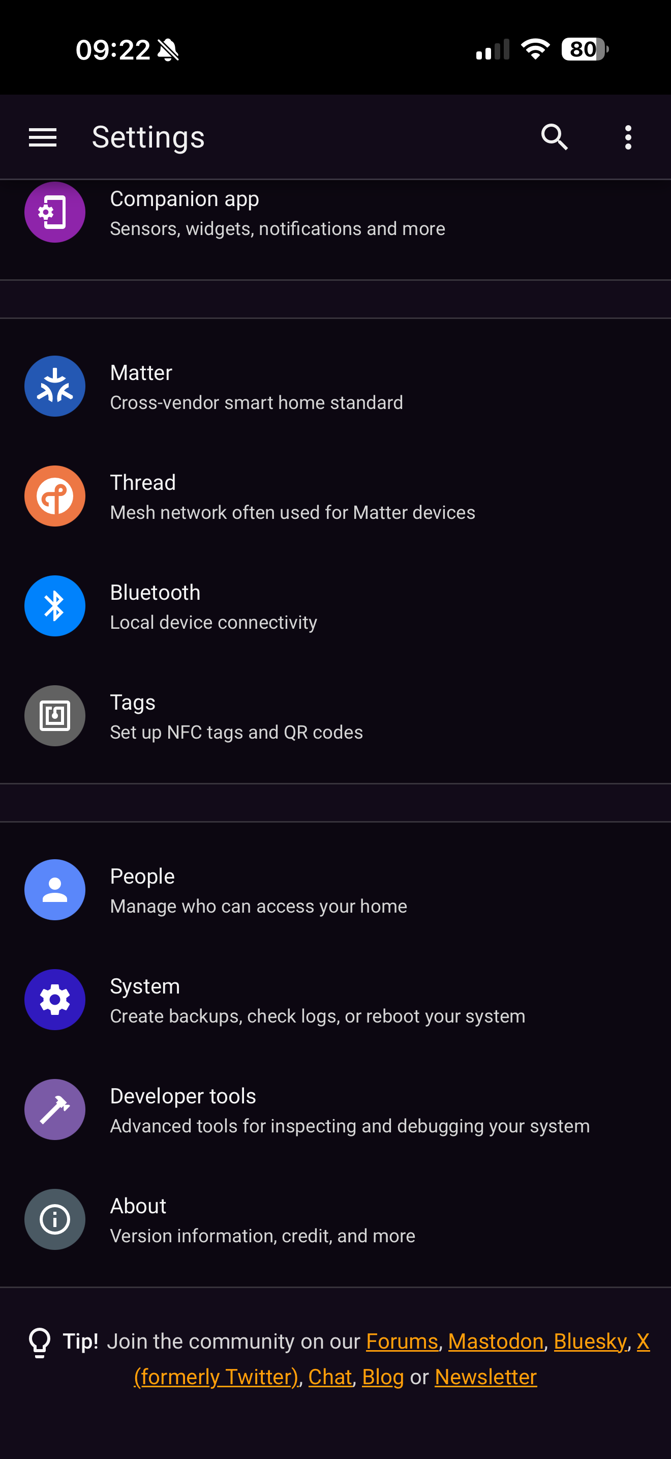

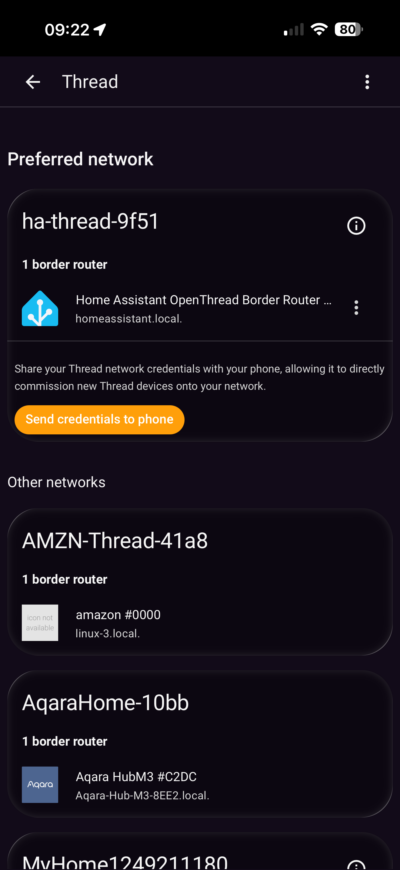

open home assistant on phone
click thread.
then make sure the home assistant boarder router is your default, but to be sure, send credentials to phone again.
