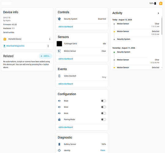

I’ve integrated my G410 with Home Assistant via HomeKit, and I’m also using Matter signals for facial recognition.
Since the HomeKit connection includes the G410’s motion detection as an entity, it is possible to combine the occupancy sensor via Matter and the motion sensor via HomeKit into a single automation. This should enable you to detect how long an event lasts. For example, you could use it to detect how long a person stays after ringing the doorbell. Since the HomeKit connection also includes the doorbell (ring) as an entity, you actually no longer need the Matter signal.
For lingering detection, however, I would still combine the Matter signal with the motion sensor via HomeKit, since the motion sensor also reacts to small movements or changes in light. The combination of AI detection via the Matter signal and the highly sensitive motion sensor via HomeKit should actually work well.

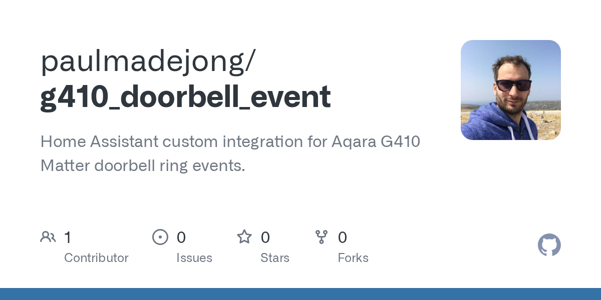

I built a small HACS custom integration for this:
It listens directly to the raw Matter occupancyChanged event and exposes it as a proper Home Assistant ring event, plus custom bus events for compatibility.
That has been more reliable for me than depending only on the Aqara Matter signal binary sensor as my automations now listen to both these “signals” and the binary_sensor from Aqara/Matter (whichever is received first).
