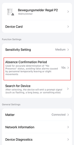

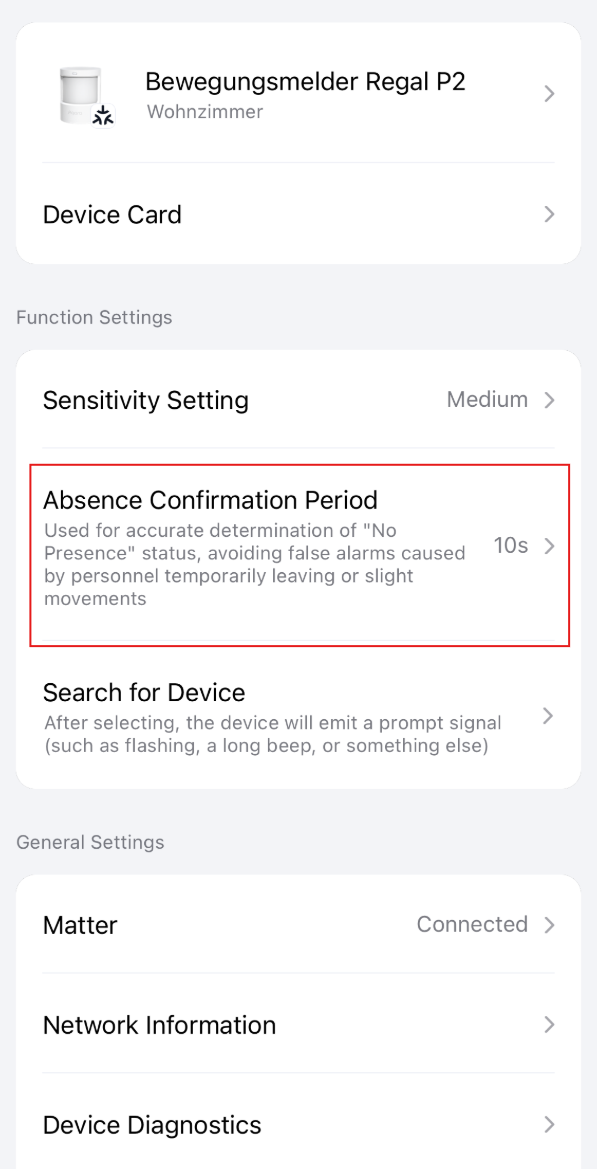

Hi again :slight_smile: What’s set under “Absence Confirmation Period” in your settings? And if you don’t have that option, what firmware are you using?

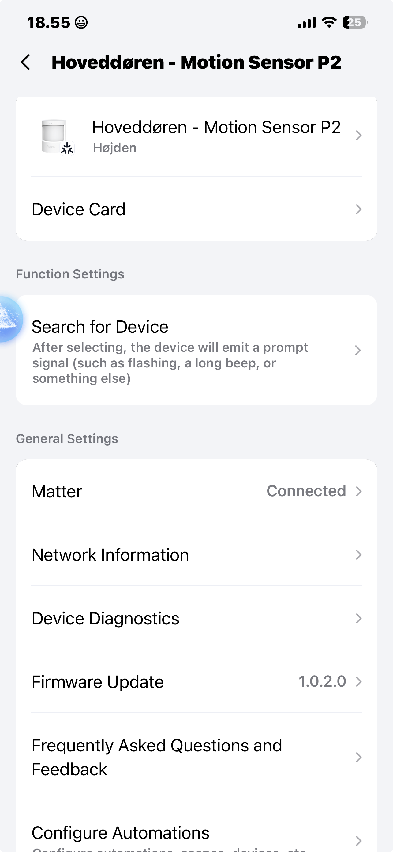

Hi JohnD, thanks! I don’t have the “Absence Confirmation Period” option at all. I also don’t have the “Sensitivity Setting” shown in your screenshot. My P2 is currently running firmware 1.0.2.0.
So this may explain the difference. What firmware version is your P2 running?
I think the option that @JohnD showed is only available if you use beta firmware/contact support and they update your P2. But normally the P2 doesn’t have this option and its settings cannot be changed. I also don’t have this option and that’s why I use P2 as a light sensor for my balcony lights (and P1, FP2 and FP300 for presence)

He is showing Firmware 1.0.3.0 which was pulled and is no longer available. The newer Firmware gives additional options.
Yes, you can try customer support and request the updated Firmware. No guarantee it will solve your issues.

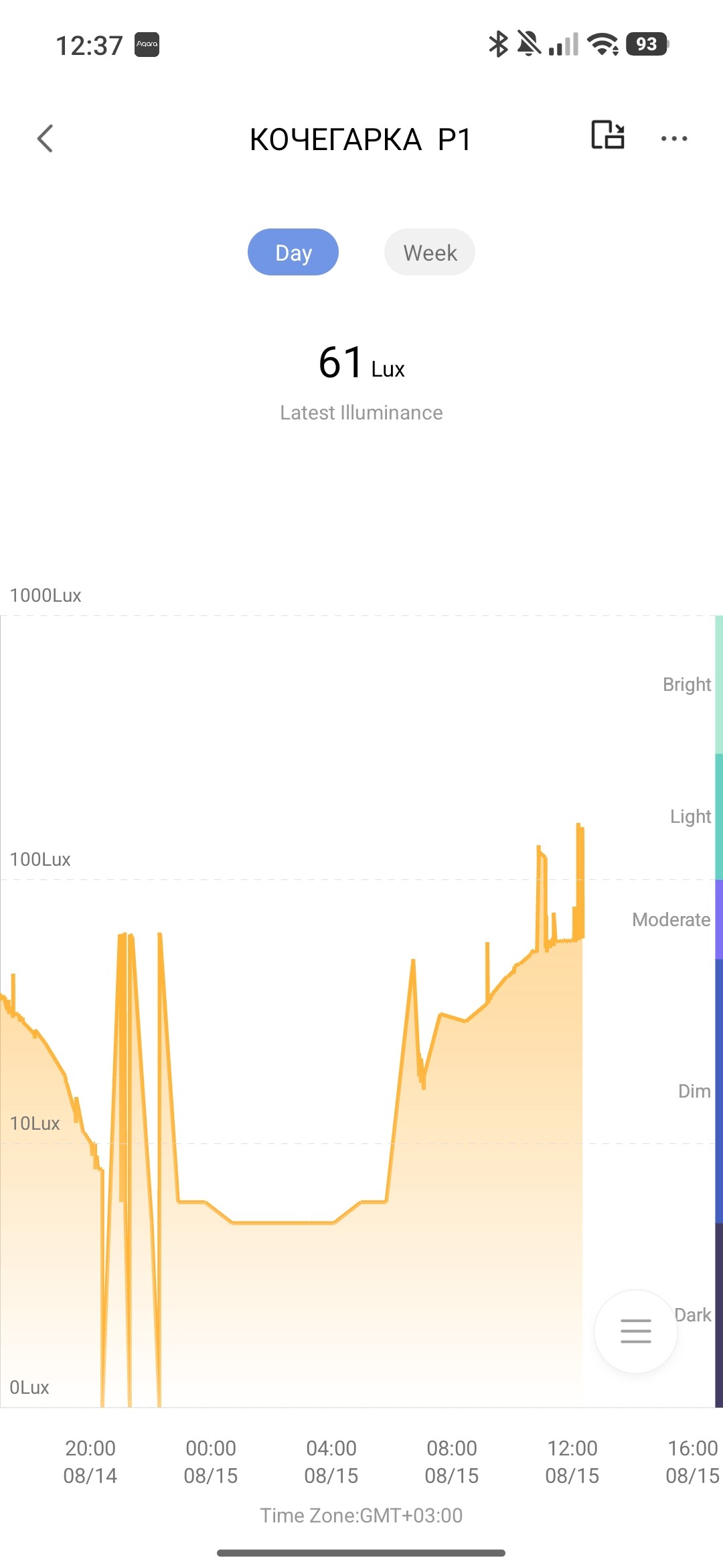

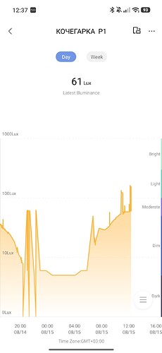

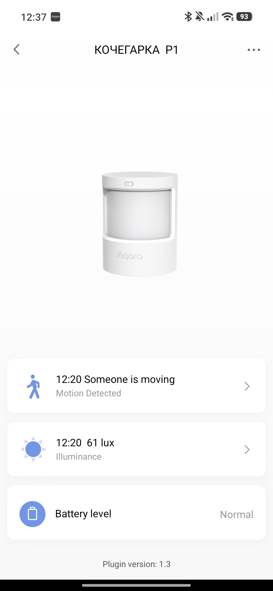

How is it not??? There is a measurement of the lighting level! :smiling_face:
But you should mention that the P1 only measures light when it detects movement. The P2, on the other hand, measures light when there are significant changes in light levels, not just when it detects movement. So it’s a little better.
You are absolutely right! :blush: I completely missed that it also has a built-in light sensor. Thanks for pointing that out and for the screenshots!
