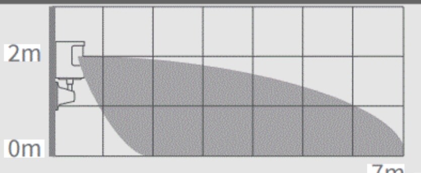

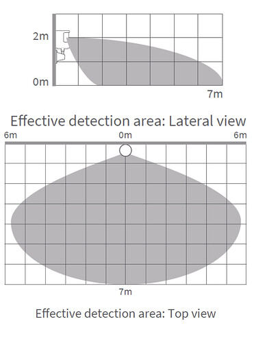

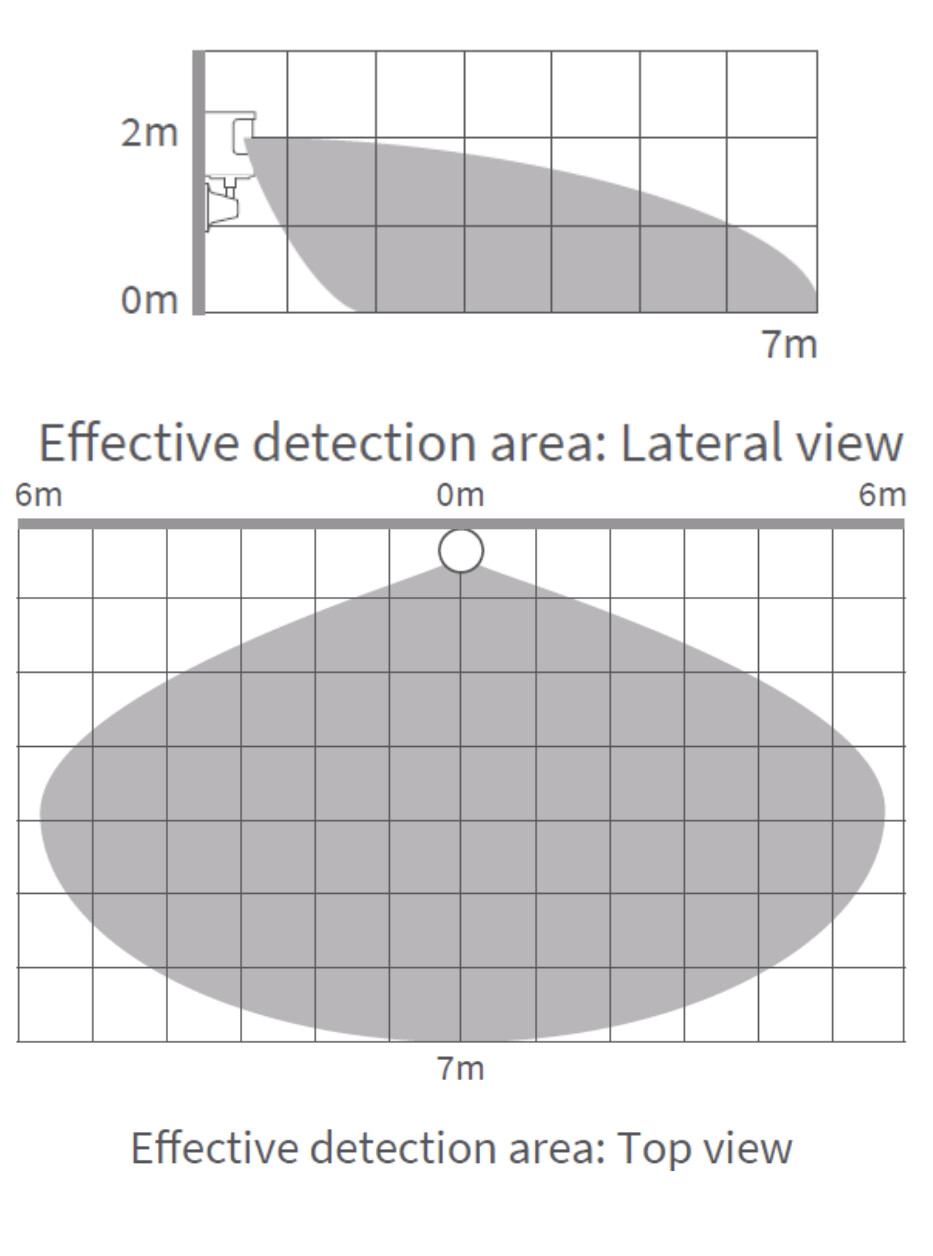

Hi, the sensor’s directional diagram will help you. I flip them and get a perfect control zone (limitation on the lower control).
Okay yes this is a great help, do you by any chance also have an horizontal coverage area schematic diagram?
