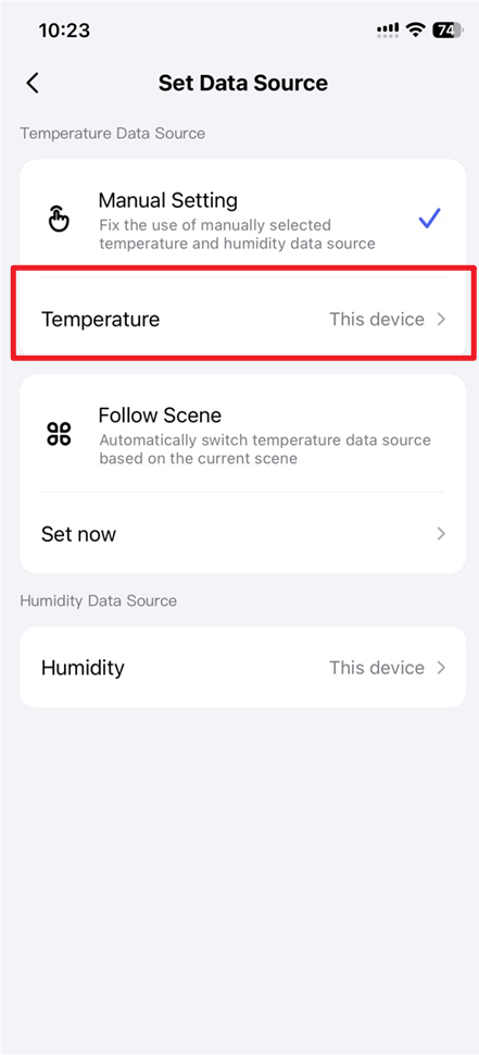

  1. Open the W200 device page in the Aqara App, tap the three dots in the upper-right corner, and enter Data Source Settings.
  2. Select the manually configured temperature option, then go to Linked Sensors.

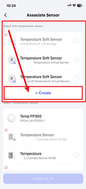

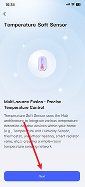

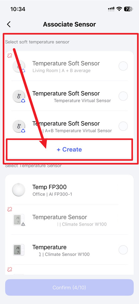

  3. Tap Create in the Select Soft Temperature Sensor module and click Next.

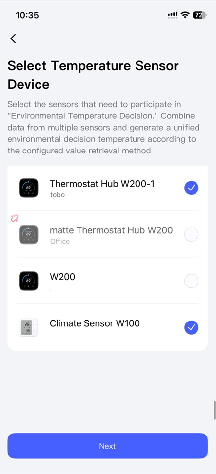

  4. Select multiple sensors you need to use, then choose to apply either the average value or extreme value for data calculation.

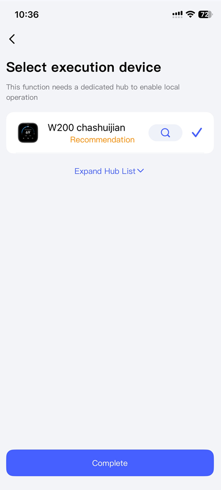

  5. Select a hub (the default recommended option is preferred) to complete the setup.

Do you need an actual hub, not just a thermostat hub? I tried to create a soft sensor and it says it can’t find a supported execution device.
The W200 itself is a hub. You can try adding the temperature and humidity sensor as a sub-device of the W200.
