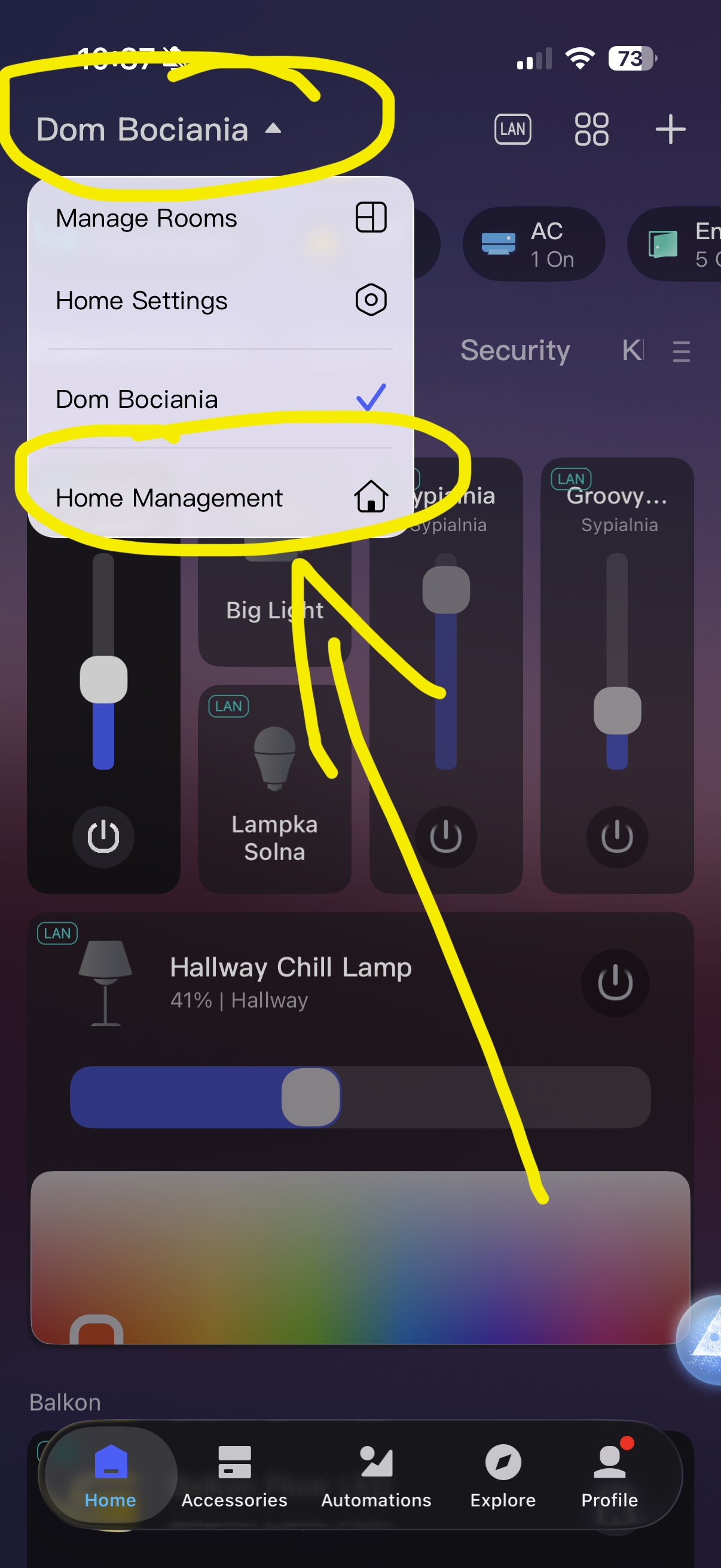

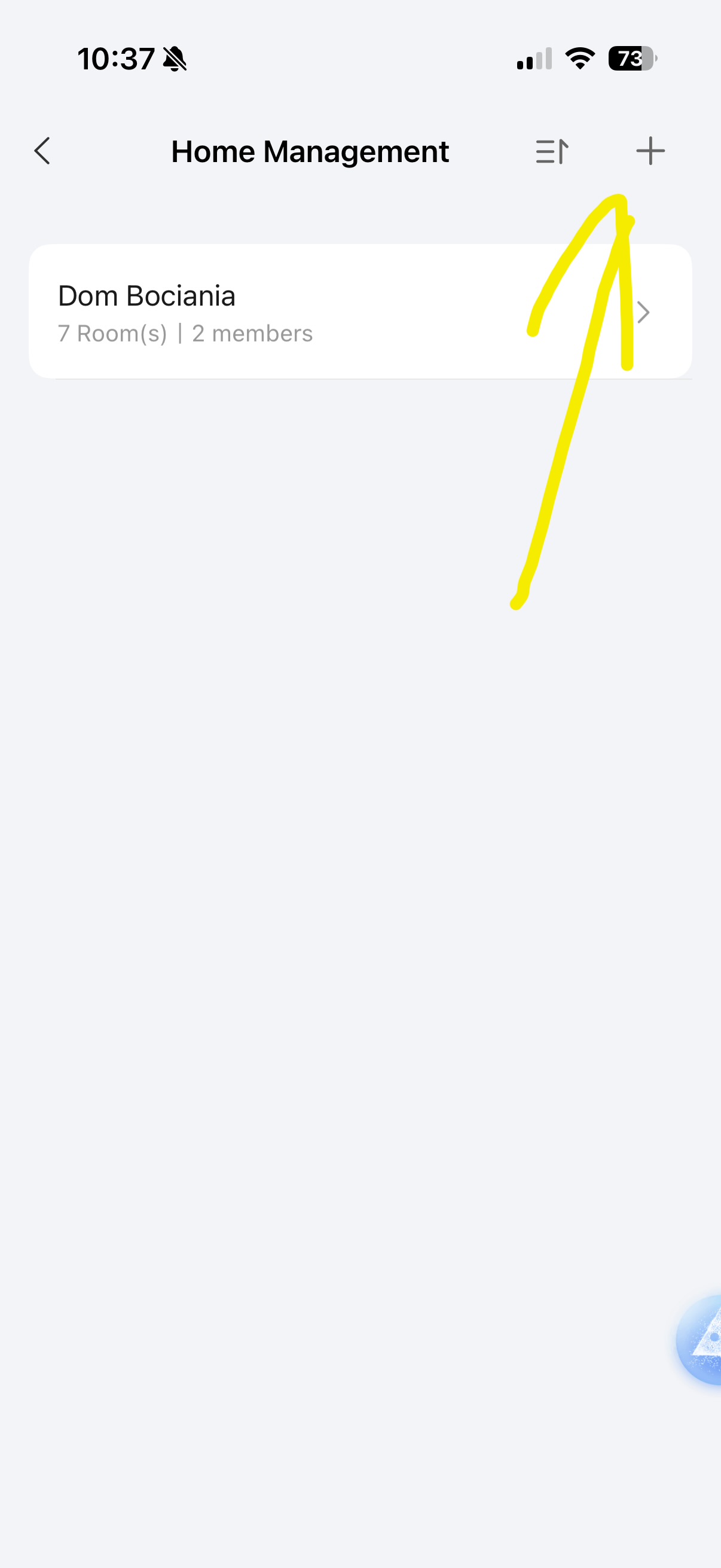

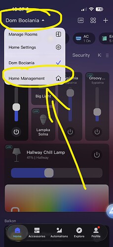

Before pairing the hub, create a new home in Aqara app (to make it separate from your devices)
On the main screen, click the list in the top left → Home Management → +

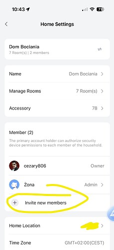

The home (with all devices) can be shared to other users (your mom, for example). The other users can be also the admins of the home.
If you create the home, switch to it on the home screen before pairing the hub.

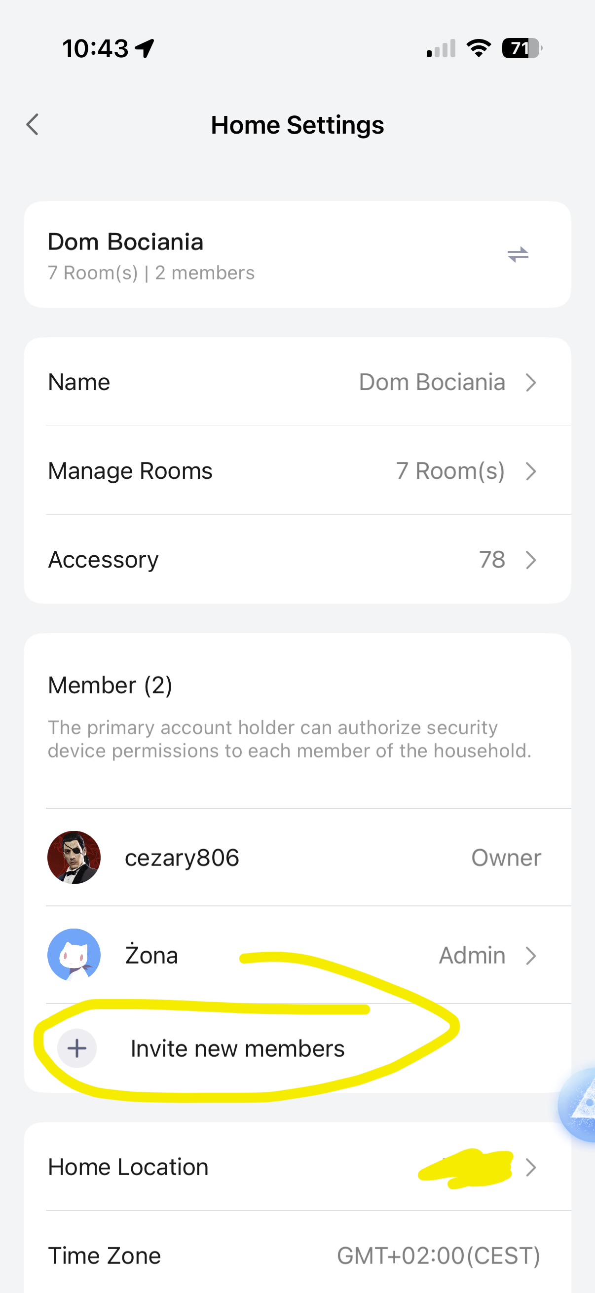

You can invite a user to be an admin of the home by selecting a home in the Home Management and then selecting “Invite new members”.

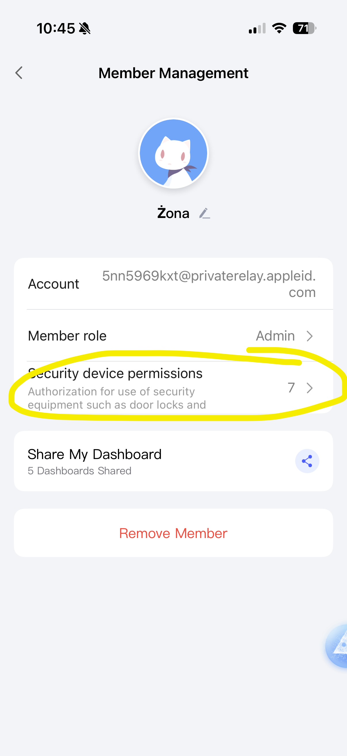

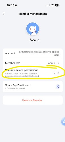

Btw if you have cameras or presence sensors, then those have separate access control. After inviting the user, open their profile and permit the user to use cameras using this option:

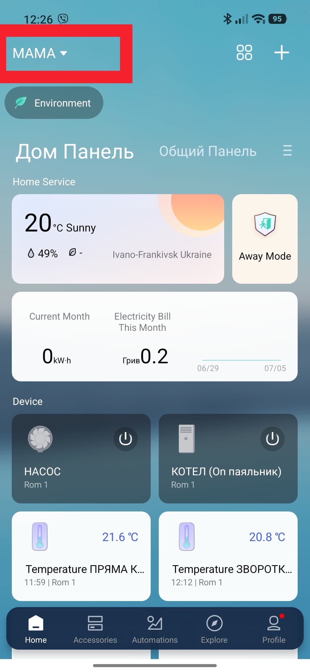

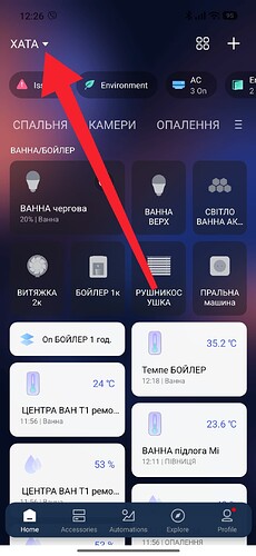

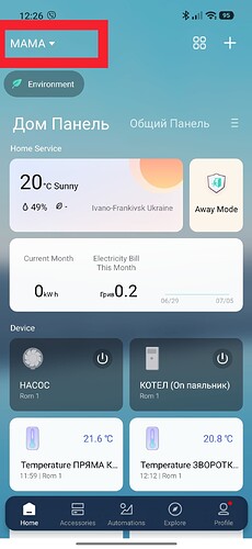

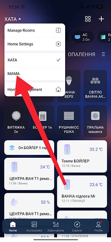

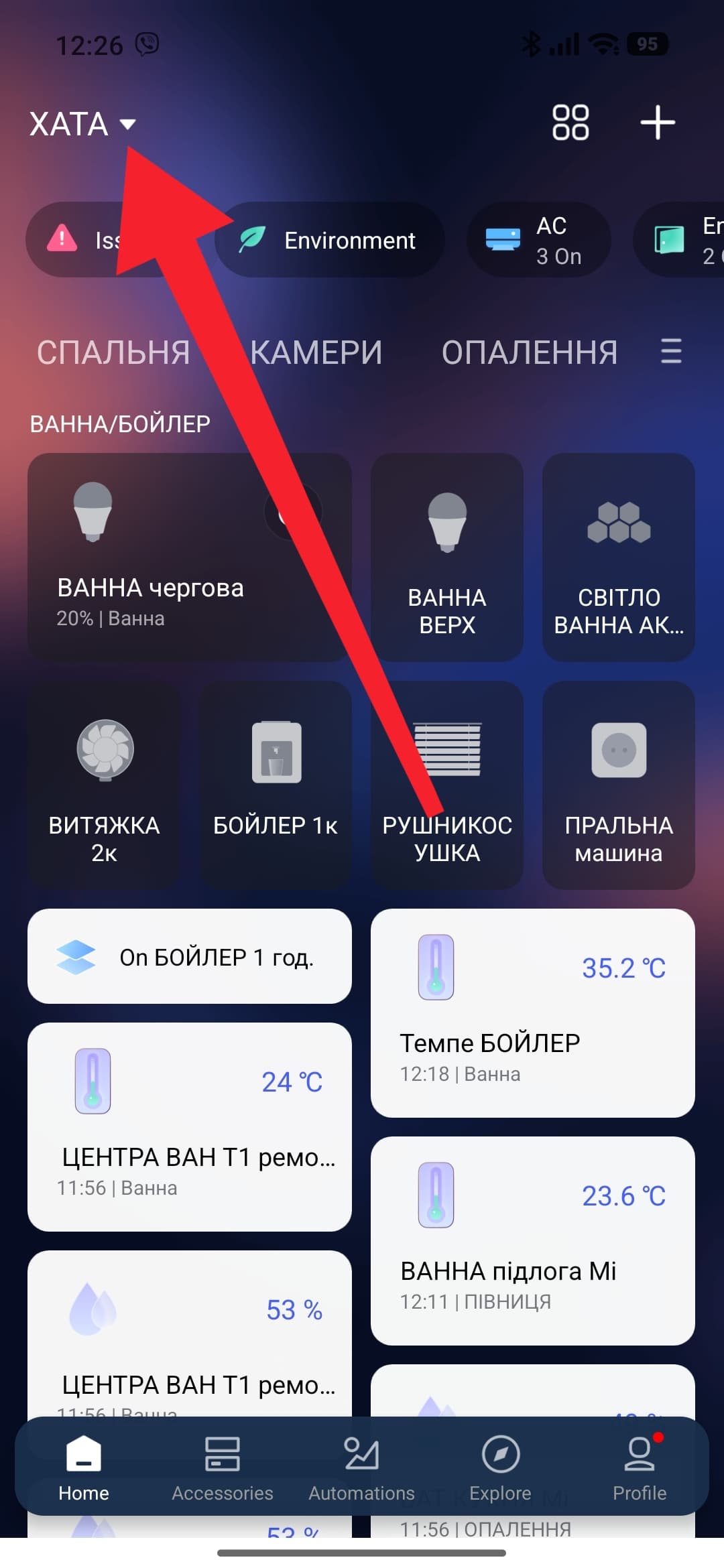

Hello, welcome to the forum. I will add @cezary806, I will show my home for myself and my mother on the screens. It looks like this.
