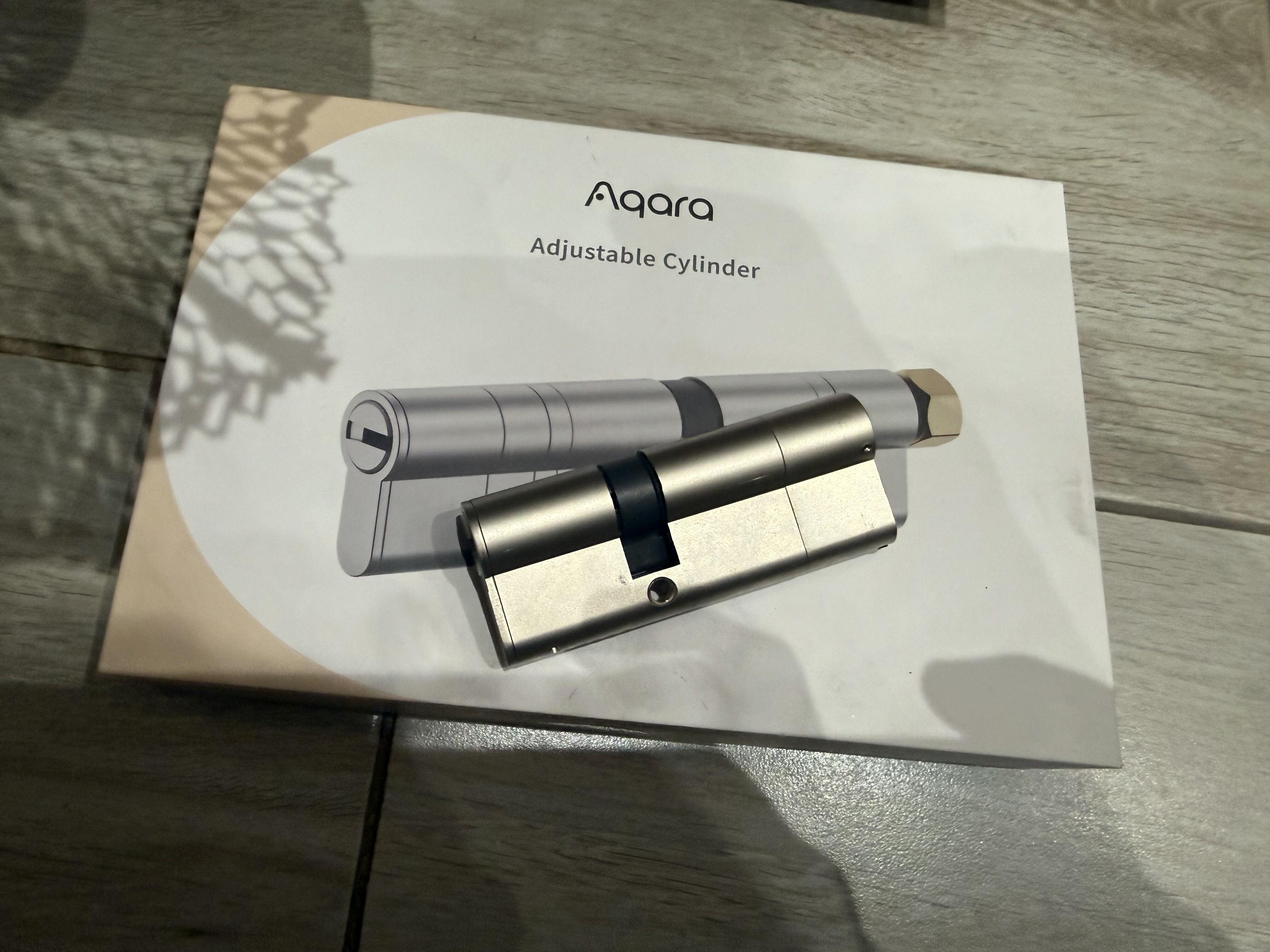

I had a U200 with an Aqara Adjustable Cylinder (made specifically for the U200) mounted into a mortise lock. The cylinder is actually quite solid (and uses a dimple key), it looks like this:
The extensions are secured with small screws at the bottom and, if you don’t screw them firm enough, they could fall apart when you slam the door. But the cylinder is also secured with the standard screw, so it should be good.

The Aqara Adjustable Cylinder does not use a key on the inside - it has a bolt like this that is meant to be turned by the U200:

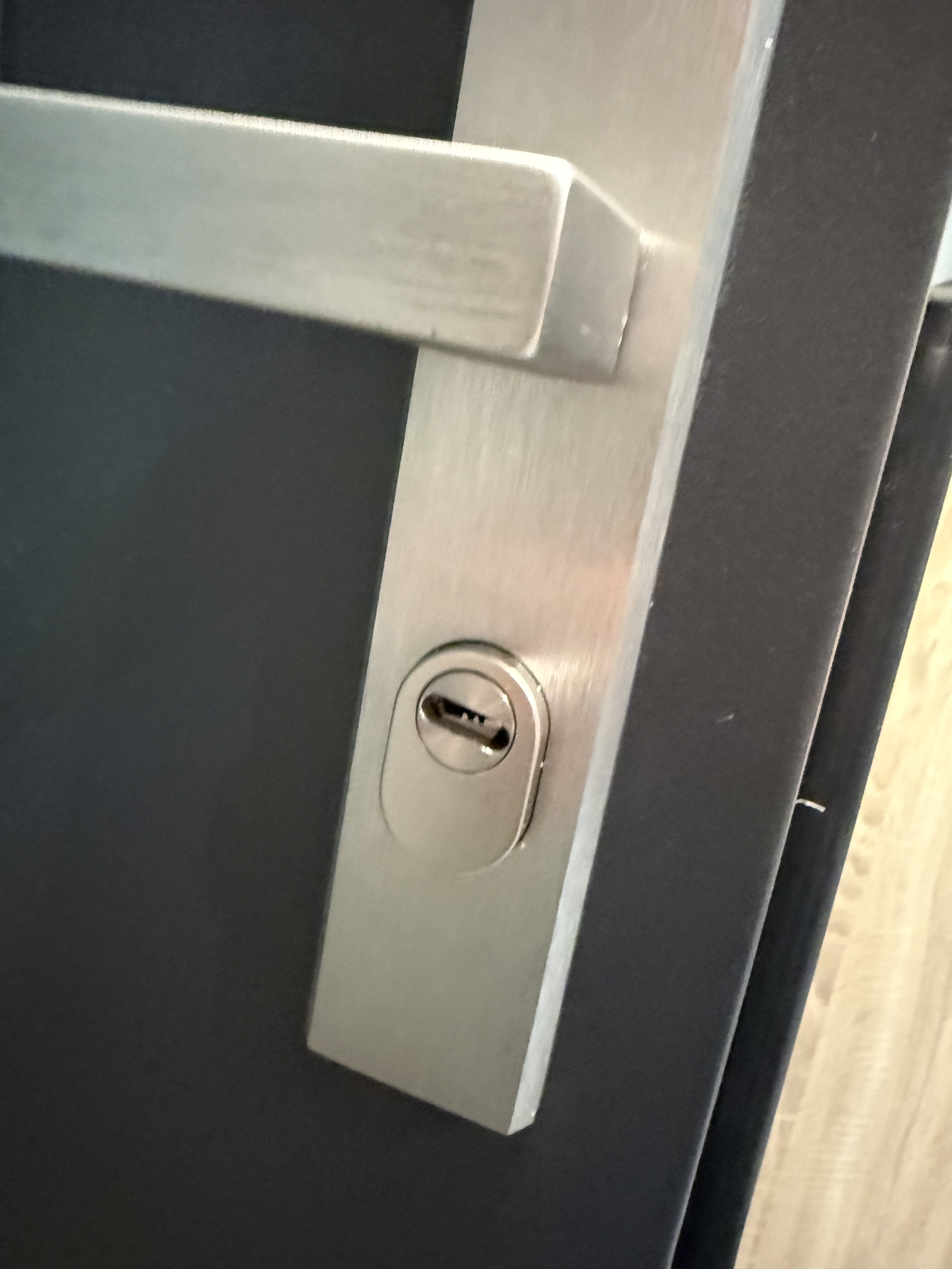

But - the shield. The shield looks like this, and the key is wider than the crevice, so you are not able to pull the key through it:

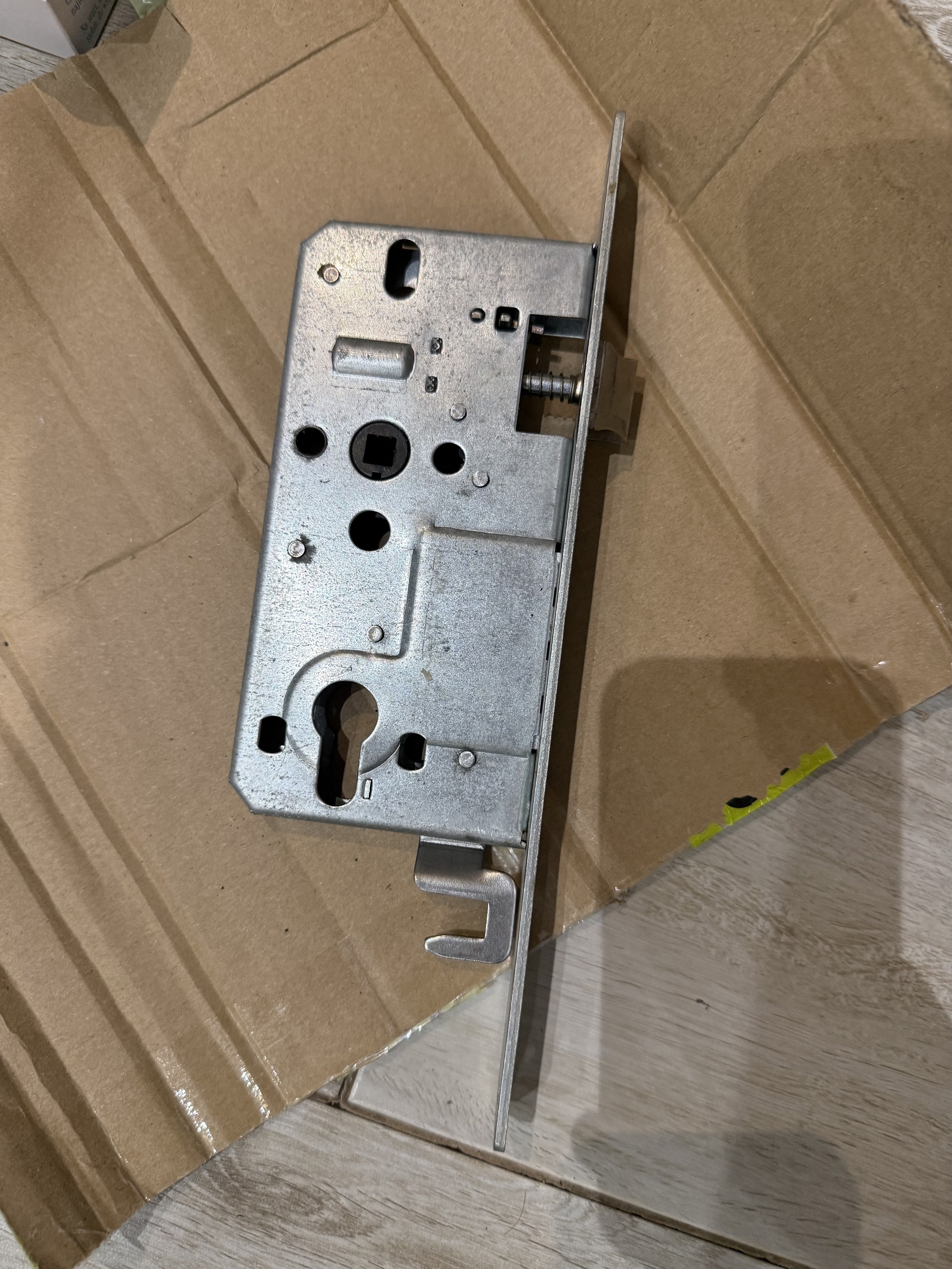

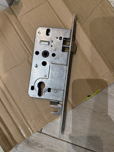

Bonus: photo of the culprit

But I was always curious - there is additional bolt very low (almost near the floor) and it never moved when turning the key. Was there supposed to be some another mechanism for this bolt?
And after replacing the lock now it works. So it looks like the lock was broken for some years, and it finally started giving up.
