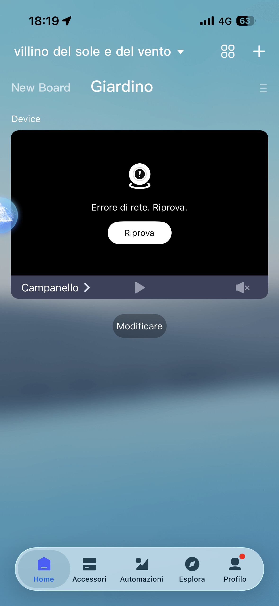

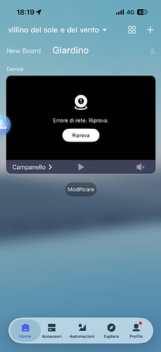

My aqara g400 no longer connects to the main unit
