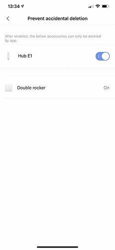

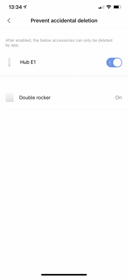

Good idea to contact support so they can check the hub logs. Also make sure to enable Preventing Accidental Deletion in your hub settings since it helps avoid devices being removed automatically from your setup.
