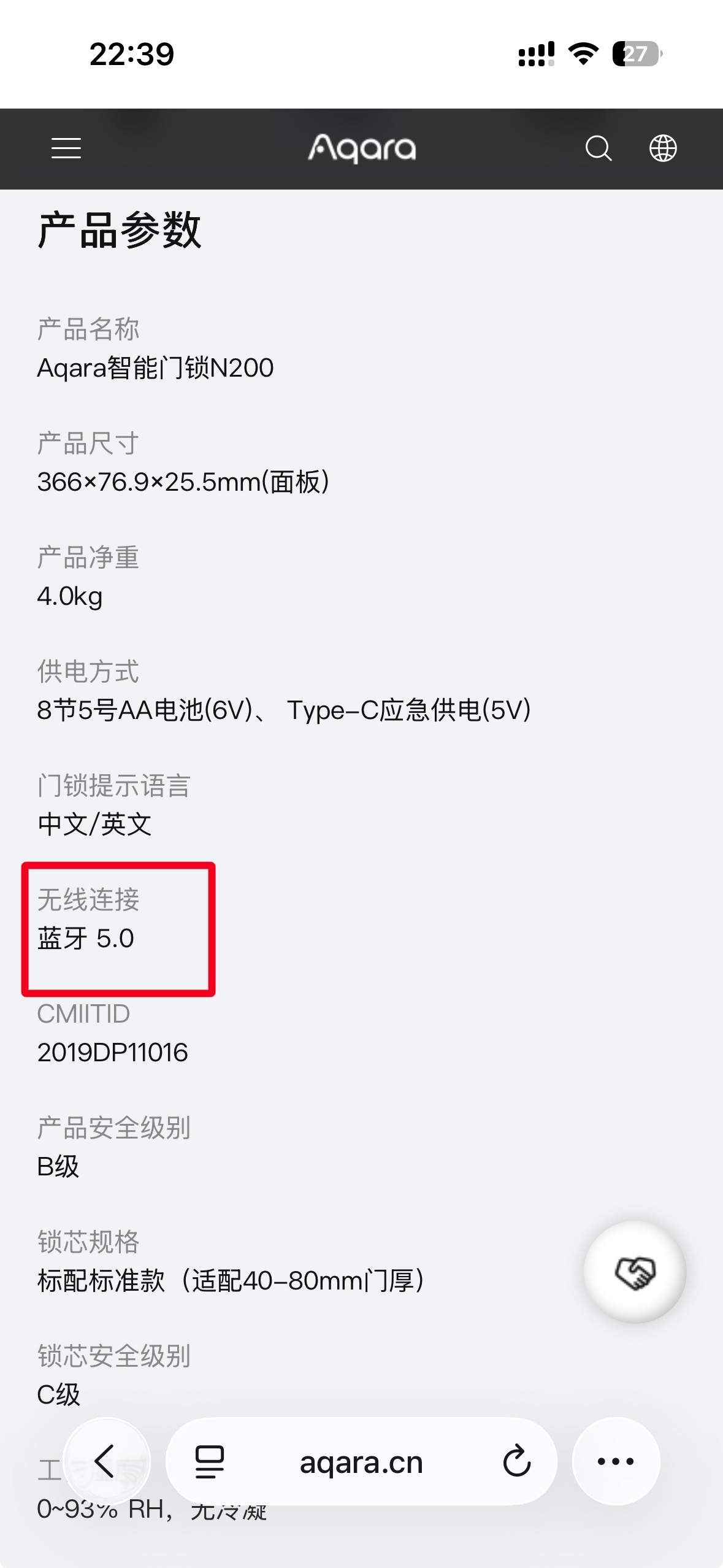

Hello @pirulo_home
The N200 lock only supports BT 5.0 (Bluetooth).
Remote unlocking is only possible via HK and probably Mi Home. For Homekit, you’ll need an Apple smart home hub. I can’t recommend Mi Home as I don’t use a Xiaomi Home.
