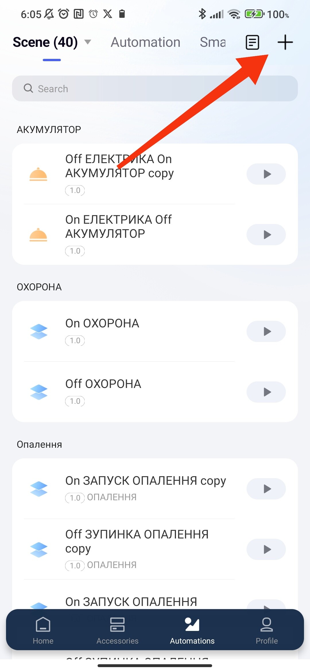

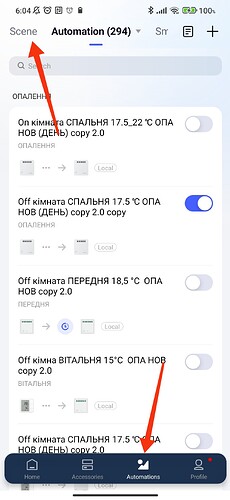

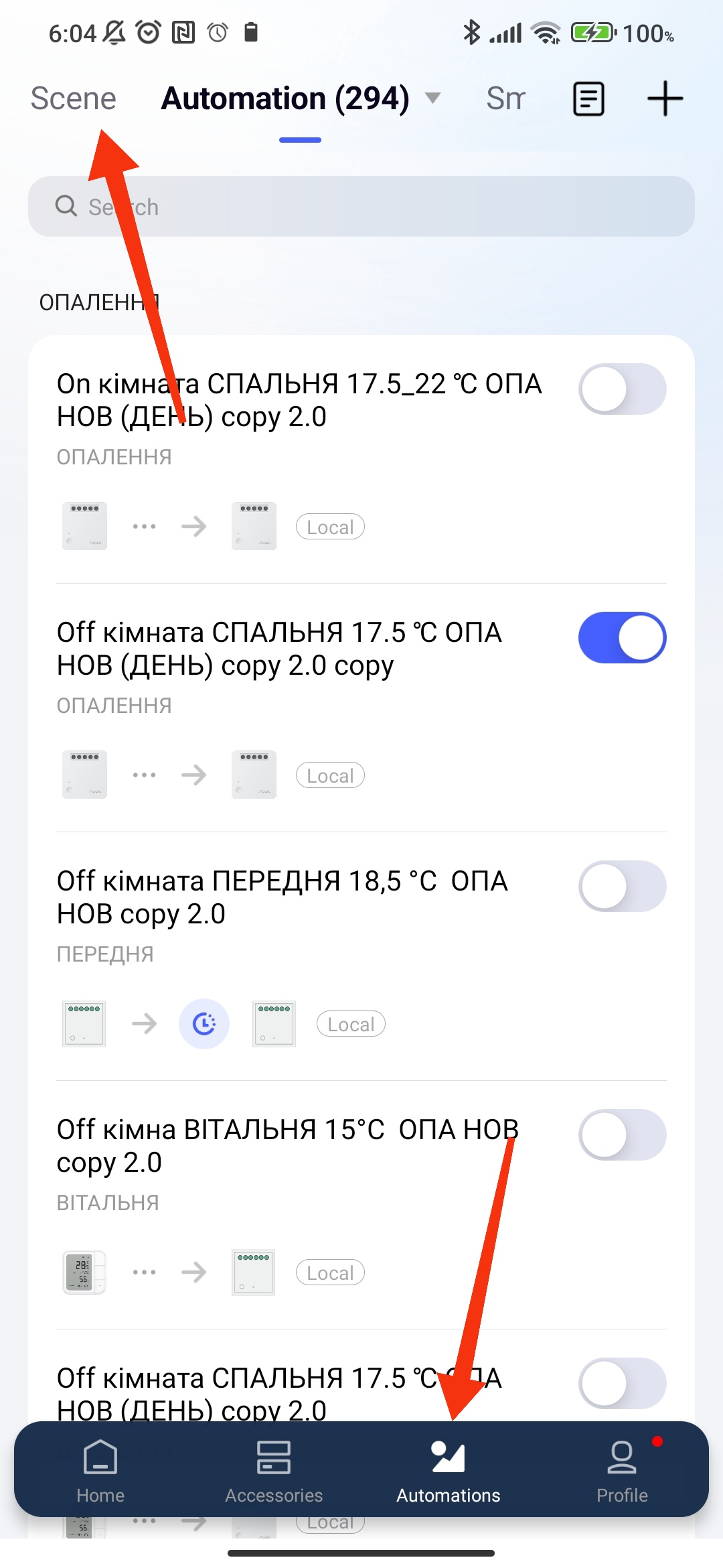

Please explain, you only have M3 and nothing else. If so, then you need to make not automation, but scenes that fulfill certain conditions with the air conditioner. And you can control the already created scenes from your iPhone, having made some settings in order to make quick launch buttons on the phone screen. Note, scene templates must be created in Aqara home.

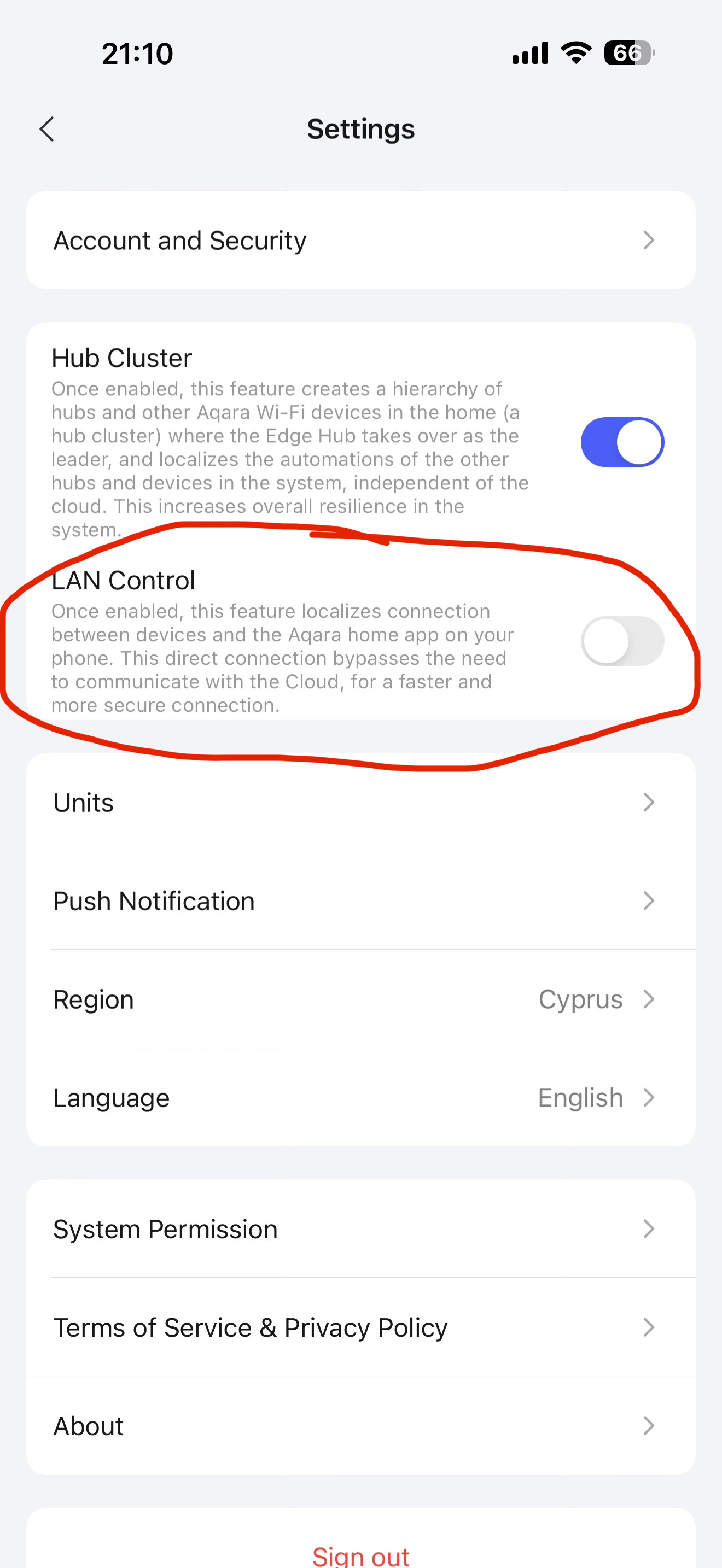

So to be clear, geofencing shortcuts WILL NOT work with LAN mode enabled, right?

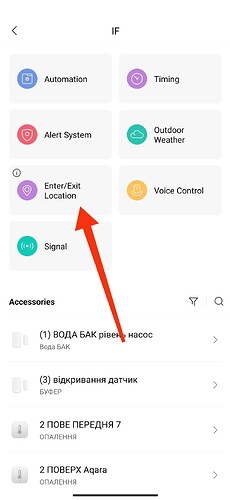

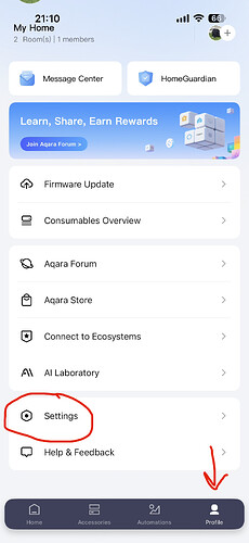

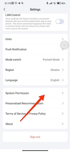

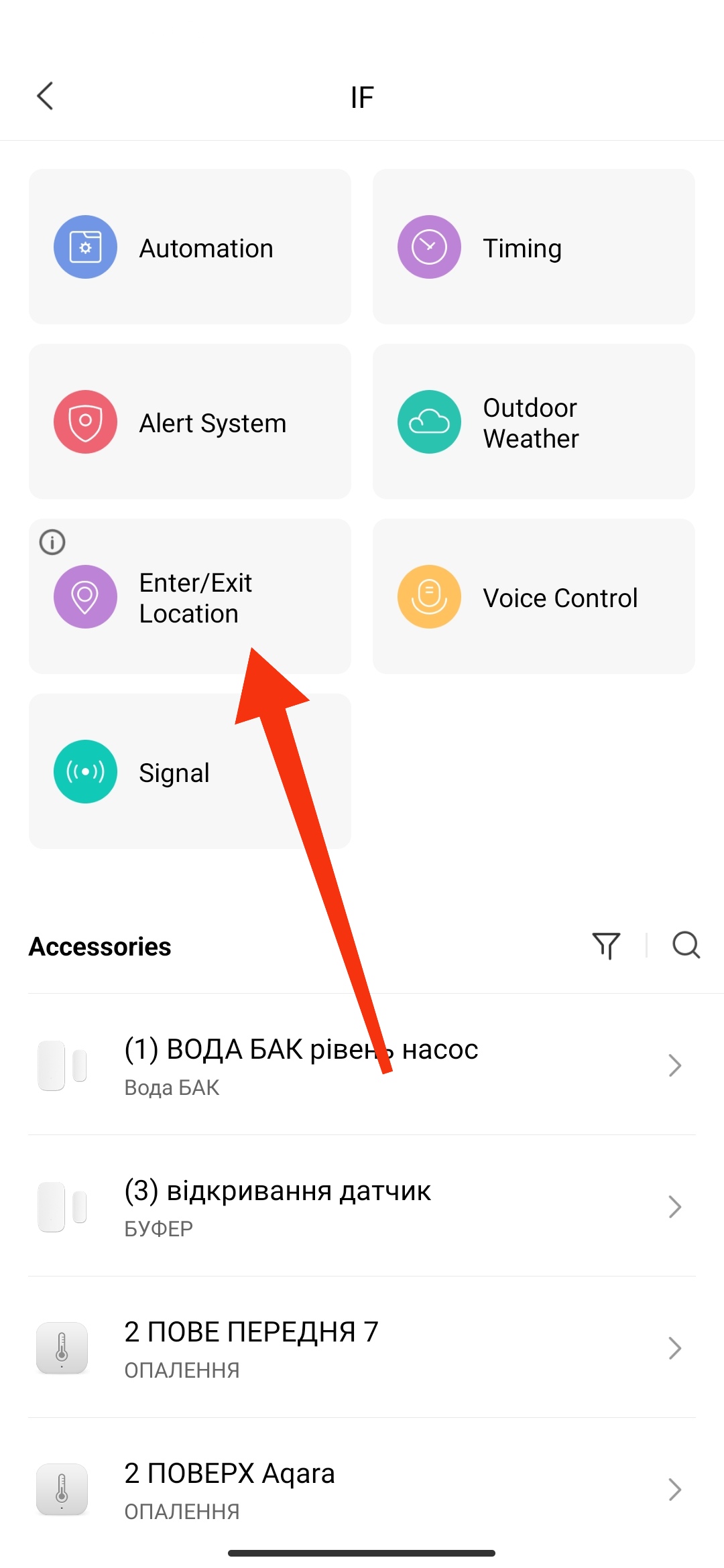

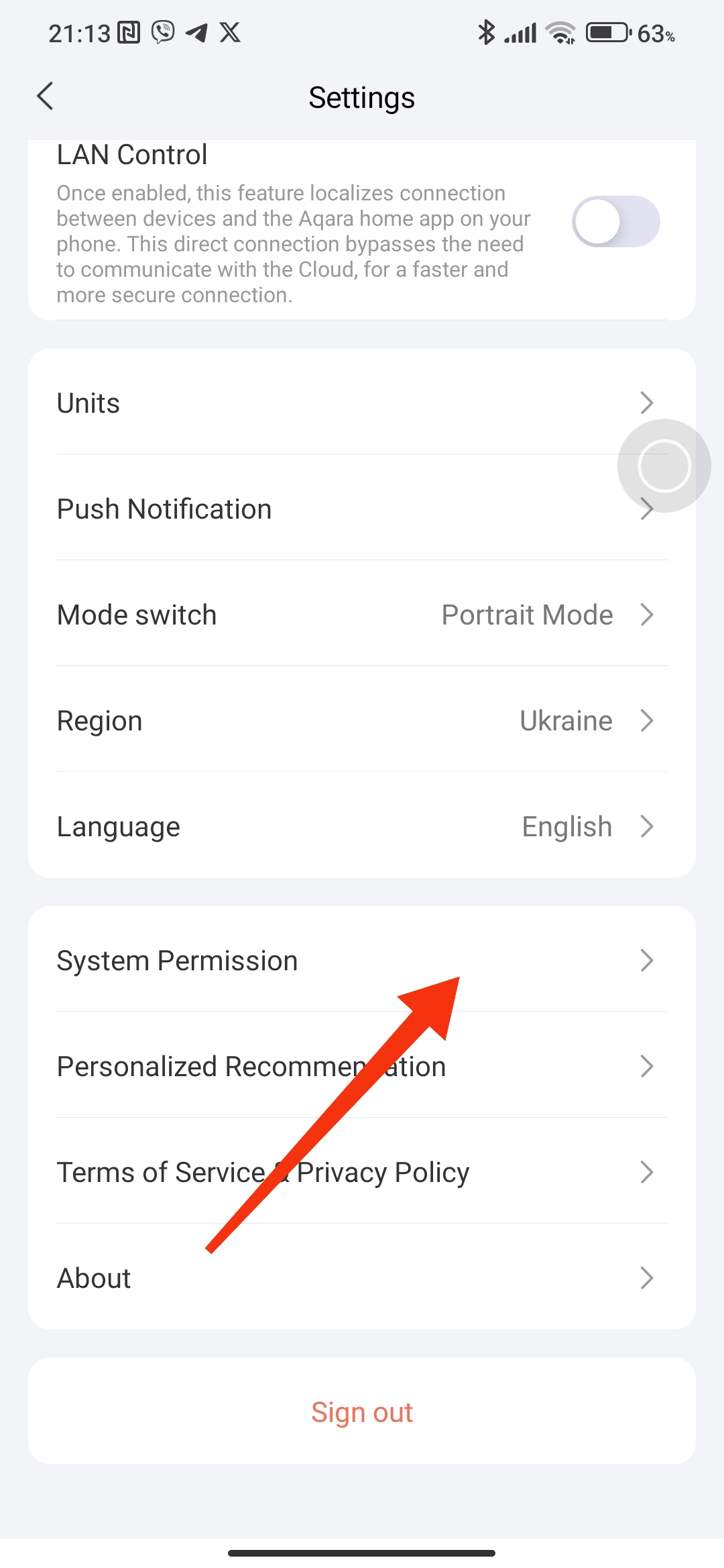

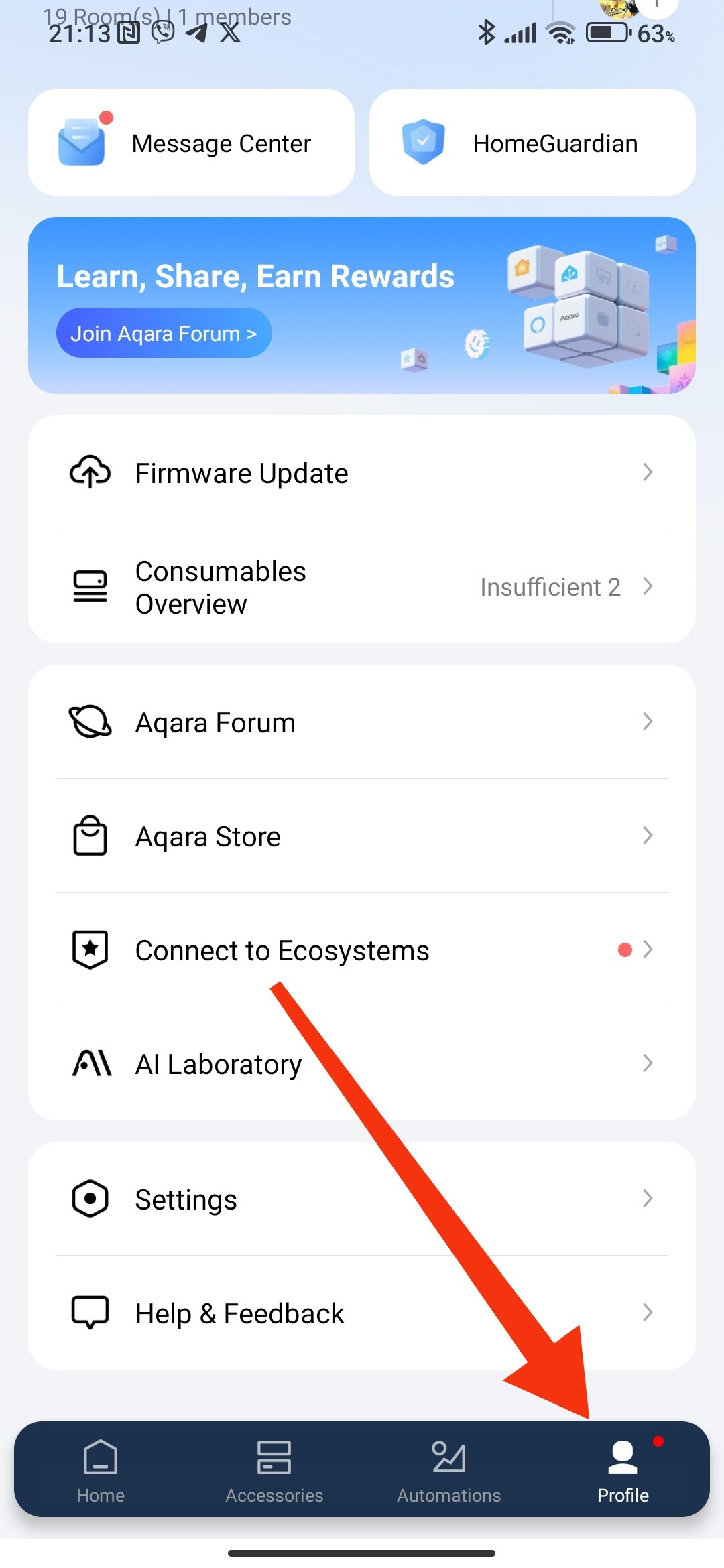

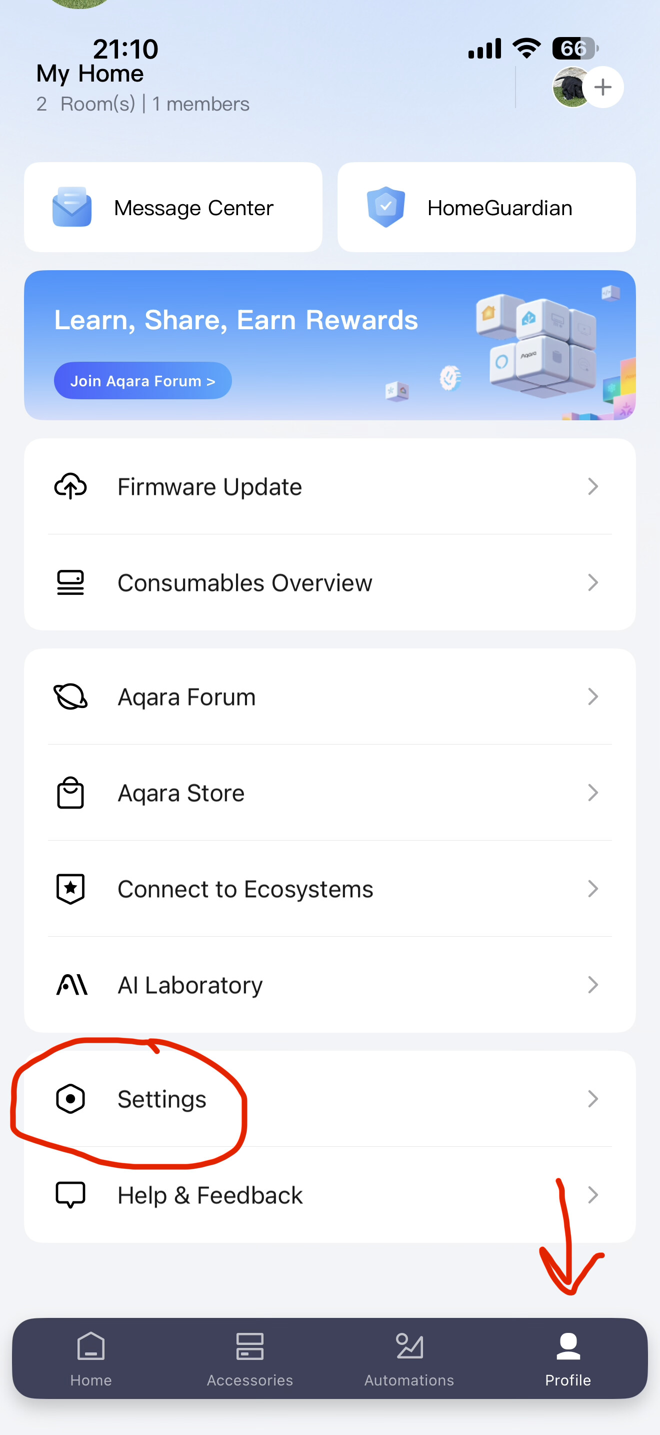

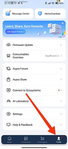

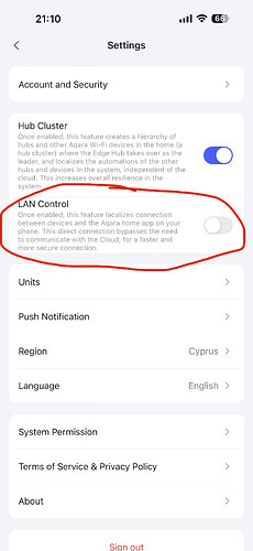

Hello, @dole_dervish_0n what LAN mode are you talking about? Please take a screenshot of what you are talking about. Geolocation has no restrictions.
Have you given permissions for Aqara home?
This should be turned off, LAN mode is for other purposes, I’ll explain later.
This mode is needed when you don’t have the Internet and you need to control a switch or other device, then you do it locally. In your case, it will not be enabled.
