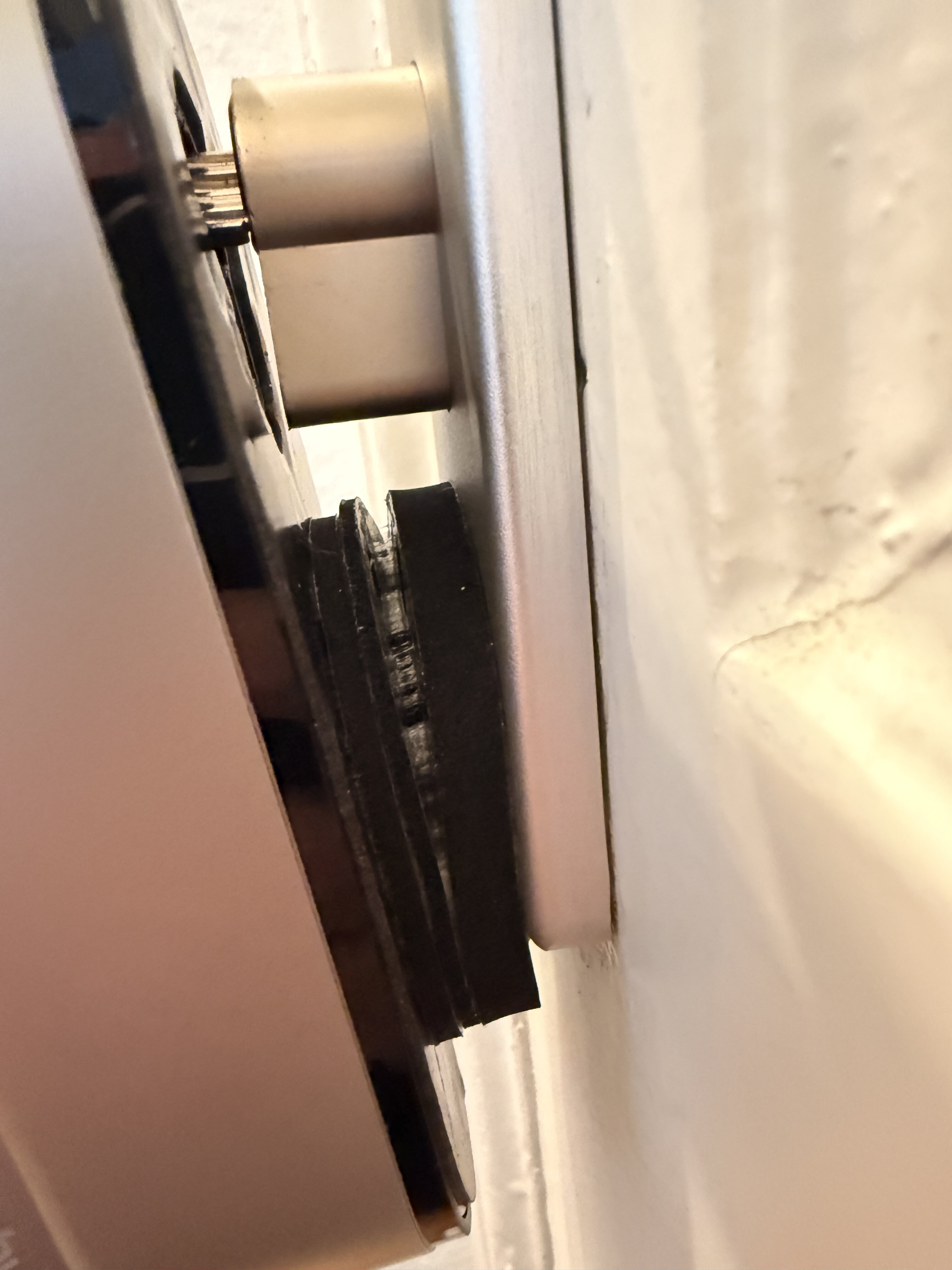

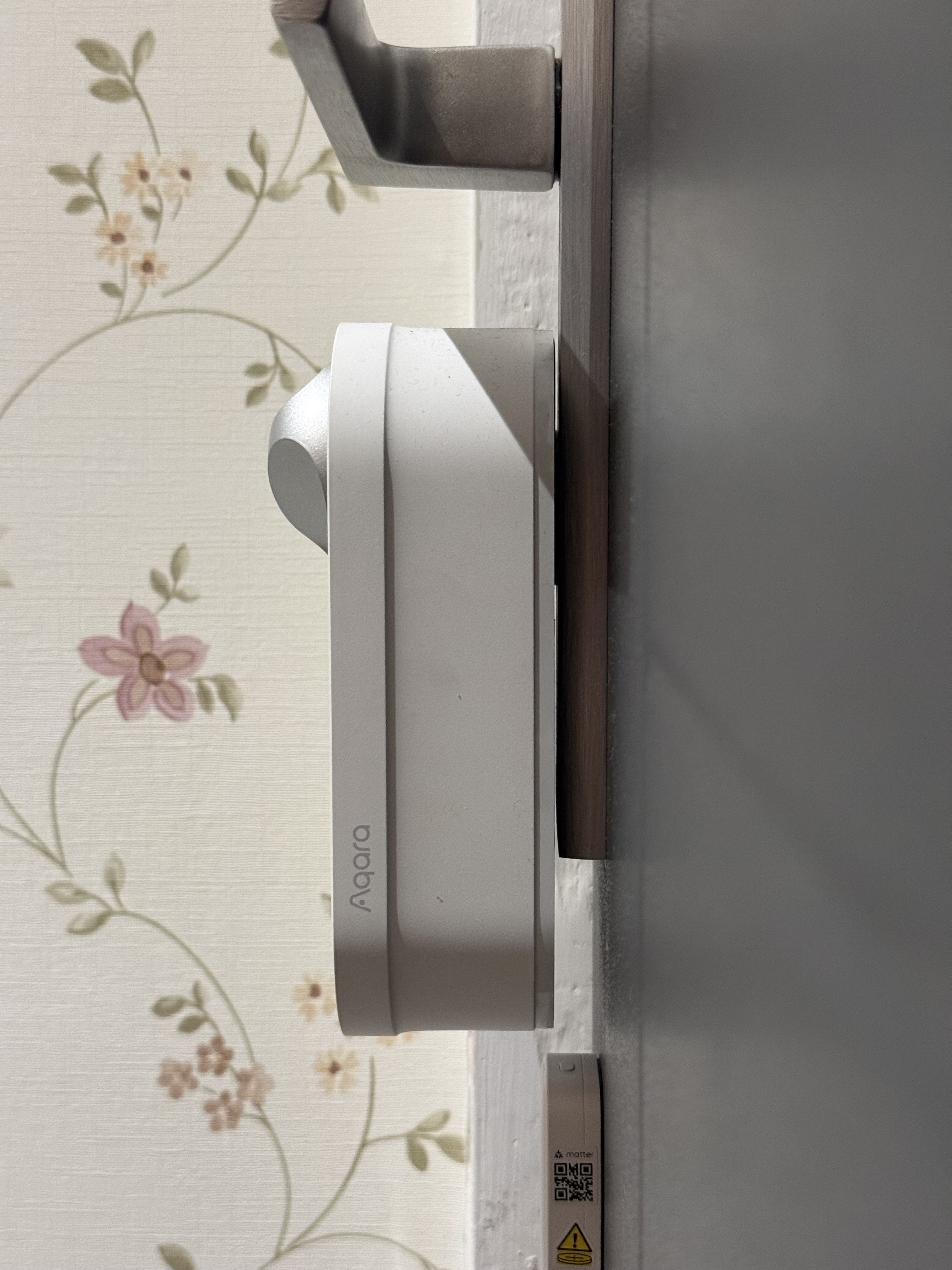

Maybe you made something wrong?! Can you post a pic of your installation?
Otherwise I would contact the support and ask for the necessary items

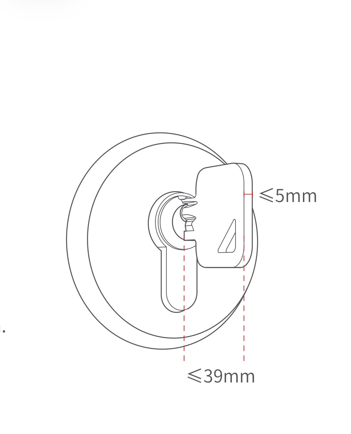

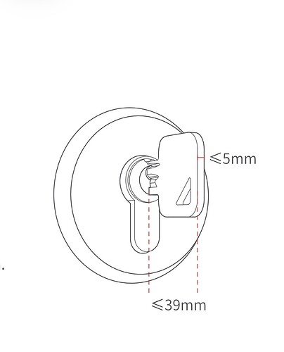

It looks like the key is too long, it should not be visible. The manual states the key should have maximum length of 39mm.
You need to shorten the key (the key handle).
This is how a correct installation looks like.
Btw the lock has a spring and you need to push it all the way before screwing the front module into the backplate. But in this case, it really looks like the key is too long

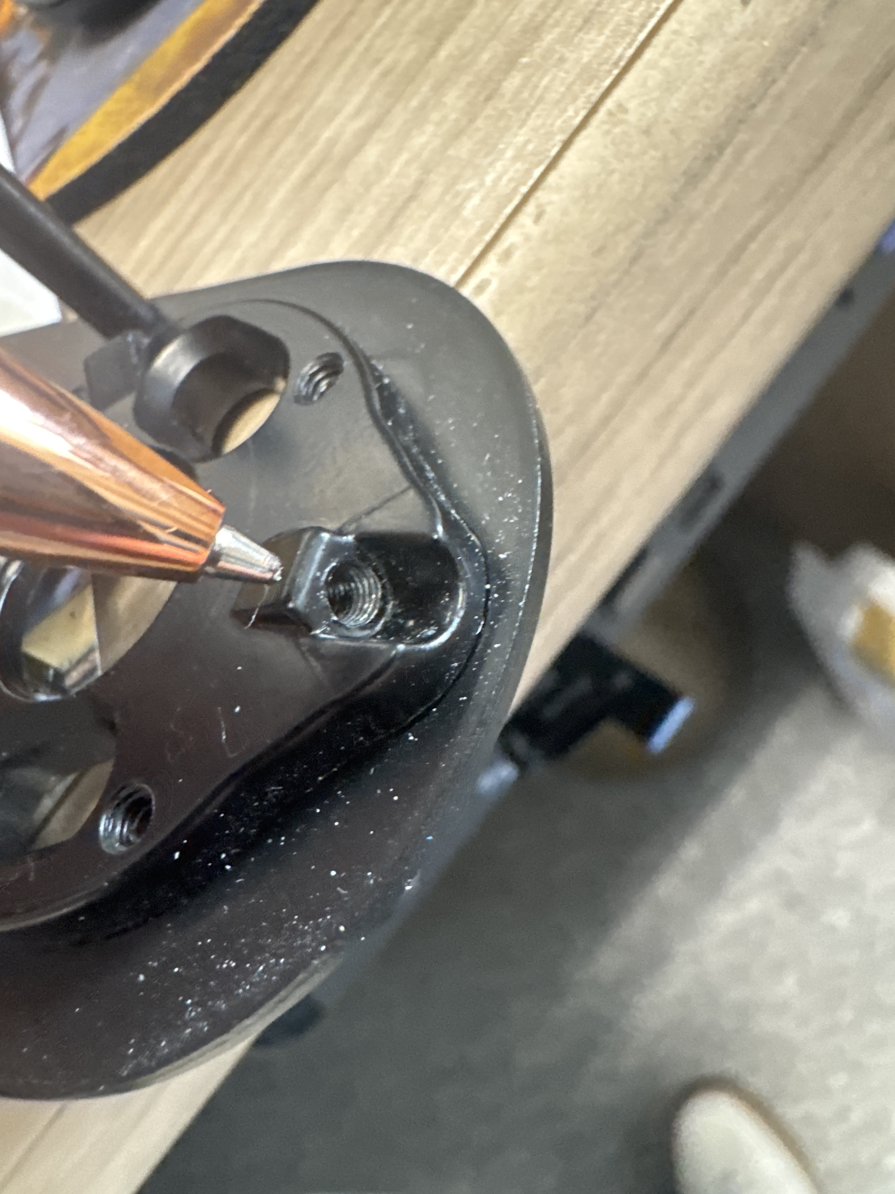

That’s definitely wrong! Did you screwed on the small 3 grub screws on the cylinder?
BTW I don’t see the mounting plate at all :grimacing:
Hi @cezary806 , key handle is fine.
I forgot three tiny screws inside the lock
Hey @DEChrisE , you nailed it.
I forgot to tighten the three very, very tiny screws to mount the cylinder properly.
