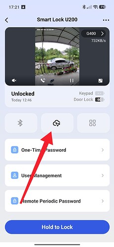

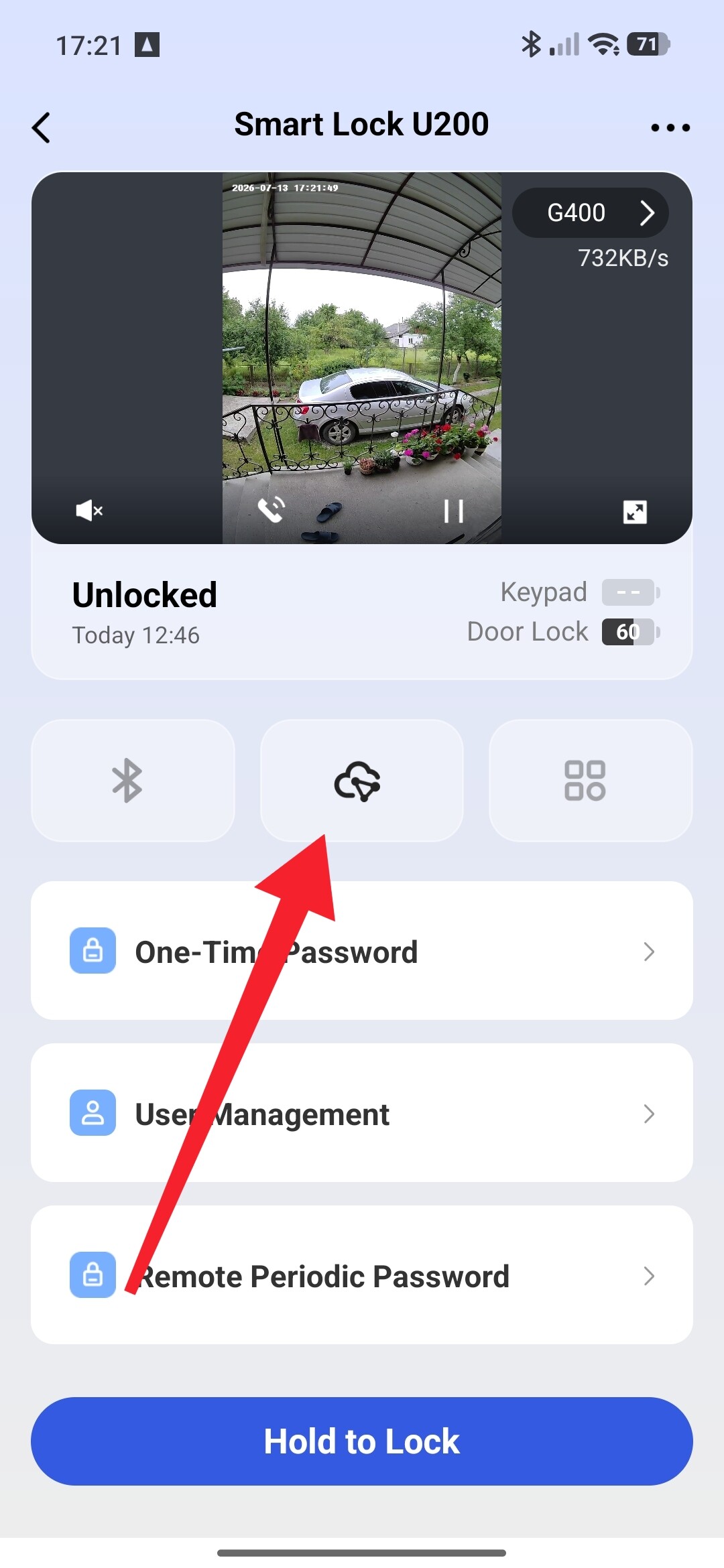

Hello, welcome to the forum. First of all, check if the M2 gateway has the latest firmware (4.5.30). Then in the lock settings, use this window for configuration.

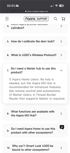

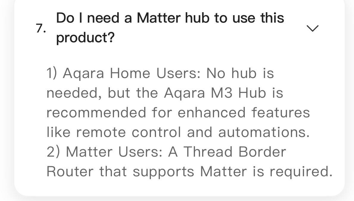

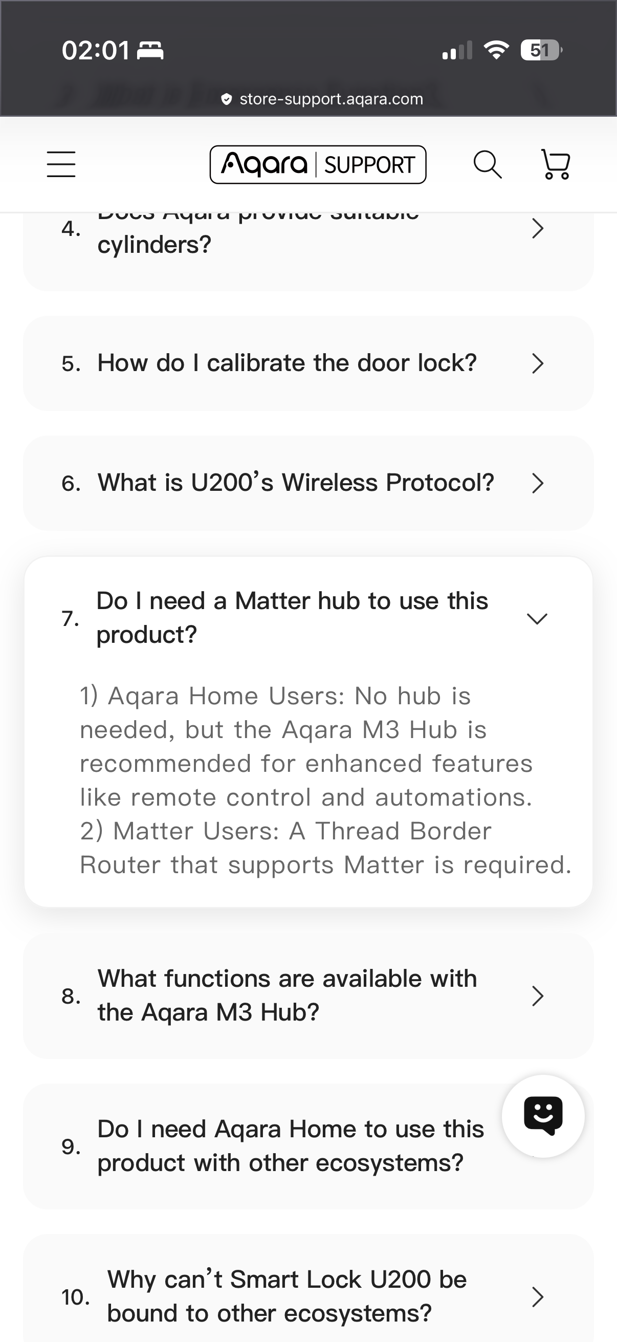

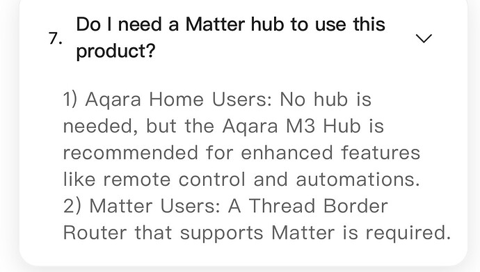

W FAQ jest też napisane, że hub Matter jest niewymagany.

You need the hub, but the lock connects to the app via bluetooth. As far as I understand the problem of the OP is that he cannot add the lock to the app, which should succeed even if he doesn’t own a hub.
Source: U200 FAQ
