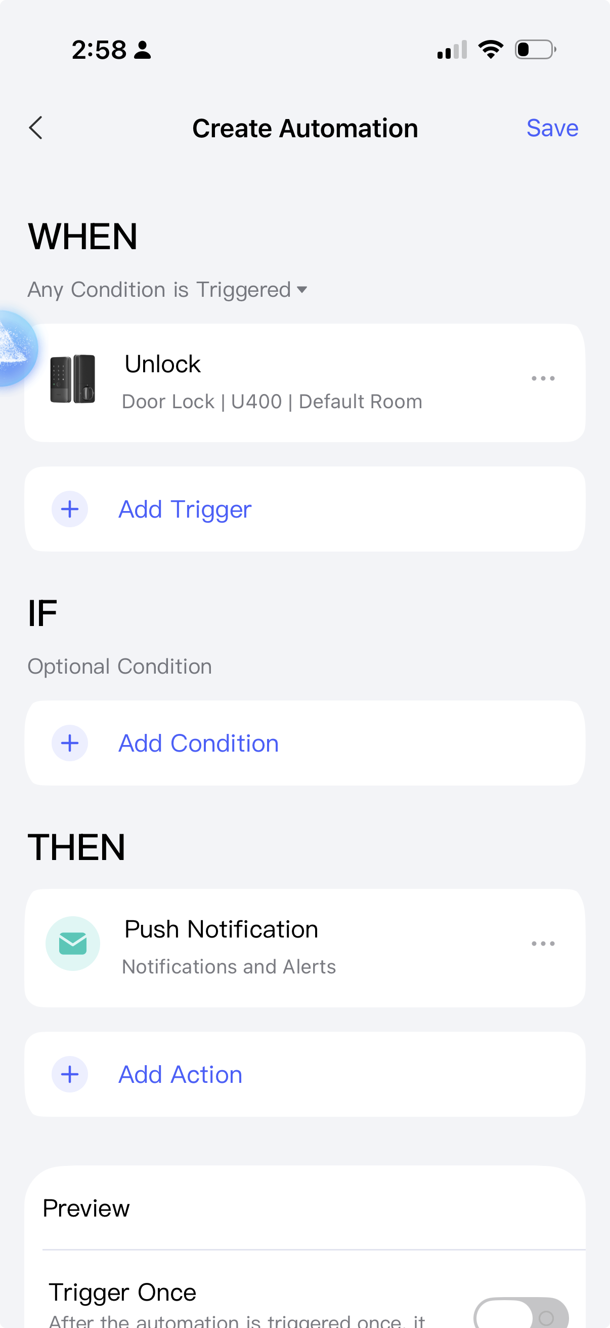

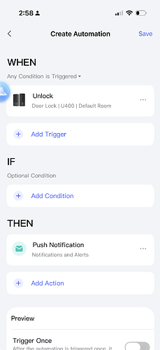

Hi @vinhnguyen1703 - With a lot of Aqara products the notifications are not built in. There are two ways to do this.
The simplest is to create your notifications under automations. When Locked → Send notification.

What’s super odd is that HomeKit accessory has the status for notifications on but no notifications are coming through. I do have the m2 hub to bridge the connection with the apple tv too. Setting up the automation did work for me within aqara though
