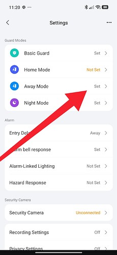

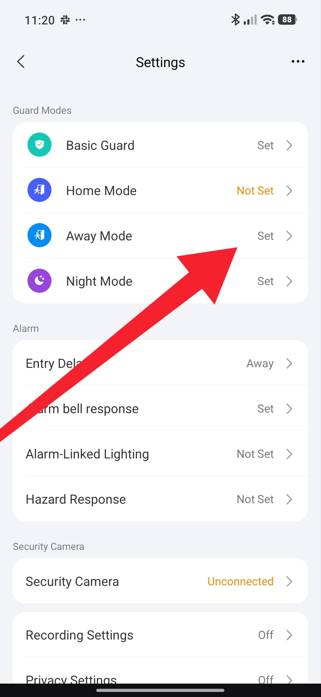

Hello, welcome to the forum.
The notification problem can be solved much easier. You need to set up the “away from home” mode signals for those notifications that you need to receive. After enabling the “away from home” mode, you will receive alarm signals when events are triggered. As soon as you disable the “away from home” mode, notifications will stop coming to you, and the camera log will continue to record all the events you selected.
You can set the On/Off period of the security using Automation 2.0.
I have considered the deployed security mode in special lessons. Lesson 1 Setting up the security system APP (adding a card with a security panel) - #2 by JohnD
If you want to make it complicated:
Otherwise, I’d recommend gafich10 suggestion :nerd_face:
