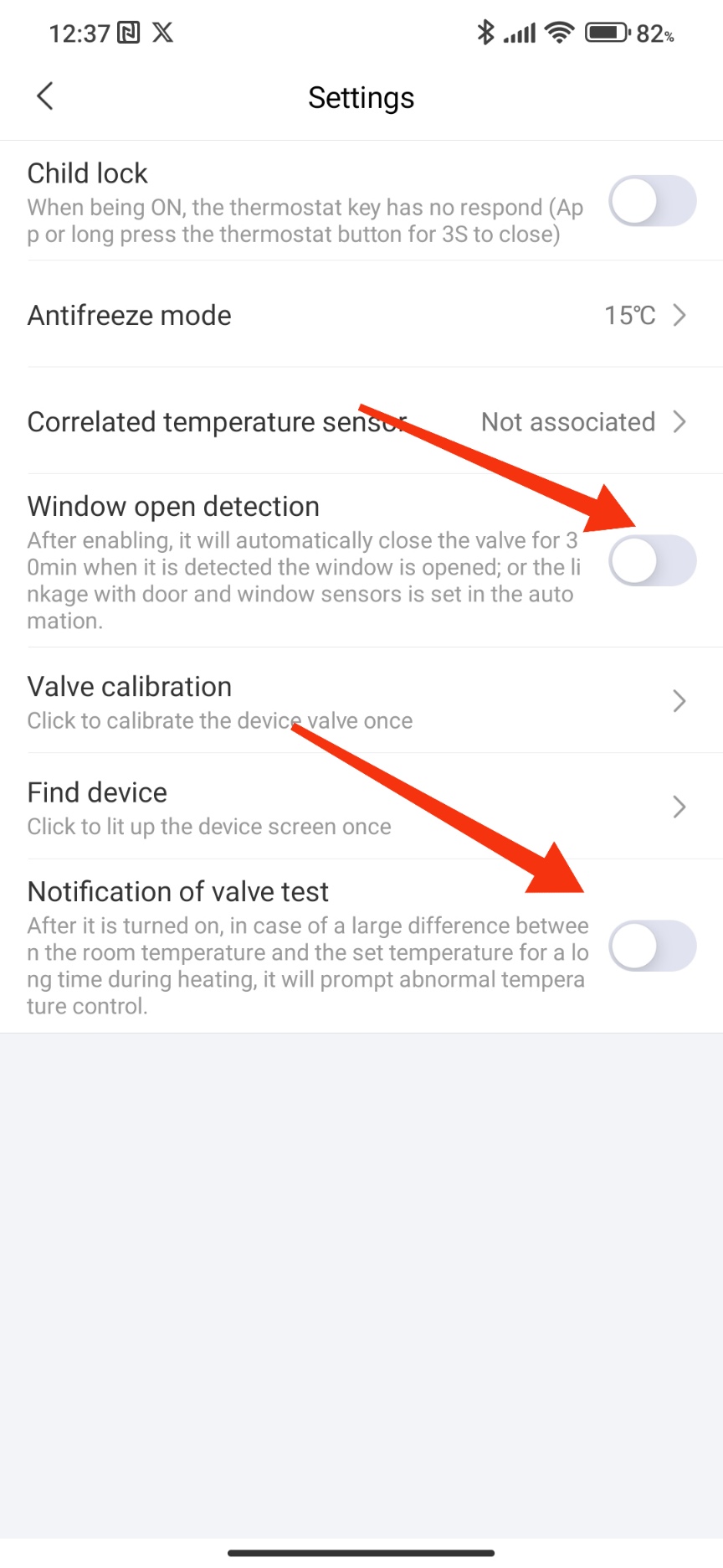

Hello, try to disable valve inspection in the settings.
Hi, welcome to the forum. First of all, turn off these settings.
