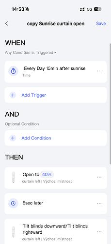

When I want to tilt blinds after close/open at specific %, automation not waiting to reach close/open position and immediately move to next step.
I have: Open to 40% → 2sec later → tilt blinds downward/Tilt blinds rightward
But when it starts opening, immediately after 2s (when is still opening) is blind tilt and automation ends.
Weird is, that preview button in automation is working correctly, but automation triggered by sunrise not.

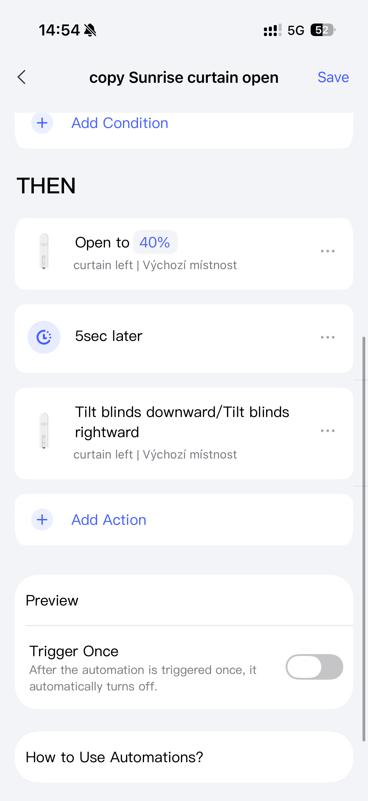

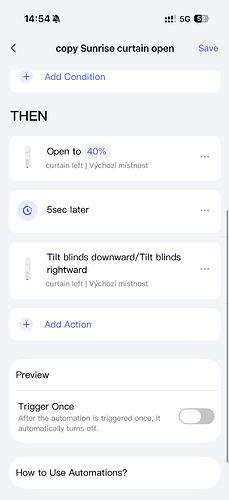

Sending screenshots from automation. I need to everytime tild blind when target position changed.

That’s not correct. When I hit Preview button, blind is opening to 40% (it takes about 15s to full open state), then it waits 5s and then is tilted.
But when Sunrise hits trigger, it starts opening to 40% and after exact 5 seconds while it’s still opening, blind is tilted and automation ends. So blind will get around 6% than is tilted and that’s all.
It looks like, that Preview button waiting to finish opening and then wait 5 second and then do tilt. That’s what I want. But when automation is triggered by Sunrise, it will not wait to finish opening state.

Problem is not about trigger point, but about different behavior between Preview button and triggered one.
When I selected automation and hit Preview button, it is working correctly, but when it’s automatically hit by triggered point (sunrise/sunset) than it has different behavior.
