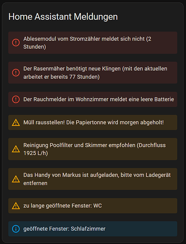

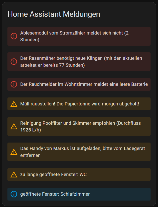

Hey everyone, I’ve been diving into optimizing my smart home dashboard lately, and I thought I’d share my journey and some insights. I love a clean dashboard, one that only shows essential information when needed. To achieve this, I’ve been using a Markdown card to display status messages. Ideally, it’s empty, but it can look like this: Status Card Example
However, as I started querying more devices, the dashboard became sluggish. It was frustrating, especially when my Android tablet would take forever to load the dashboard after detecting motion. I realized the issue was the dashboard rebuilding the page each time, querying multiple entities in the process. To tackle this, I began creating a template sensor where I could store status messages. Now, the dashboard only needs to fetch the status from a single sensor, significantly speeding things up.
But then came the learning curve—literally! I discovered that the status text was limited to 255 characters. While this works for simple messages, it’s a bit restrictive when dealing with multiple status updates. I’m curious if anyone has found alternative solutions or methods to display more information efficiently on the dashboard. Maybe there’s a smarter way to structure the data or utilize other sensors?
