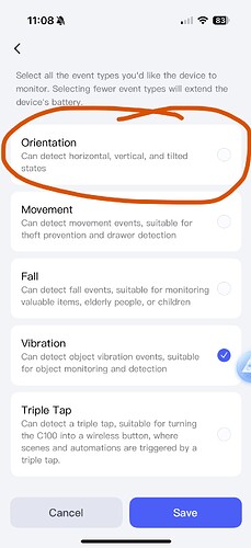

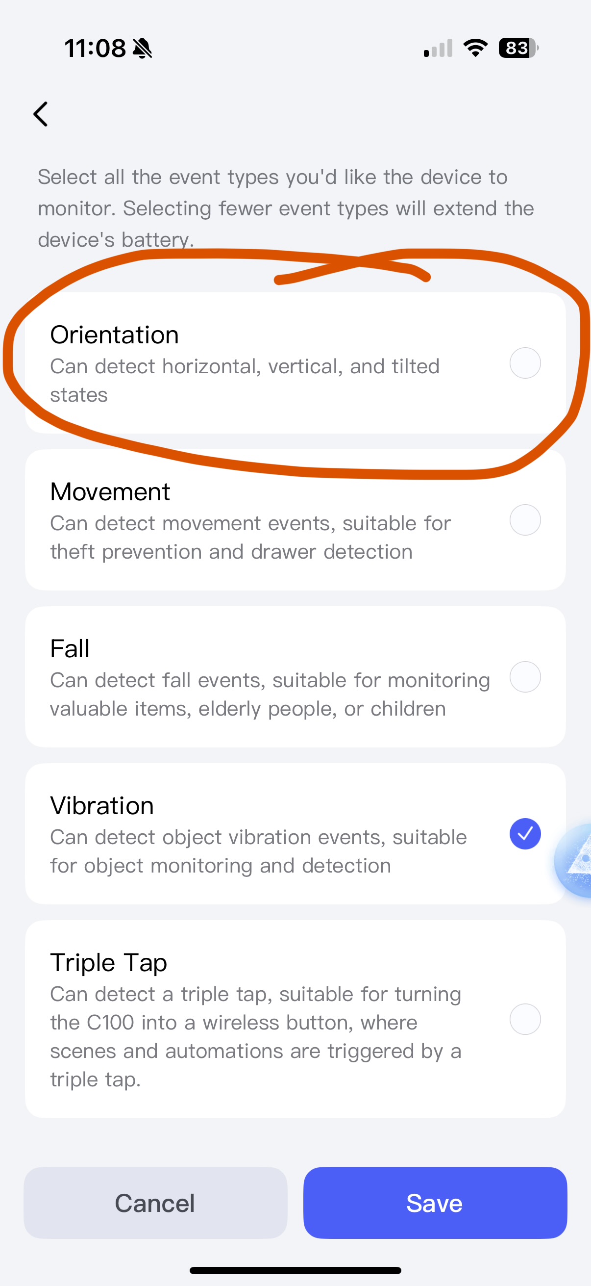

Door monitoring mode works for “hinged objects” as the description says.
For roller doors, you might use “object monitoring mode” and enable “orientation” event.
You will be able to detect if the P100 changes orientation from vertical to horizontal - it can be used to detect if the roller door is open/closed.

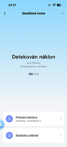

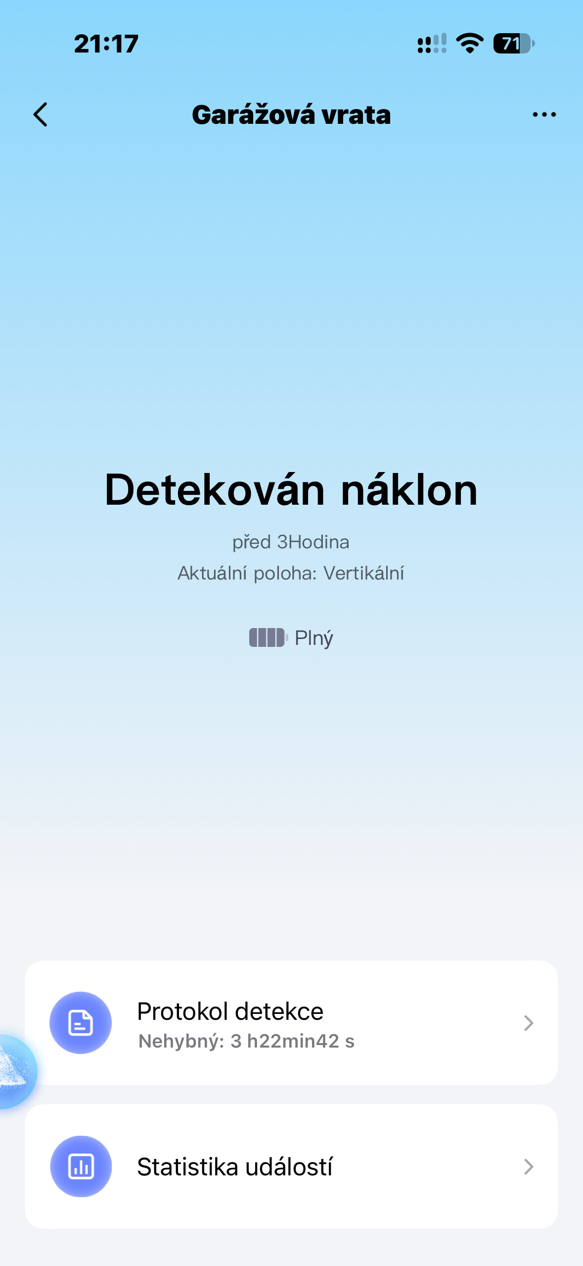

Hi, I use the P100 sensor with my electrically operated garage door.My current setup is:Object Protection enabledOrientation and Movement detection enabledOne improvement I would love to see is the option to display a garage door animation or icon instead of plain text.I also hope, or rather believe, that Aqara might surprise us in the future by releasing a dedicated garage door controller with an integrated sensor. That would be a great addition to the Aqara ecosystem.Fingers crossed for all of us!
