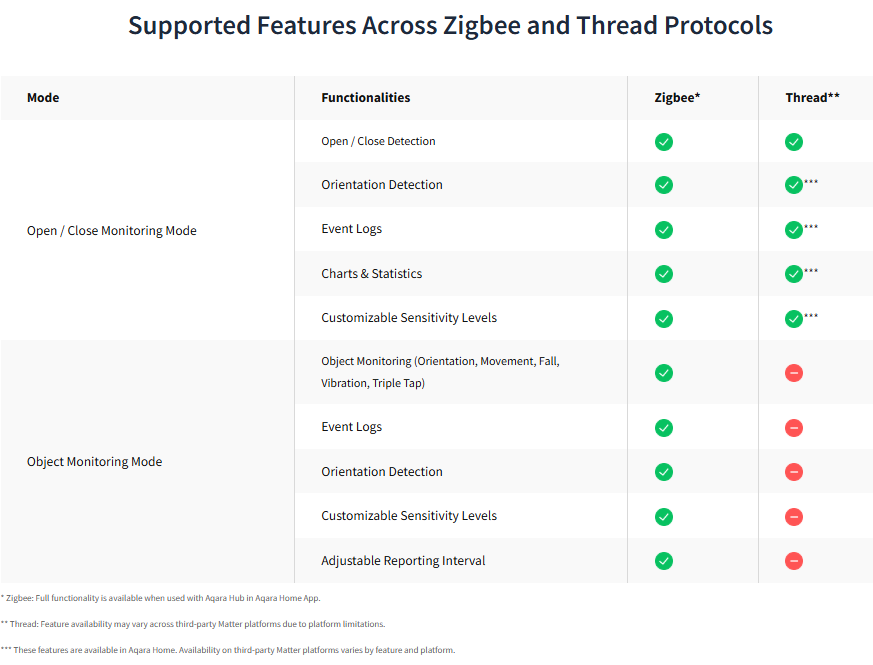

I’m afraid that in thread mode (via Matter), object monitoring (orientation, movement, fall, vibration, triple tap) won’t work.
Image Source: Aqara Multi-State Sensor P100: Detect Object/Door/Window Status
I can’t say exactly what device the P100 appears as or what functions it offers via the M3 Hub (as a Matter bridge), but I think the best way to access the vibration data is to have the P100 in Zigbee mode with a Matter signal set up via Advanced Matter Bridging.
