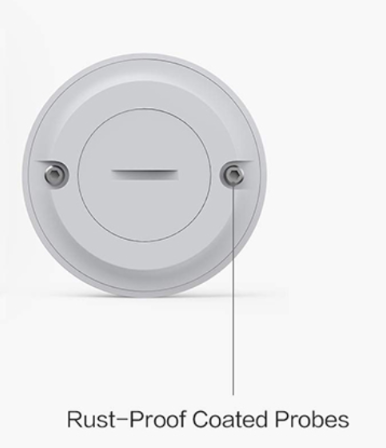

One idea though, how is the buzzer activated? Some old intercoms probably have a simple open/close circuit to activate it, you could in theory wire up an Aqara Leak sensor to it with the open/close also joining the contacts on the water leak sensor. Completing the circuit between the two points will activate the water leak sensor.
People have modded these to do all sorts of things.
