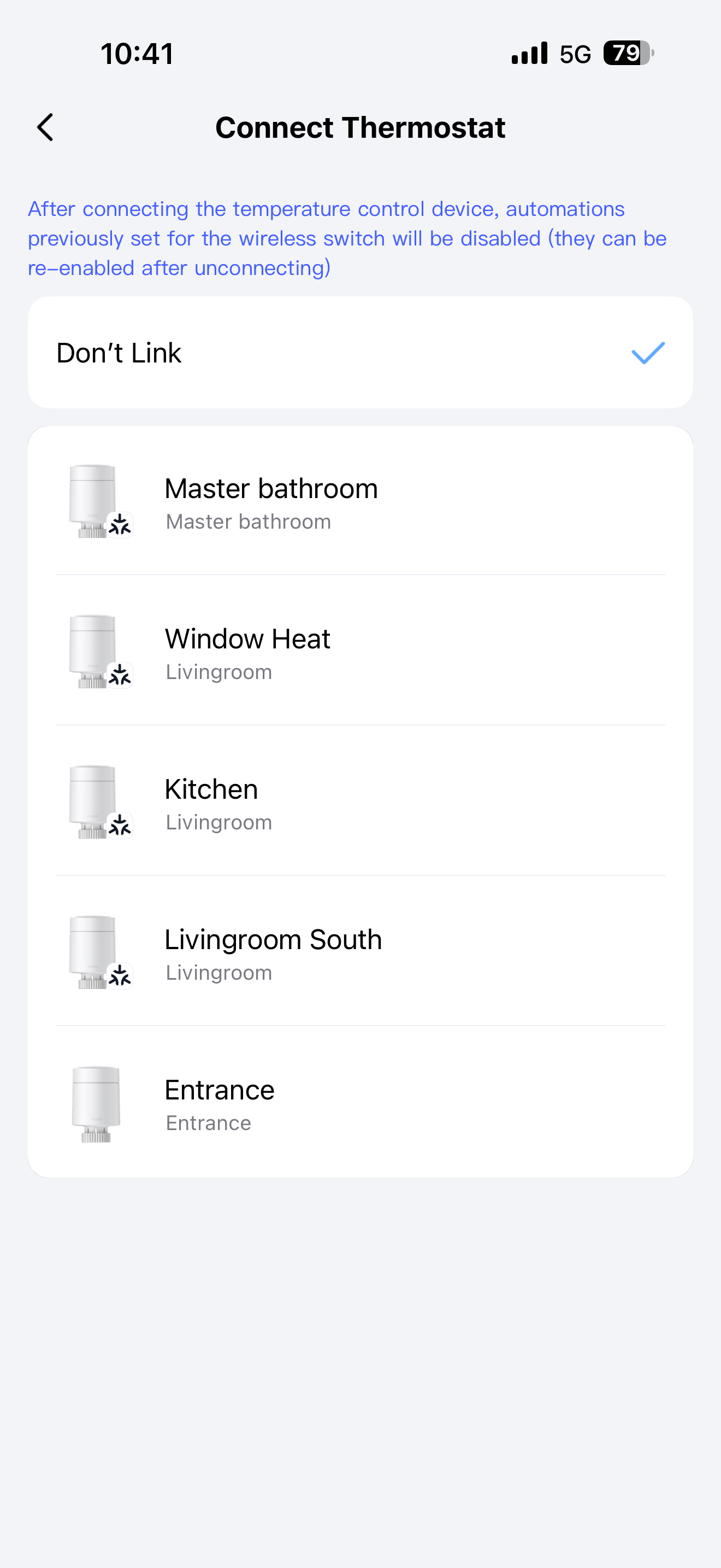

So I’m still a bit frustrated that this isn’t possible.
The way I see it thread is the superior protocol over zigbee. It meshes between all my border routers seamlessly. Hoping Aqara will allow temperature control of the w600 from a w100 over thread.
The menu is there but it unselectable.
So yesterday firmware 1.0.5.1 was released for the w100 thread protocol.
The update now allows for selection of w100 as a temperature source for the w600 in matter over thread mode. Allows to be selected is the key word. Because it seems the w600 is still not using the input to regulate. Anyone else tried it yet?
