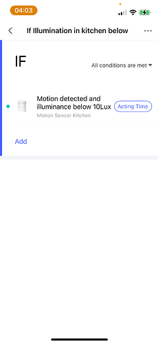

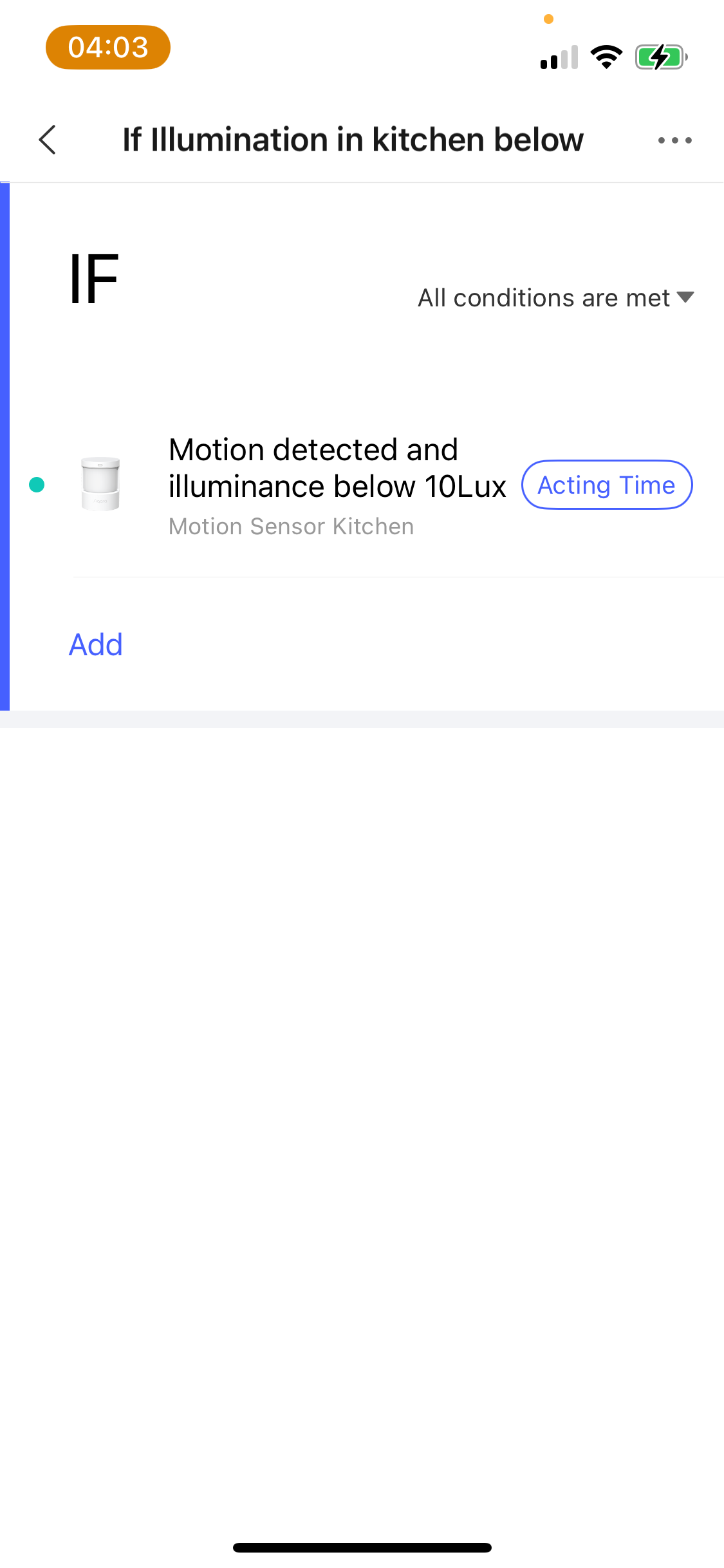

What you have achieved through the Eve app, I have achieved it using the signals sync function in the Aqara app over matter. My Aqara is also enabled in Home assistant. In turn, my home assistant entities are enabled in HomeKit through the HomeKit Bridge for Home Assistant.
In the Aqara app, I have created a signal which is an If statement and synced over matter.
It is a workaround as it only works if you set a certain lux value. Homekit sees it as an Occupancy sensor. Basically a binary (true / false) statement that you can configure if occupied (if motion detected and lux value is below 10), then…
Big disadvantage of this workaround is that it is pretty slow in reacting.

In the Aqara app you can create signals that use the features of the Aqara app and sync them over matter to another platform/hub.
in the Aqara app, go to Profile>Connect to Ecosystems>Matter (or any other platform you may have except HomKit)>Scene and Signal Sync.
Here you can create signals that you then sync over Matter. For this to work, your Aqara hub needs to be linked over matter to another platform. In my case that is Home Assistant but it may well be that you can also link your Hub over matter in HomeKit instead of natively through HomeKit. I haven’t tested that but it would definitely improve the performance because in my case I have Home Assistant in between.
Once you have synced your signals your other platform will the see the synced signals as occupancy sensors (true/false).
This workaround can be really useful if you want to bring the automation/scene features from the Aqara app to another platform. For example, I have the Aqara Cube Pro. using this sync feature I can use the rotate, shake and push features from the aqara app and apply them in Home Assistant. The same can be done for bringing over certain illumination lux values.
