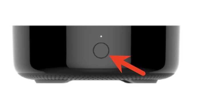

– At this point, you can try another method to join the network: quickly press the button on the hub three times. The hub will then provide a voice prompt and automatically search for devices to join the network and connect them.
– This method allows only one T1M to join the network at a time.
– After you power off and then power on again, the remaining lights that have not yet joined the network will start breathing again. Repeat the above steps until all lights have successfully joined the hub.
– Before performing this operation, please ensure that the hub is connected properly and place it as close to the lights as possible.

Thank you Arnold K and Naomi I applied the firmware update and followed Arnold’s instructions (fast press the M2 button 3 times; repeating for each T1M) and it worked perfectly.
