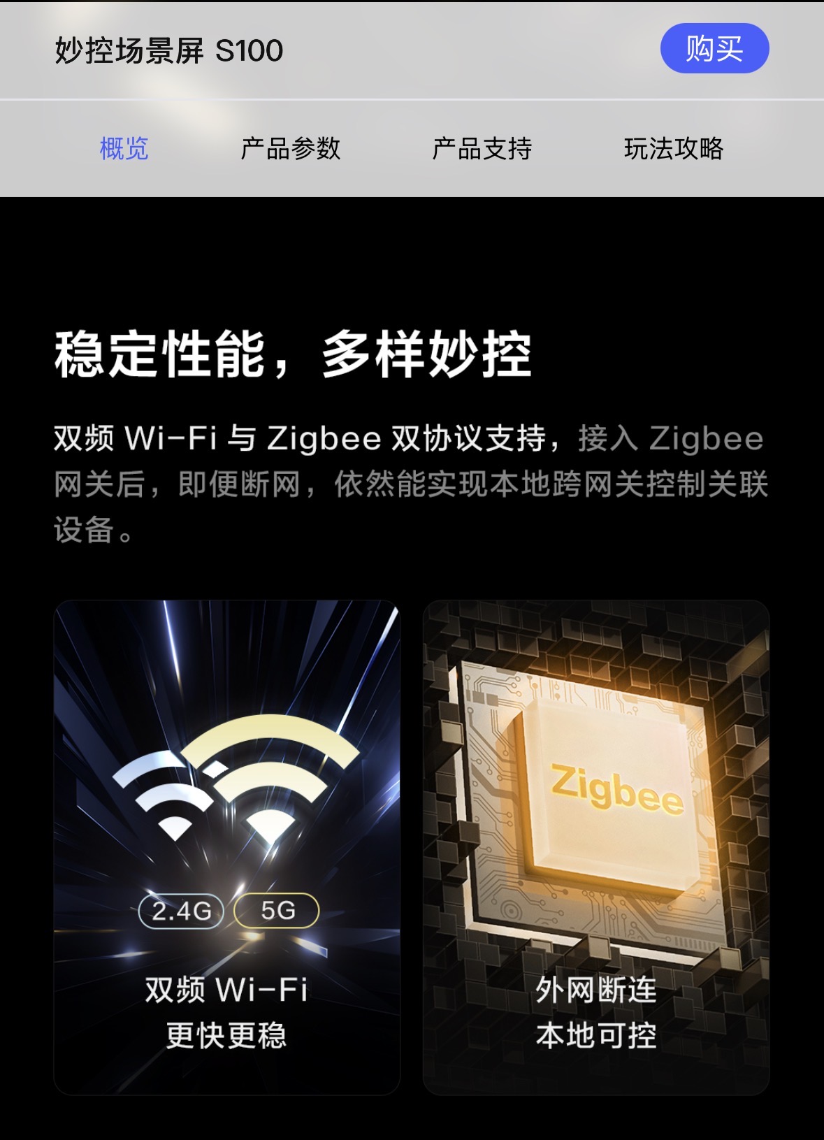

Actually, the S100 DOES NOT have zigbee. I need to connect to a hub to control zigbee devices. And in the settings of the S100 via the Aqara App, there is a “Hub” setting which allows the S100 to bind to a hub. Very little information of what that setting does is available.
I understand the S100/S1E are wifi devices which by themselves will not need a hub to function.
S100 has Zigbee, not for connecting the panel itself, but for controlling devices if the main hub fails. You can read about it at the link below.
I see. So if i understand you correctly, when the S100 is set to the M3 Hub, and if internet goes does, I can still control Zigbee devices bound to the M3 Hub if internet or wifi goes down, right? Will try this when I have a chance.
That seems to only work with the M3 Hub on my home and not the G410 doorbell hub…
