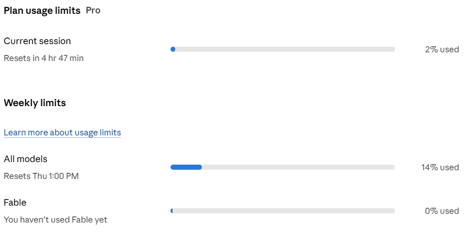

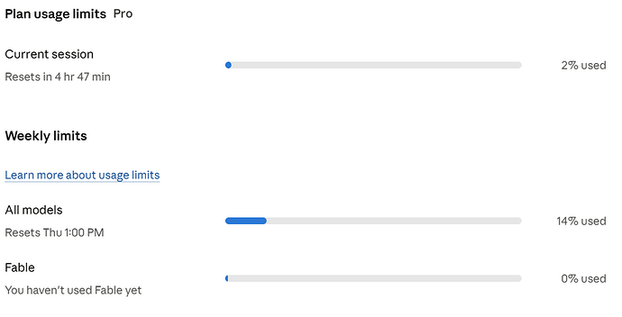

Great questions. Question 2 is much easier to answer then question 2, so I’ll start w that.
Q1 - “What did this experiment cost you in terms of API usage”: I am on the standard “Pro” plan w Claude which physically costs me $20/month and I have used 14% of my weekly limit.

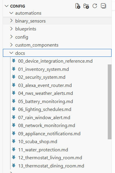

Here is an example of how I have my technical docs arranged in HA

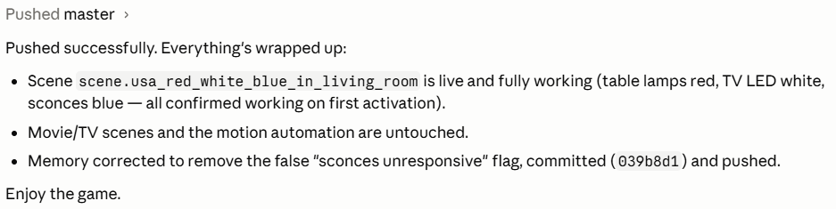

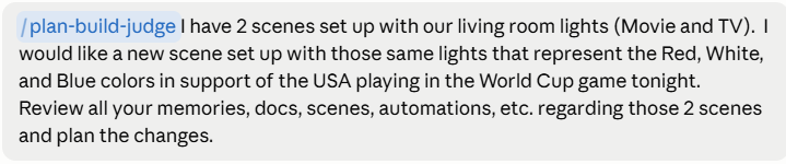

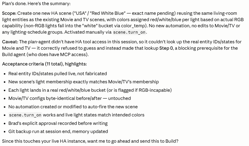

So I decided to knock out a couple items at once. There is a forum post titled “Share Smart Match Day Setup…” where you can share your automations, light scenes, etc. and I wanted to try a new scene creation just by tell Claude what I wanted (as you asked). Claude was able to easily knock out this new scene for me in about 5 minutes. Here was my prompt to the P/B/J agents.
Here was the response:
Finished scene:
