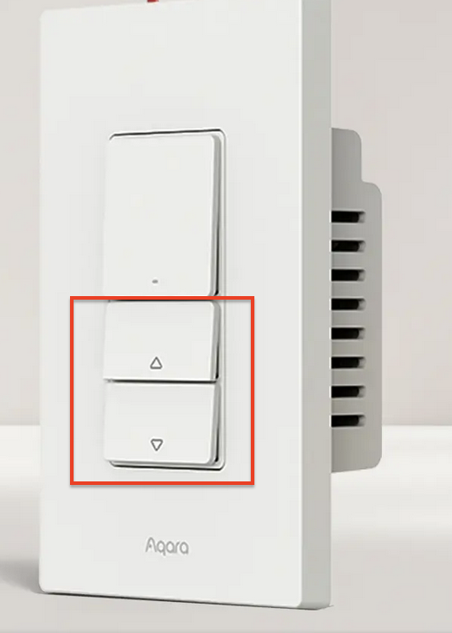

I would like to use these 3 things together to control the main light, and the two up/down buttons to control the matter enabled blinds in the room. Basically decouple them. When I try to add the switch to Aqara App, either as Zigbee or matter, it asks me for an Aqara Hub to add the device to the app.
Please see attached screenshot of the buttons I want to control and decouple from the main light switch. Is it even possible? What do I need? I prefer to avoid buying Aqara hub.

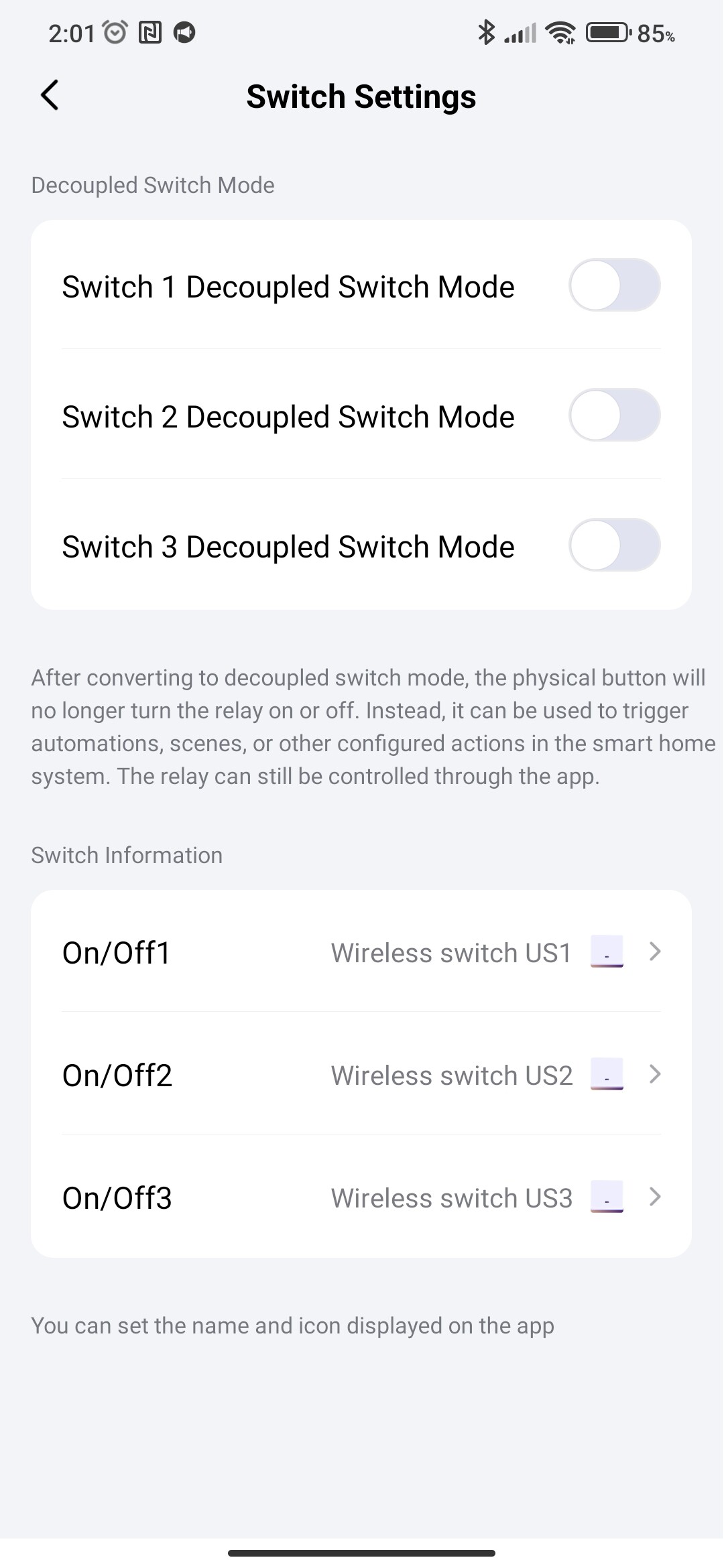

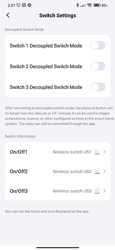

Hi man, decoupled switch mode is Aqara Home-exclusive feature for now, currently you can not expect to decouple without an Aqara hub and it’s just not available outside of Aqara system.

Hi, you will still have to use the Aqara gateway to access these settings. Alex doesn’t offer you this setting?

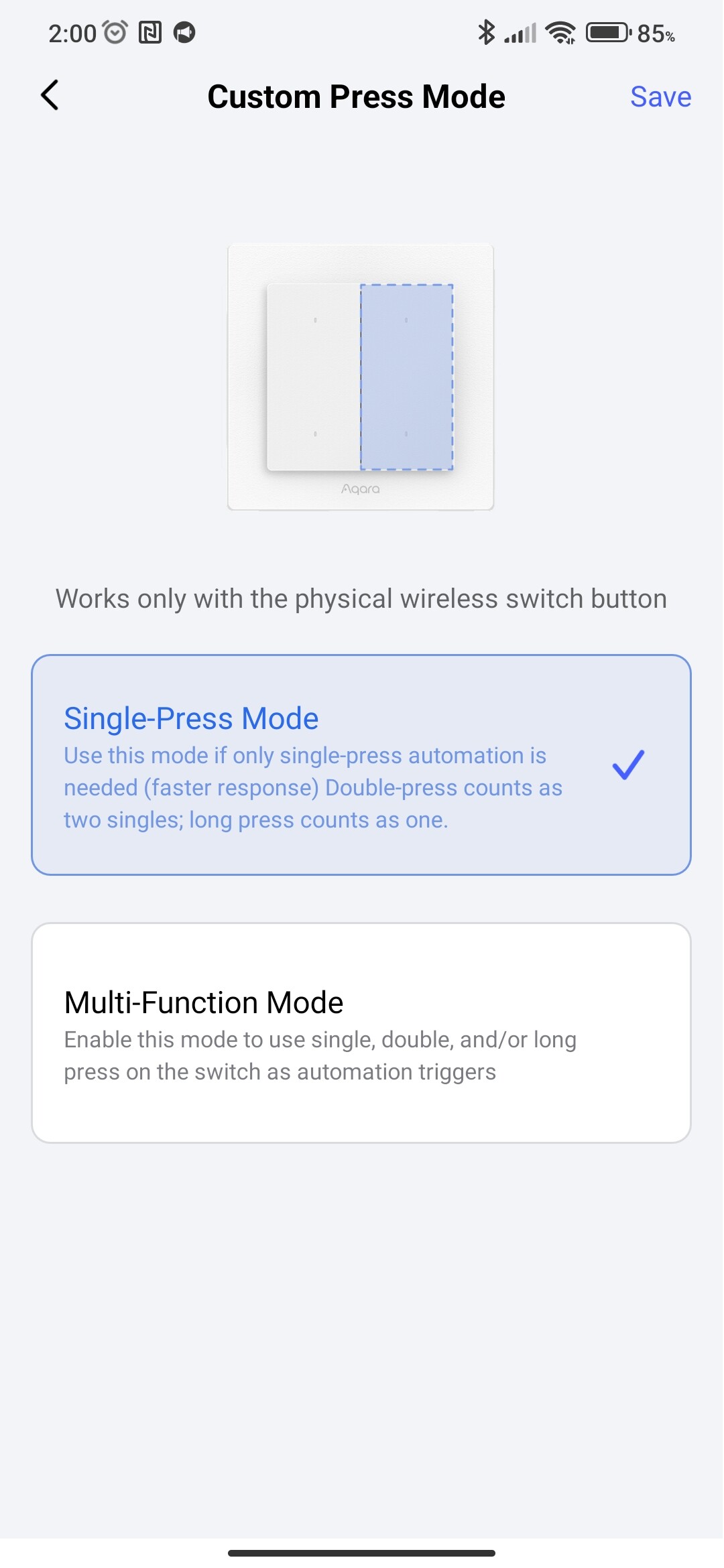

Just for information, Aqara 2.0 automation offers actions with buttons without switching them to wireless mode. Everything works, maybe you will have this function open.
I don’t see any of these settings. In Alexa when I added the device via matter to Alexa.
