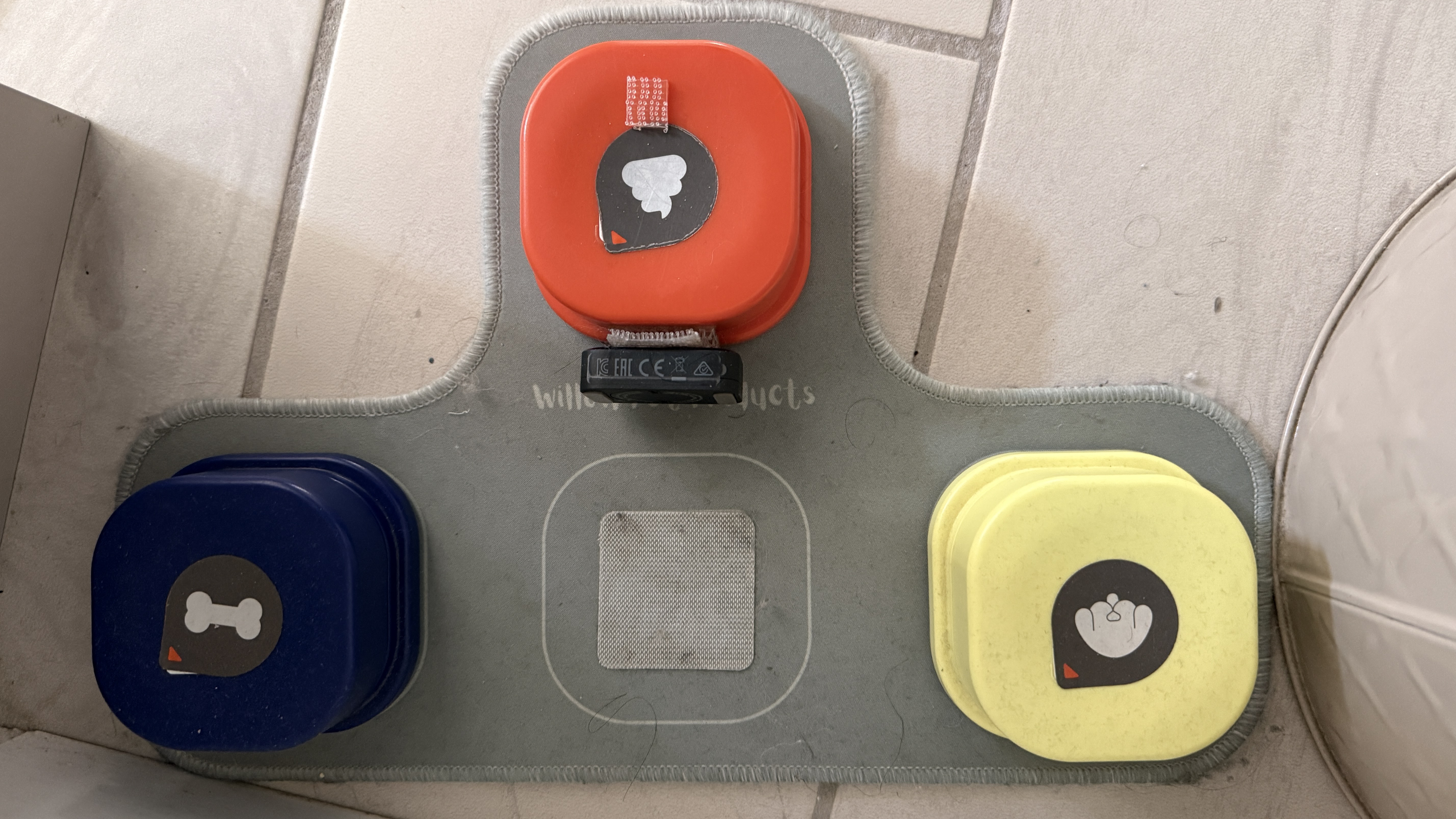

The way I am using the P100 sensor is attached to buttons that we taught our Aussiedoodle to press when he either needs to go potty, wants to play or wants food.
Our concern was knowing when he needed go potty, especially when we were NOT home.
Kennel is not an option as he roams freely around the house.

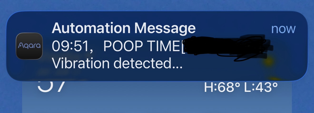

I wanted something to notify us via our phones, when he needed to go outside and potty.

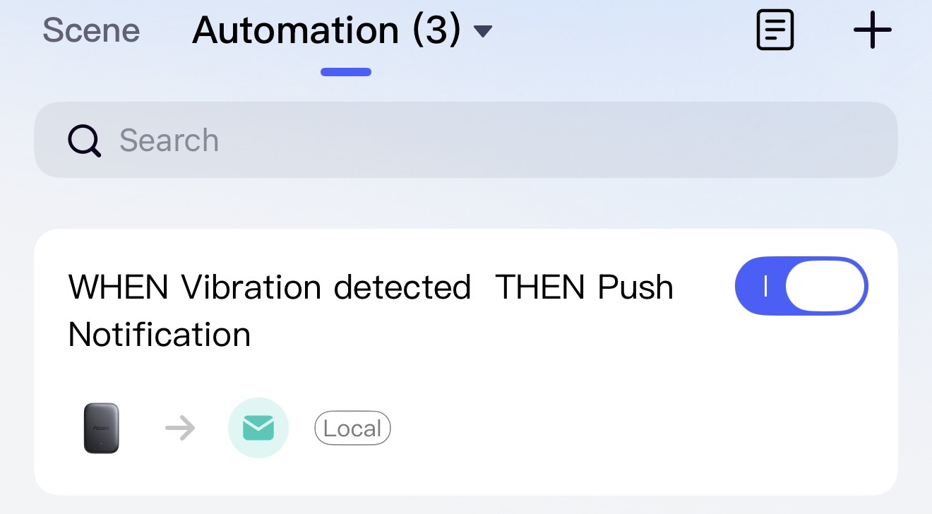

I am an Apple Home user and due to some limitations, bringing this device to Apple home is not possible.
So I set up the automation to notify me in the Aqara app.
So far this has worked well. Just wishes it would be more seamless in the Apple Home App.
Including photos of the buttons our dog uses and the automation.

Here is a video of my dog pressing the button. I am also including the notification that comes through.
