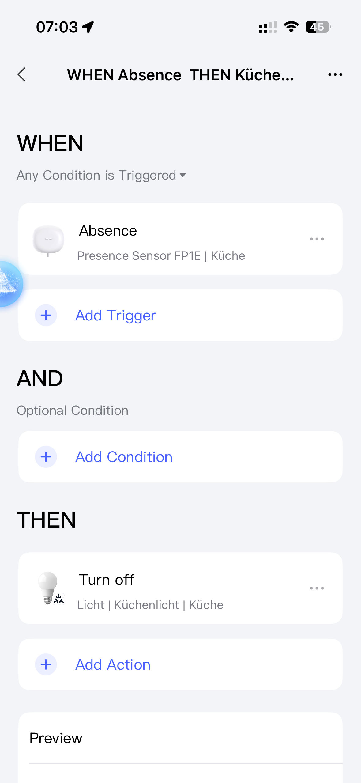

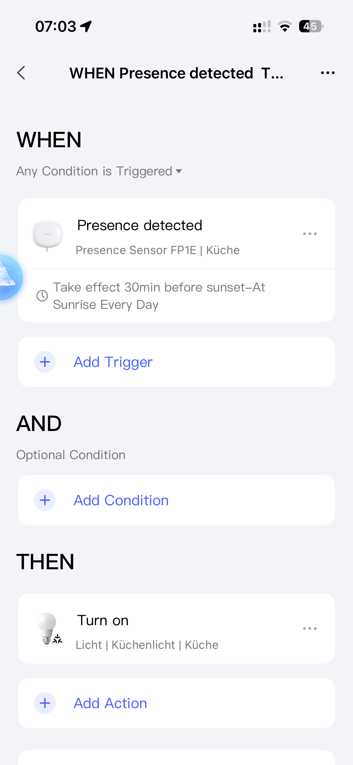

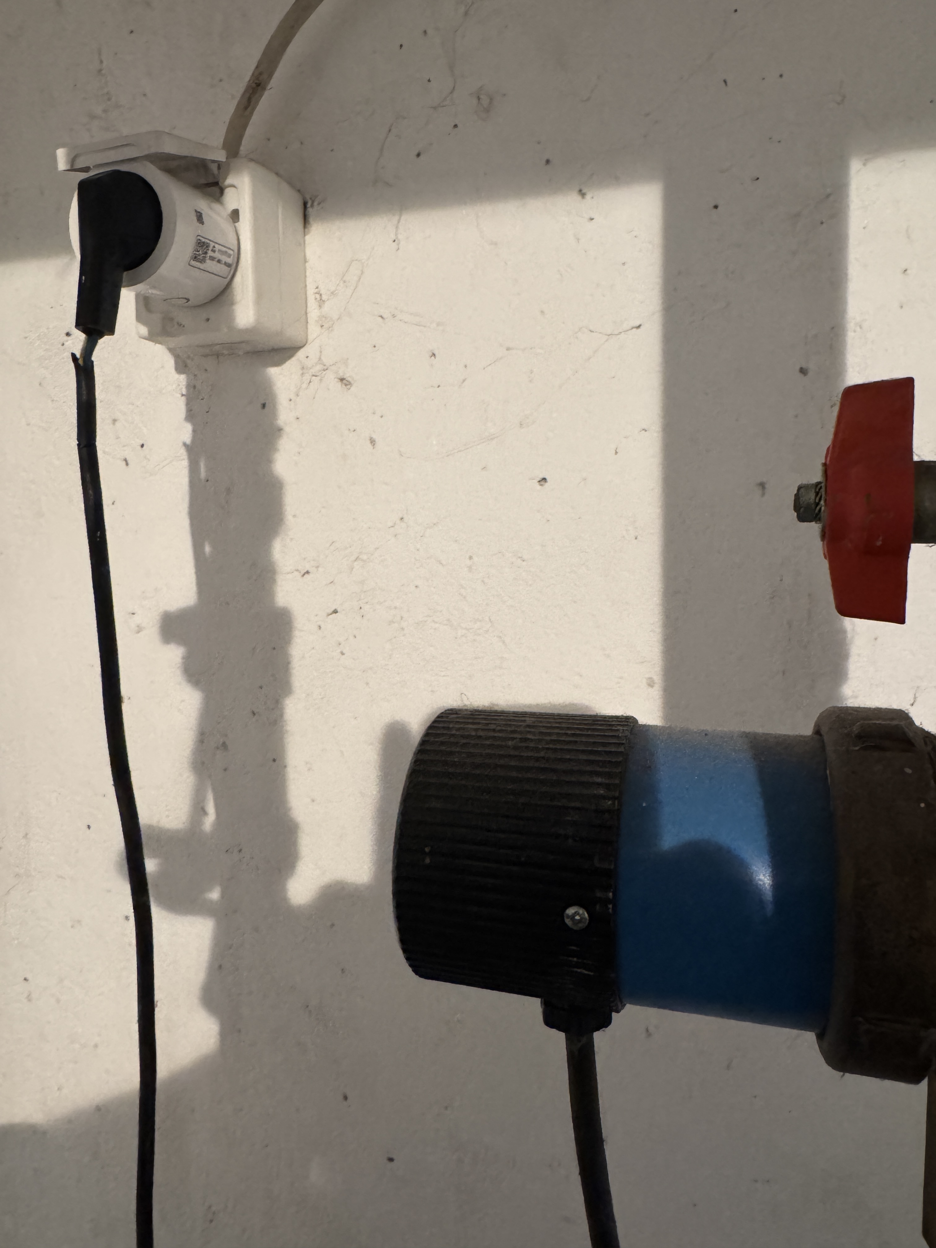

So I created a new and easy automation for my warm water circulation pump- before it was just working with an old plug with a timer.
Now I use the the H2 power plug in combination with two presence sensors- one in my kitchen and the other in my bathroom.
The pump turns on by presence and turns off by absence. Easy and effective - just :x2fozabcpx9xrbxmdpseb3_61:

It’s actually hilarious when you think about it. Recently, a user from a Type E country (likely Belgium or France) was complaining about being forced to use the plug upside down because of the grounding pin. And here you are, with a German Type F socket and all the freedom in the world, choosing to plug it in exactly the way that drove the other guy crazy!

I totally understand and got your concern! So you can make an additional automation- if there’s no movement for a specific time , the pump works for a specific time to move the water in the pipes
Of course there are always things you need to watch out in your habits and needs
