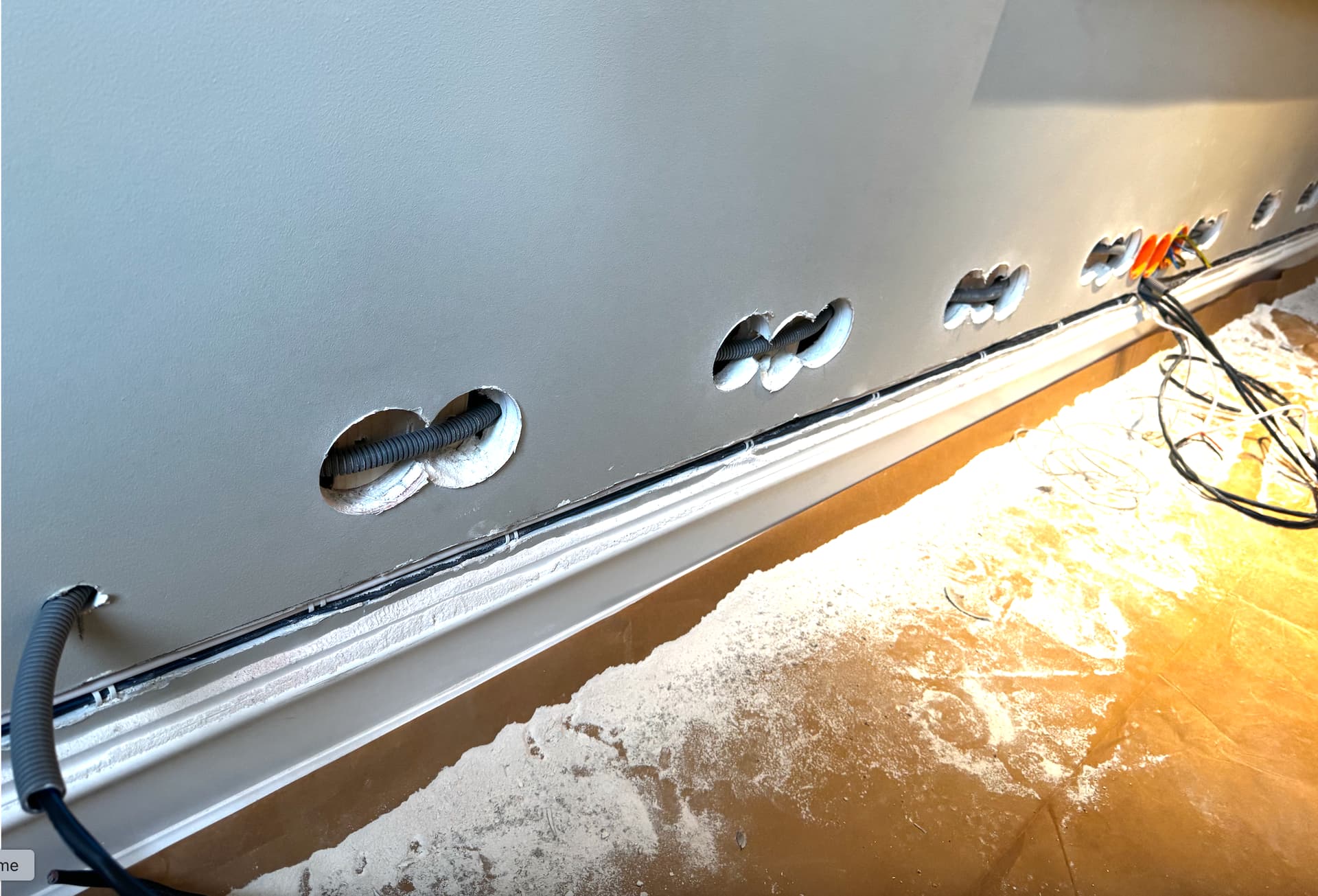

Have experience with two types of options here. At least where I live Power should be run trough separate 16mm tubes, and that makes it easier to replace cables when they get worn & torn, but a quite expensive path. But if you plan to live there for long it is the “right way”.
Slightly cheaper is to just slice out part of the moulding/plaster, put in the cable, and then plaster, sparkle and paint on top of it.
