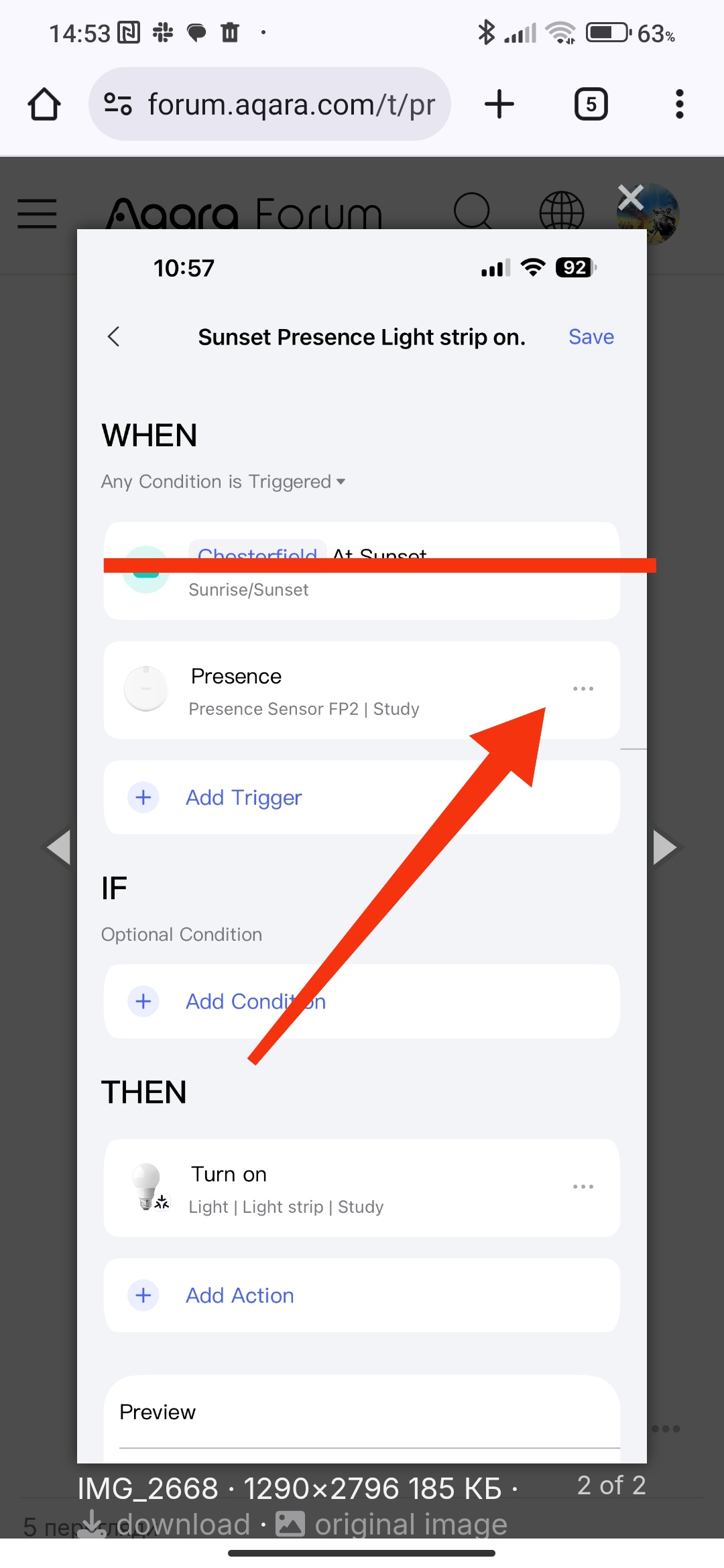

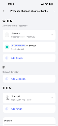

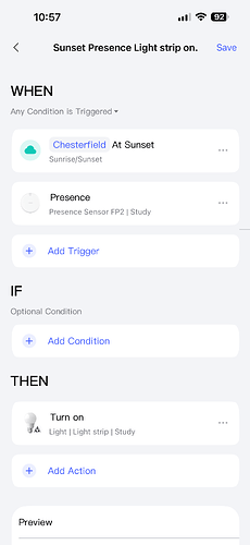

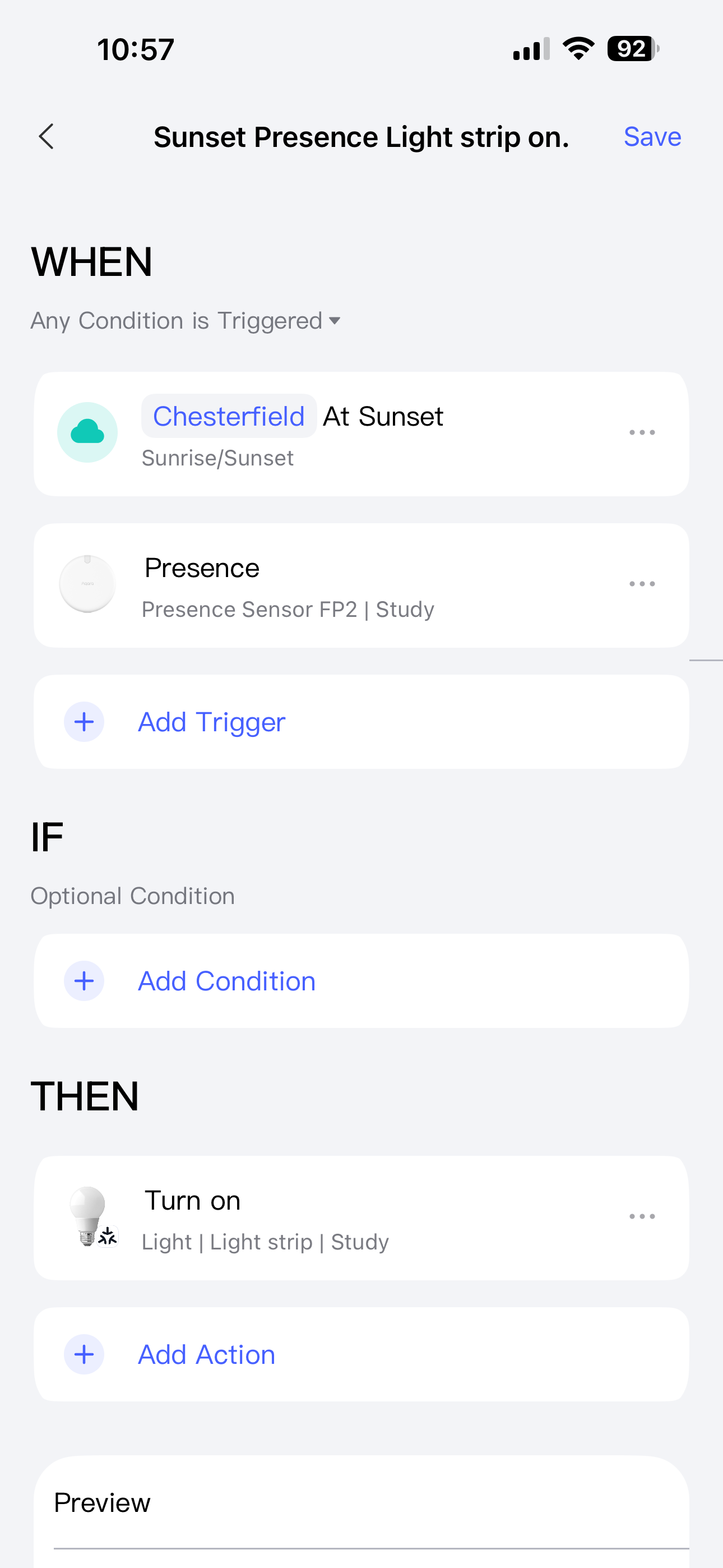

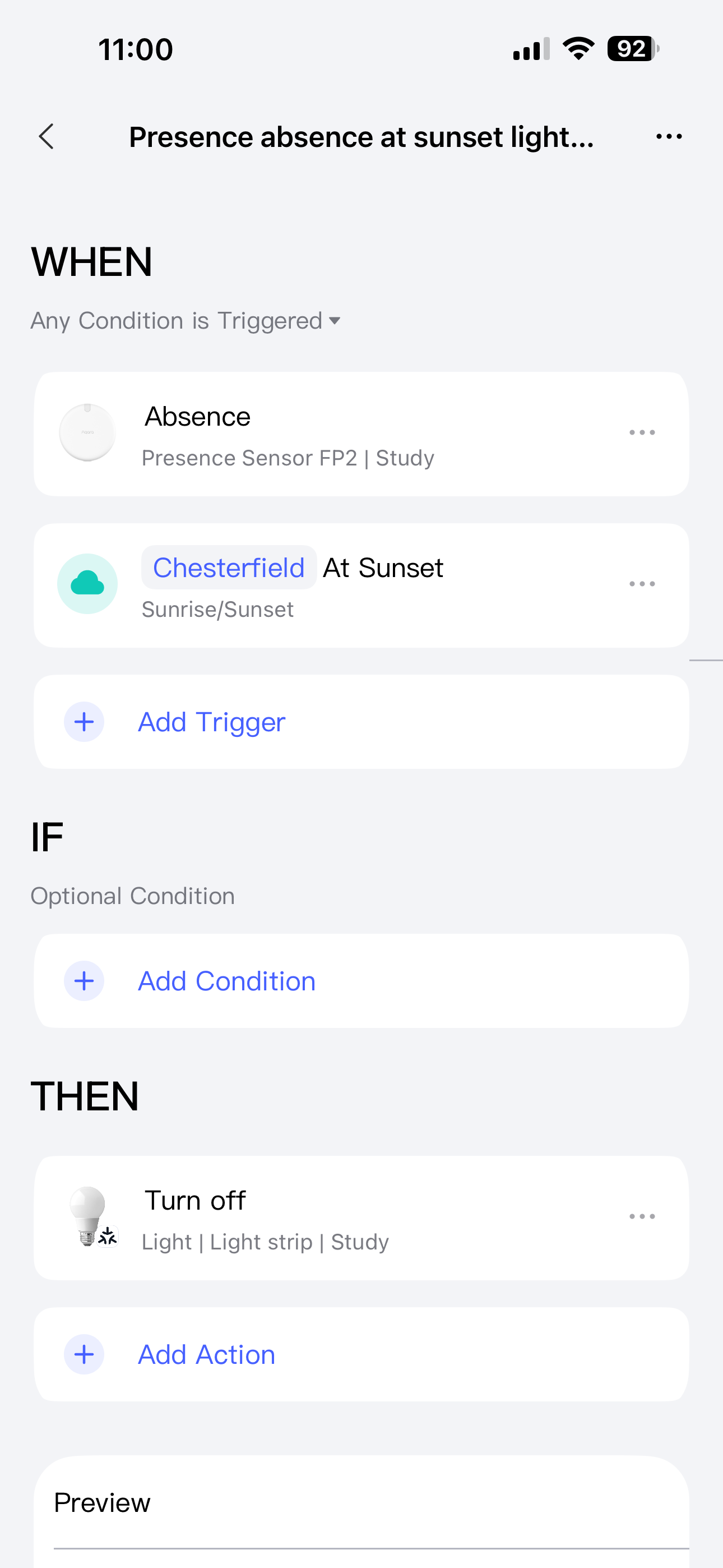

I’ve set up an automation so when walk into the Study at night the Sensor FP2 turns on a light strip and stays on until I leave. Unfortunately the sensor triggers the light come on in the daytime when it’s not needed and I can’t work out why this is happening hopefully you guys can help.
I’ve screenshot the automation for turning on the light strip and off, and perhaps you can tell me where I’ve gone wrong

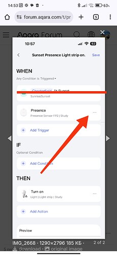

Hello, the answer is very simple. It is in the “…” settings. Read my lesson 2 and you will understand everything, you will even smile to yourself “how easy it is”. Have a nice day. Automation 2.0. Lesson2. Advanced settings "..." (Execution time, delay of conditions, reversal of conditions) is
By the way, do not use these settings to turn off the lamp, because it should turn off in any case when there is no one in the room.
Thank you for your help, I will delete the “off” automation. Also read your posts.
