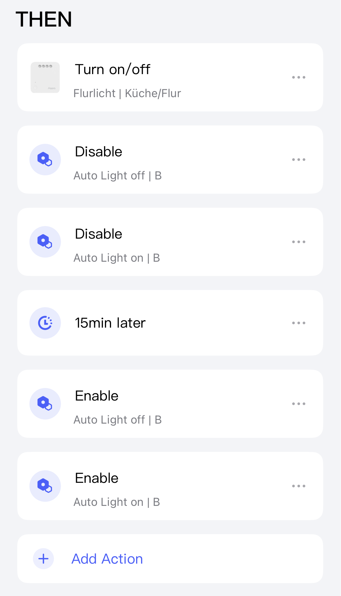

Great tip! I usually just let my switch automation disable the motion sensor one, add a delay of like 15 minutes, and then re-enable it automatically afterwards.
