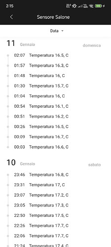

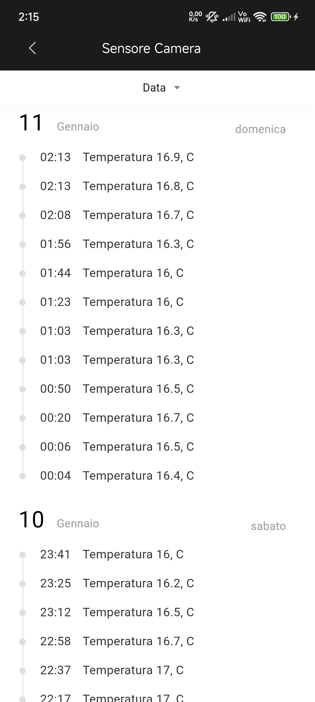

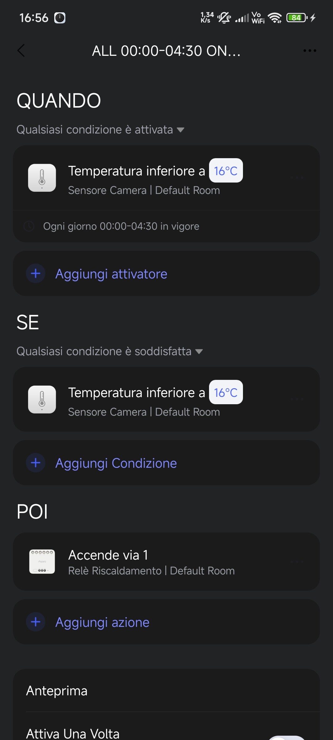

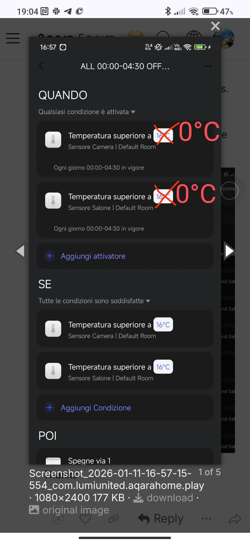

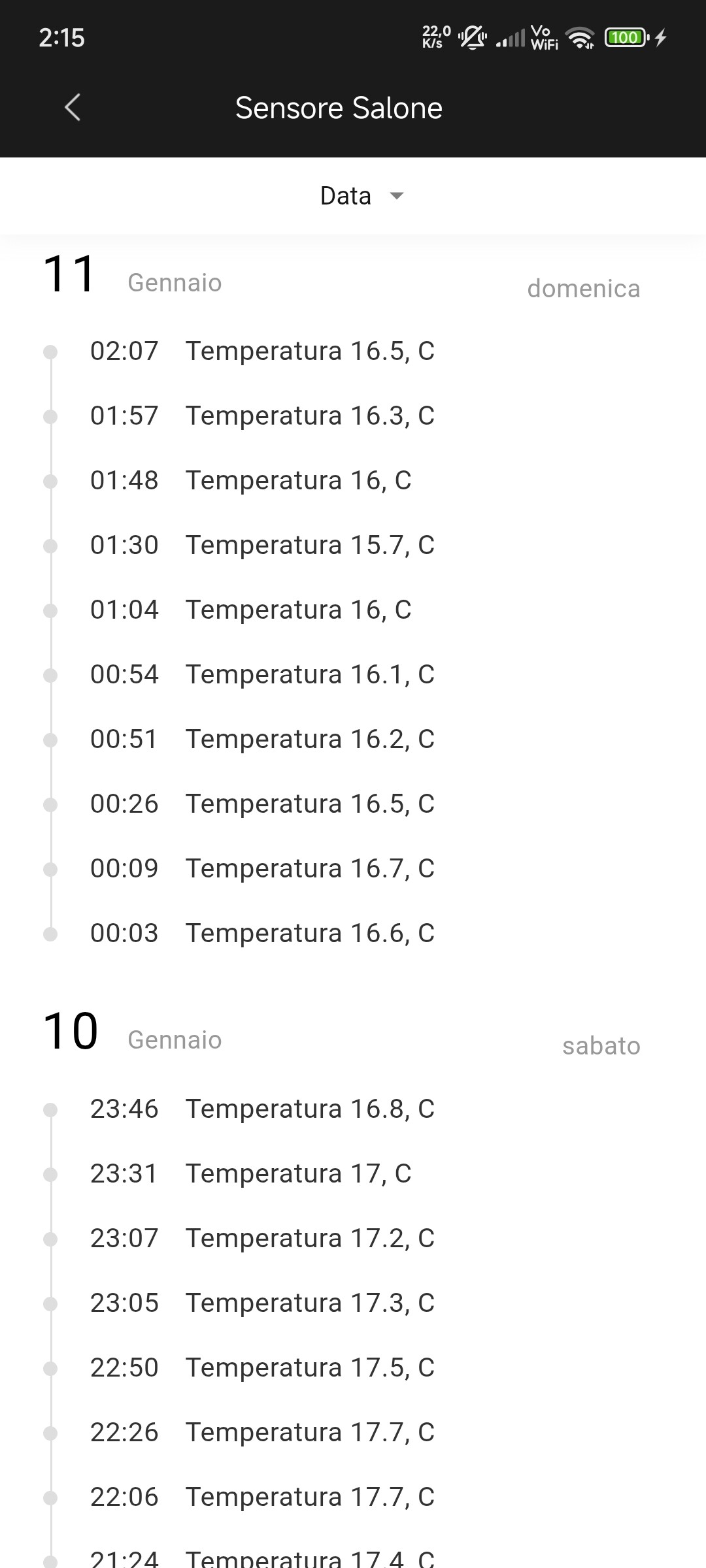

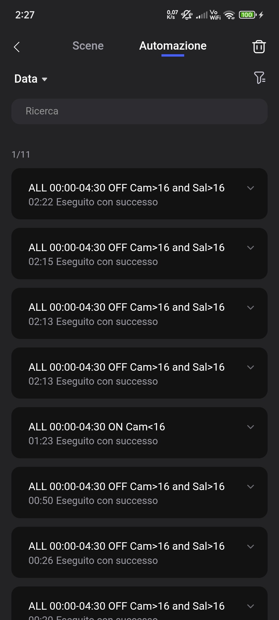

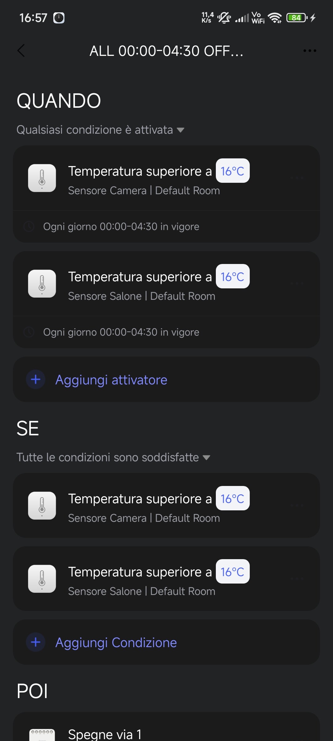

Good morning, I have an M2 hub with a T2 relay that controls the heating via output 1. The relay is turned on and off based on conditions triggered by two temperature sensors. Last night, despite having been updated several times, the shutdown automation did not start, and there are no automations (ON/OFF) in the time slot in which the two sensors were updated. I’m attaching the data from the two sensors, the automation list, and the on/off automation settings. Thanks to anyone who can help. ALL automation is local. Time problem is from 01.23 to 02.13 when I pressed the refresh button on the camera sensor

Hi, make this substitution and you will have no problems. Explanation, this condition in WHEN will constantly poll IF for conditions.
Thanks for the suggestion, it seems very strange to me because it’s worked so far. Thanks, I’ll try.
In this lesson I described the work of 2.0. Don’t be lazy to read, then you will understand everything. The WHEN section is a trigger, the IF section is a condition (constant).
