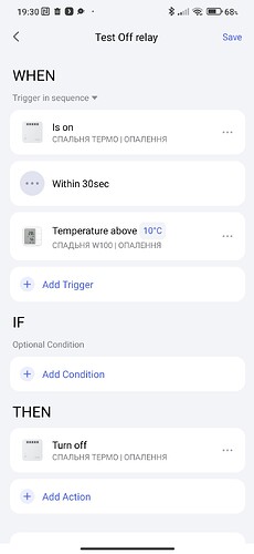

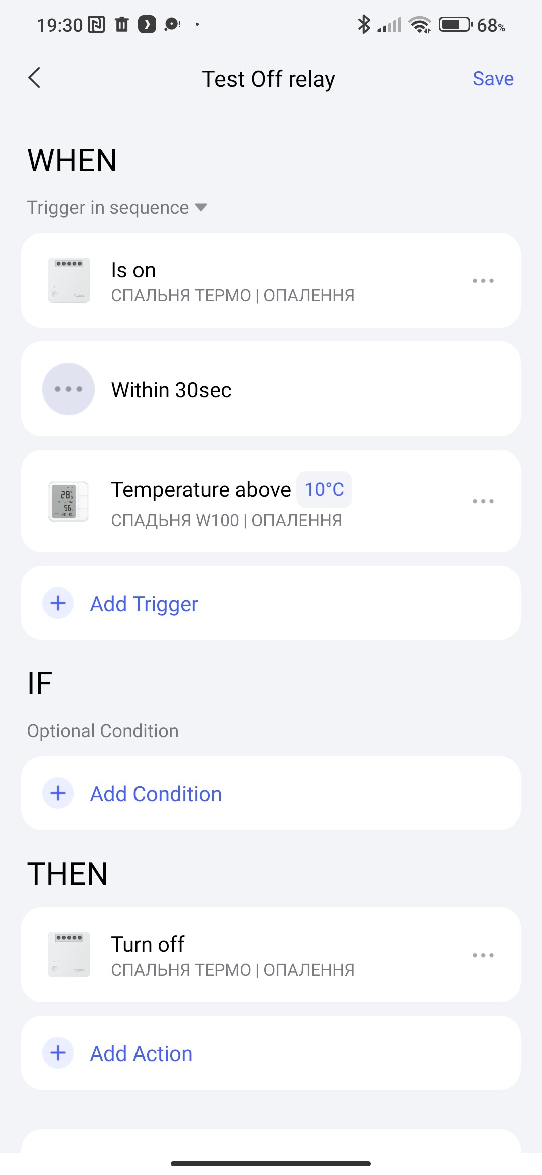

Found a problem of inconsistency of automation triggering “execute sequence”.
The essence of automation, IF the relay is on and the temperature in the room is above the set point (temperature state (°°) is selected, not an instant event) THEN turn off the relay.
Automation DOES NOT WORK! Automation will work only at the time of data transfer of my W100 (selected period 10 minutes).
