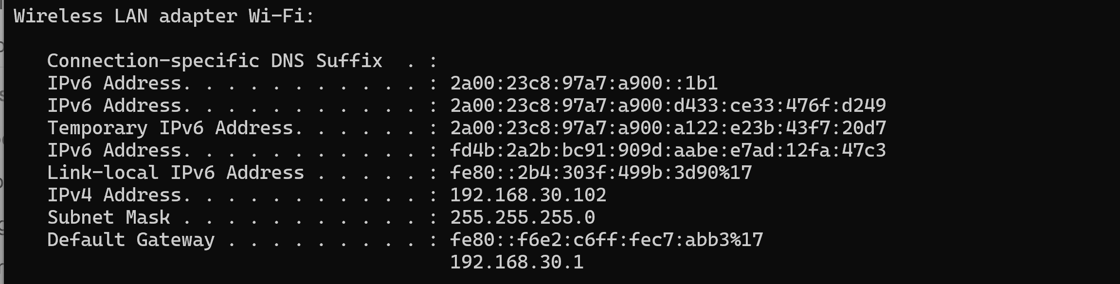

all devices are on there own iot lan, all fire wall rules have been disabled my router is a ubiquity UDM pro and ipv6 is enabled and my laptop gets a v6 ip address.
the hub however has an ipv4 address, does it need an ipv6?
