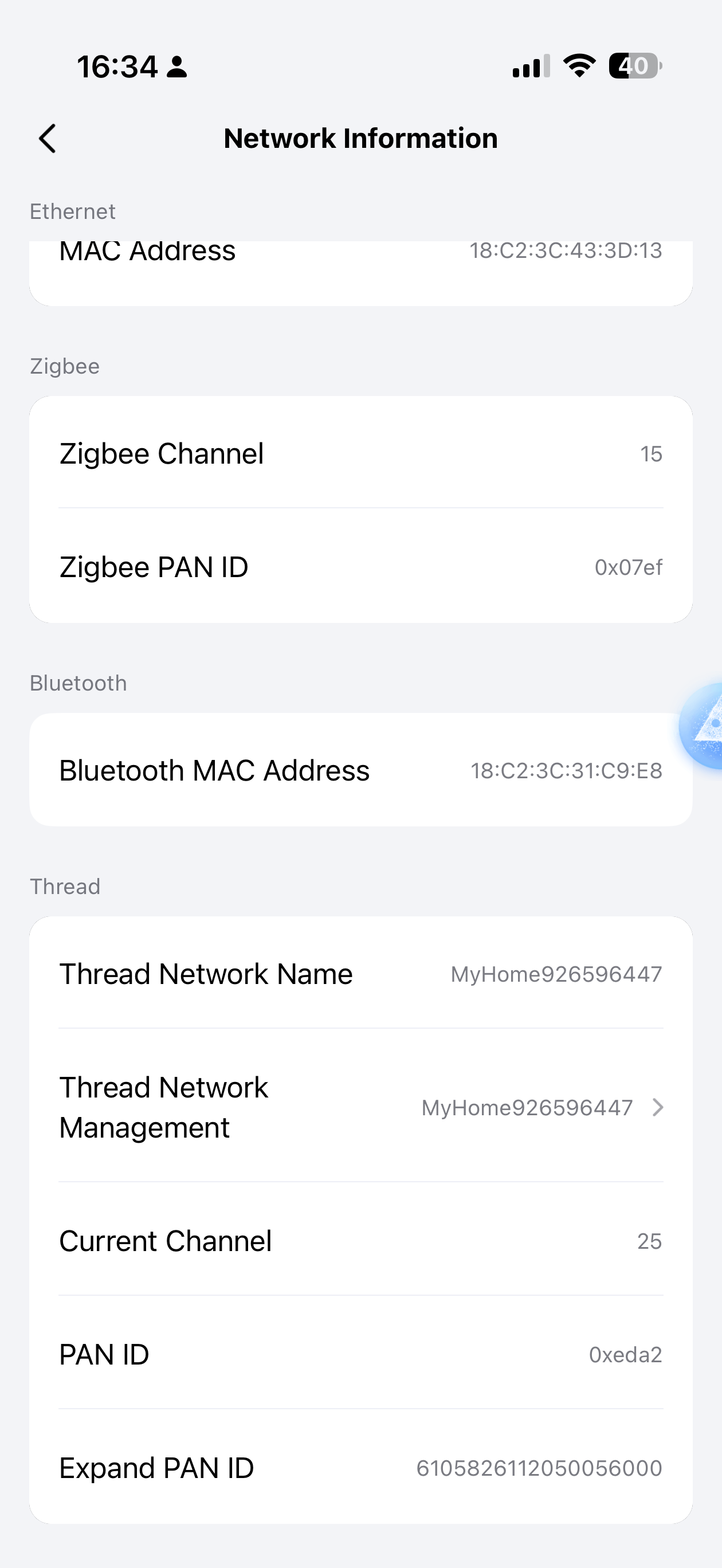

I have an Aqara Hub M3 and several Aqara Thread devices (G5, G410, cameras, etc). All of them are fully joined to the same Thread network as my Apple Thread Border Routers (HomePod mini and Apple TV).
Confirmed identical values:
  • Thread Network Name: MyHome926596447
  • PAN ID: 0xeda2
  • Extended PAN ID: 61058261120500056000
  • Channel: 25
Everything indicates that both ecosystems are already operating on the exact same Thread dataset.

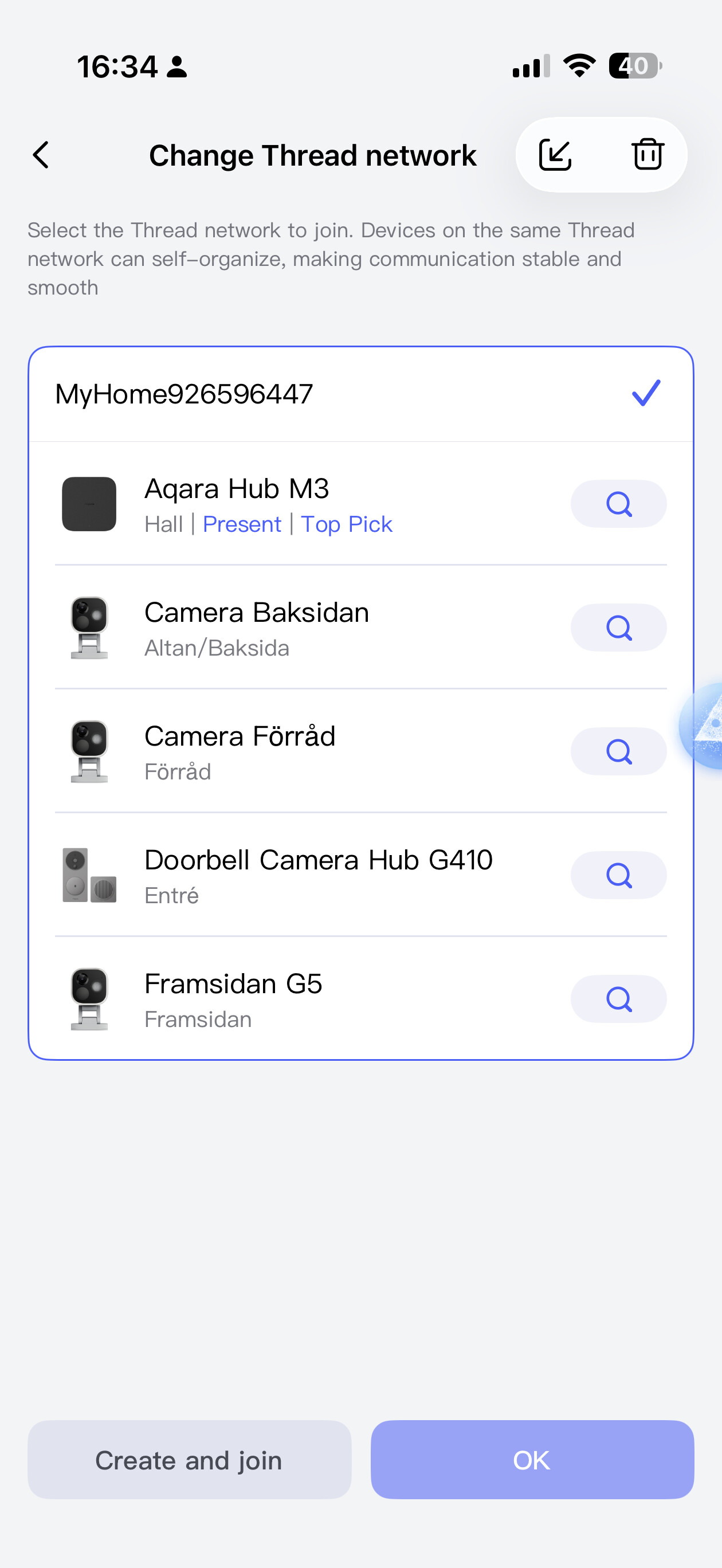

What do you see when you go to “Thread Network Management” under your M3’s Network Information?

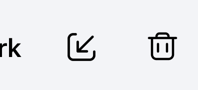

I don’t get this pop-up automatically, but if I click the little arrow at the top of this page, I do.
Mine does appear to already share the same thread network, confirmed by multiple tools. So this may be a bug.
