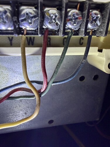

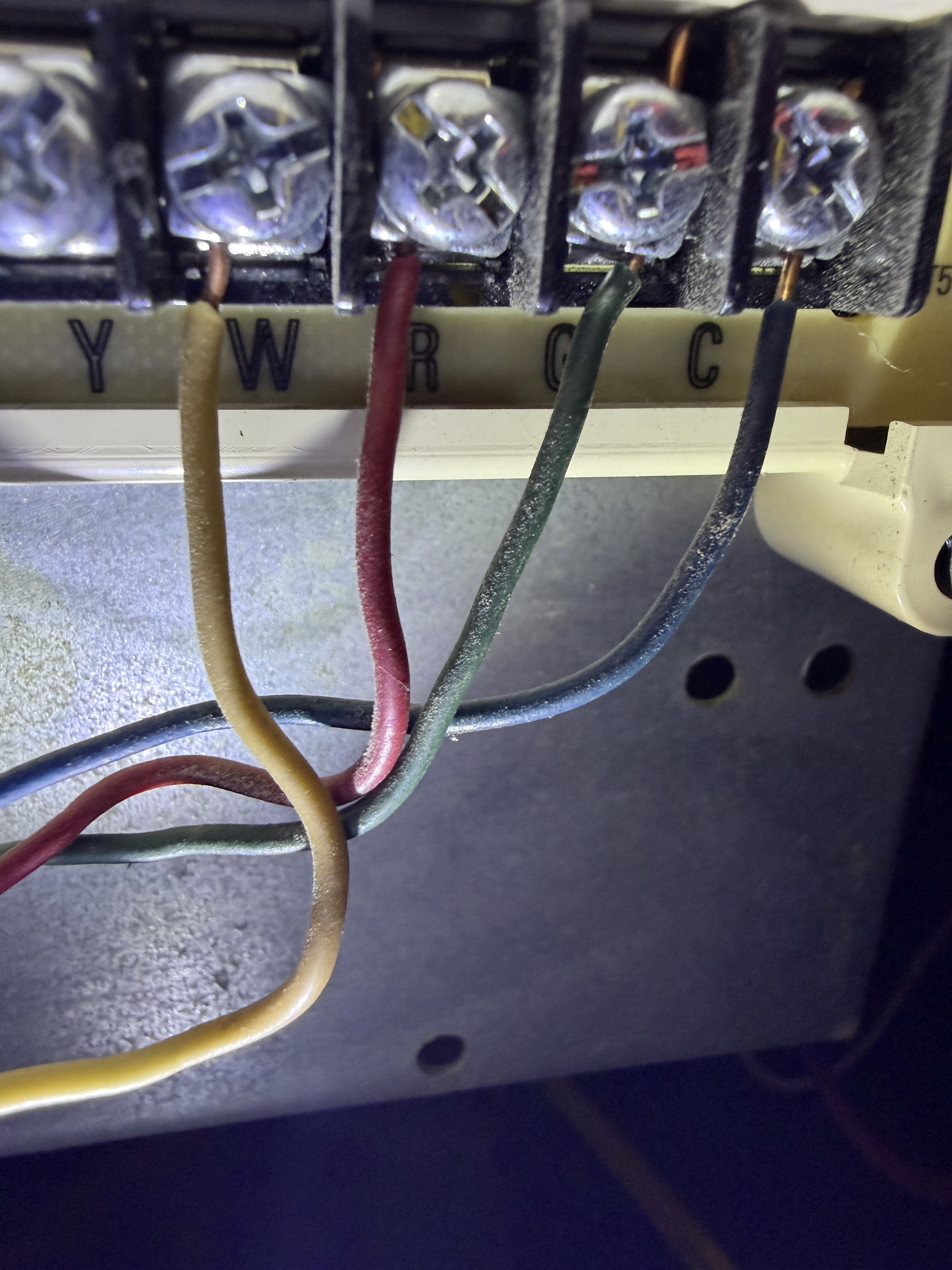

Here is a photo of the control board on my furnace. I was looking at it and comparing it to a C-Wire adapter and I can’t seem to line up the letters on the C-Wire with what I see on my control board.
Any advice would be greatly appreciated.
Are these wires your existing ones? It looks like you do have a C wire already. Is it not in the bundle at your thermostat?

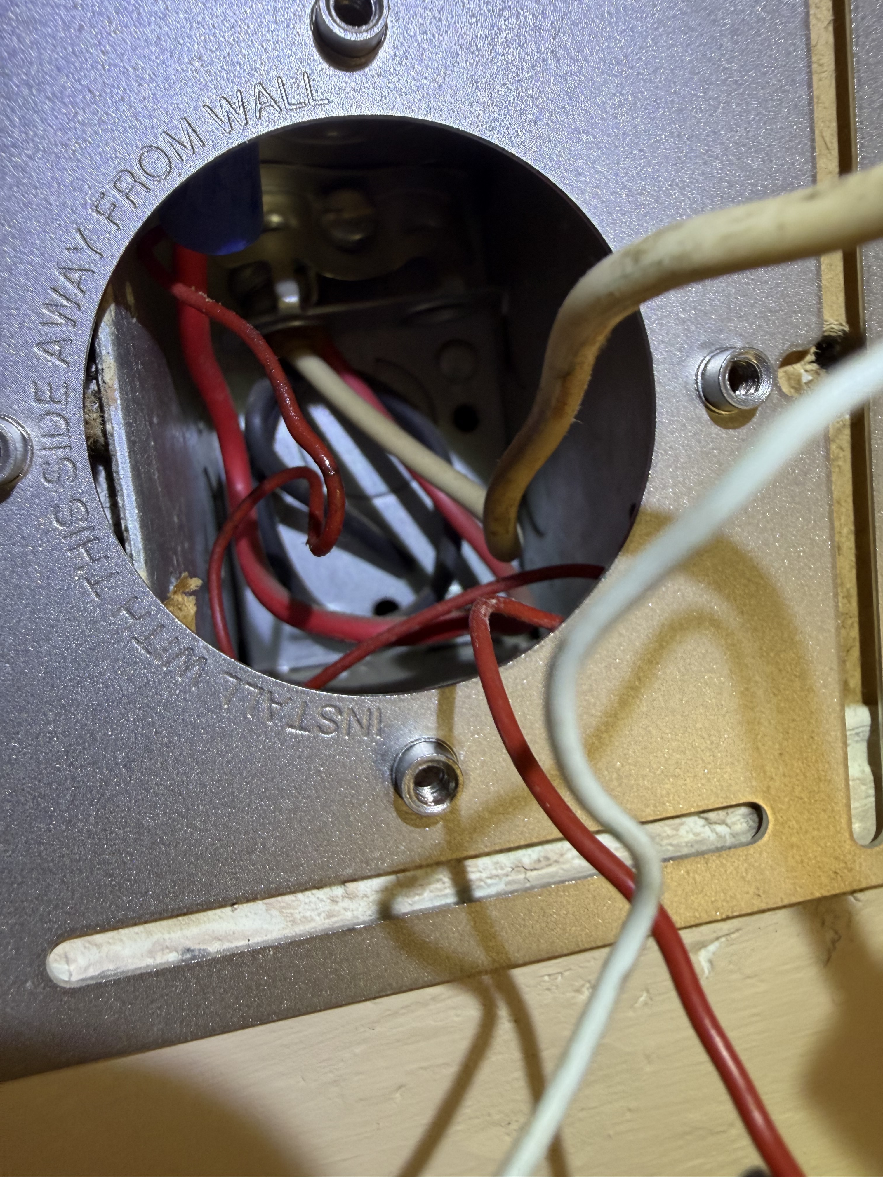

Nope. I looked when I first put in my Nest Thermostats, but maybe I’ll have to look again, as it may have been pushed back into the wall and I didn’t see it.
I pulled off my Thermostat for my heat to see if the C wire was in the wall somewhere and as you can see from this photo, the only wires in the wall are the white and red ones which are currently hooked to the thermostat, so now I have no idea where that blue C wire got terminated.
What’s the black wire at the back there?
Not sure… I looked at it, and its just one single wire in there that goes up and out of the jem box, so I am not sure where it goes. I sent a txt to my HVAC guy to see if I can have him come by the house so we can try to figure out this mystery…
