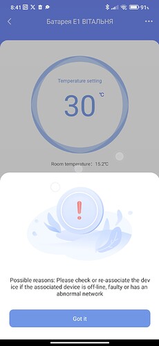

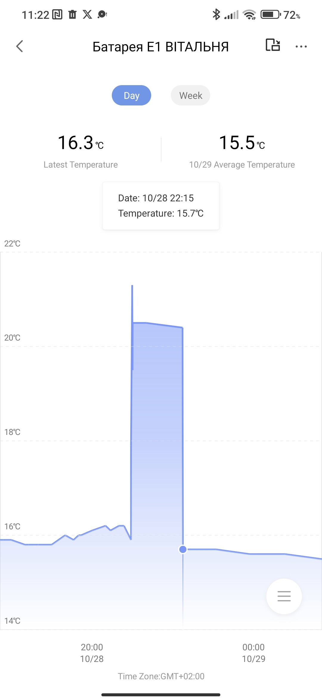

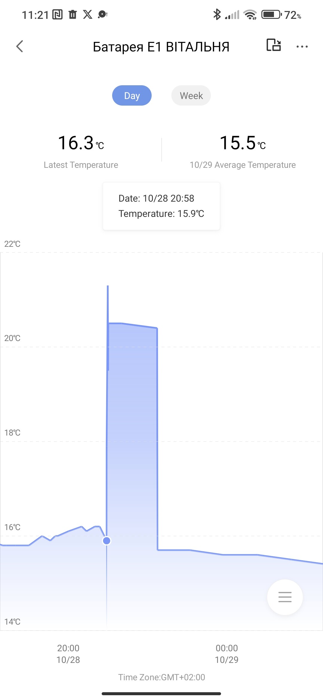

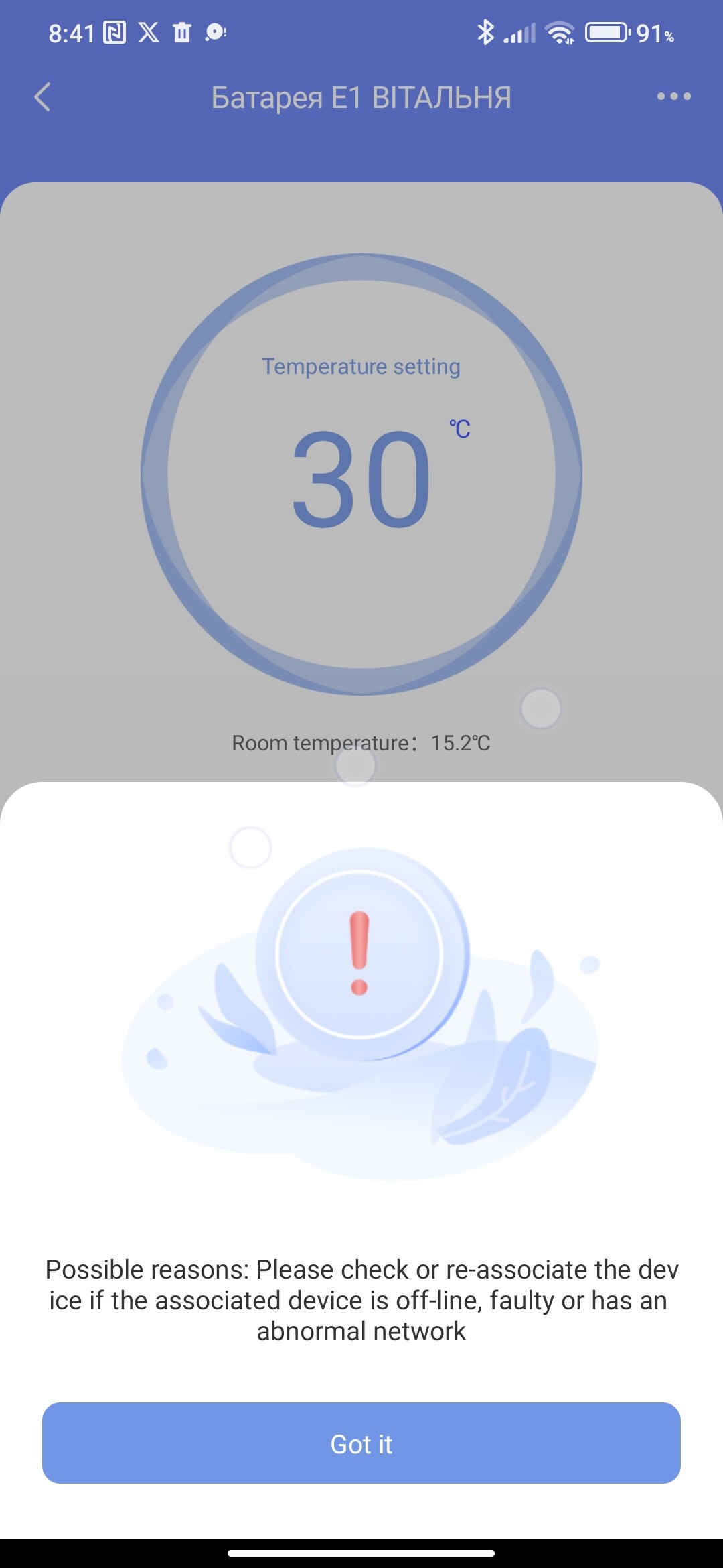

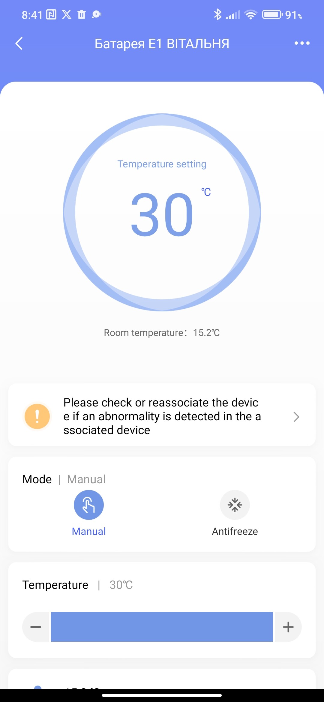

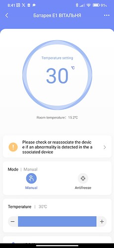

Hi, I also checked this issue. Everything works, the user gets a warning. The sensor was turned off for ~6 hours.
Control has shifted to internal measurements.
Did the thermostat switch to internal sensor after 6 hours, or did it happen before the 6 hours had passed?
I clarify, I went into the E1 schedule where I saw the switch to the internal thermometer. 21.00-22.14. Conclusion, after determining the temperature sensor as offline (by the Aqara application) E1 switches to the internal sensor. Sorry for the inaccuracy of ~6 hours, I got up early and did not research the exact time, so I put ~.
