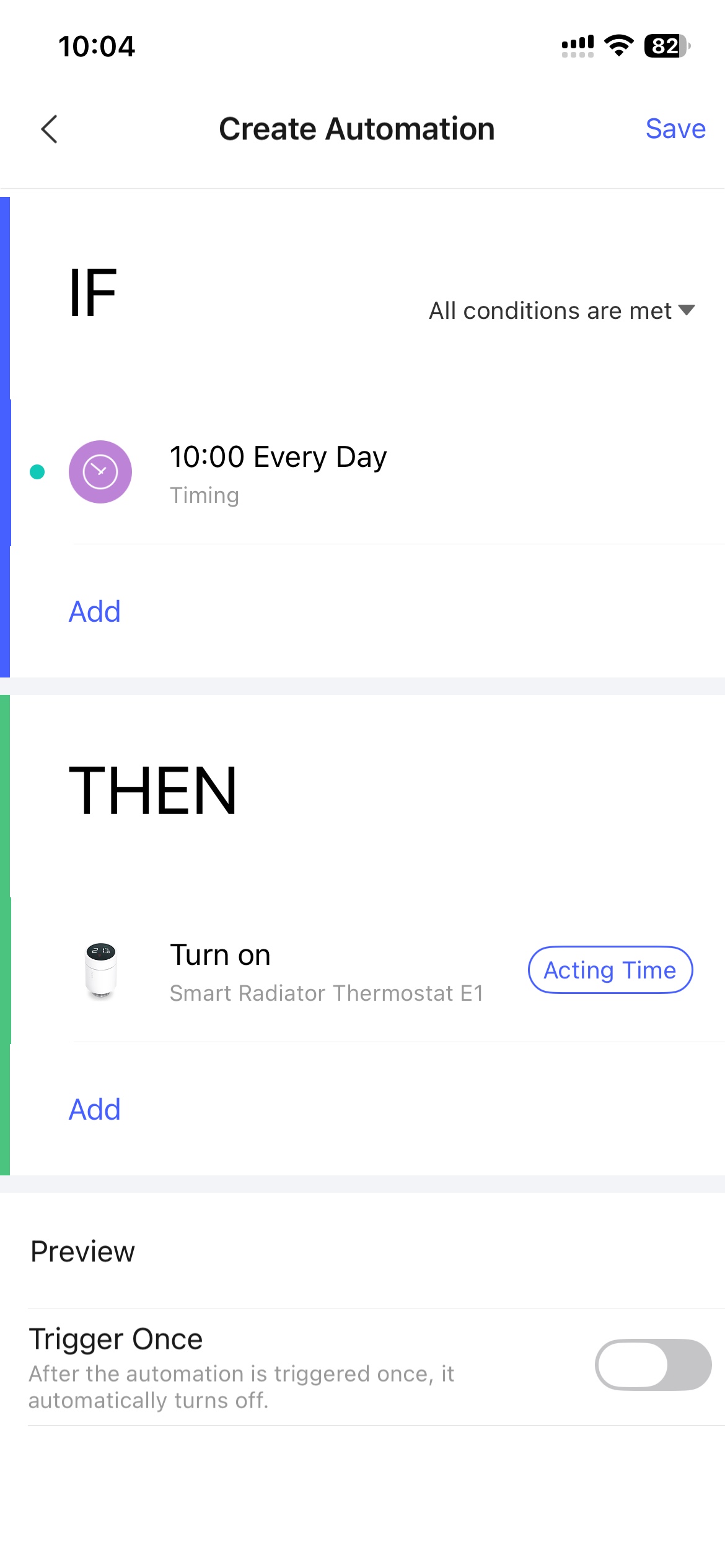

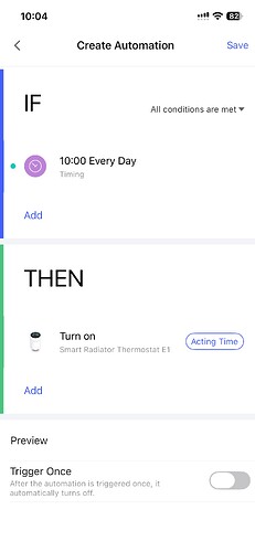

I am currently working on this issue (writing a new lesson). I have developed a way to create an individual heating schedule without restrictions on the number of temperature periods, it is even possible to use days of the week. Once again, without restrictions. The main condition is that you need to have at least one W100, this method requires creating automation. Suitable for E1 and W600.
I have individual temperature sensors in each room where the radiator valves are. Can they be used?
W100 has the ability to control by time interval (after 10 minutes), which gives a request for execution. There is a workaround, I will write about it. This is automation, I emphasize again.
Yes, they will be involved.
E1?You can set a automation

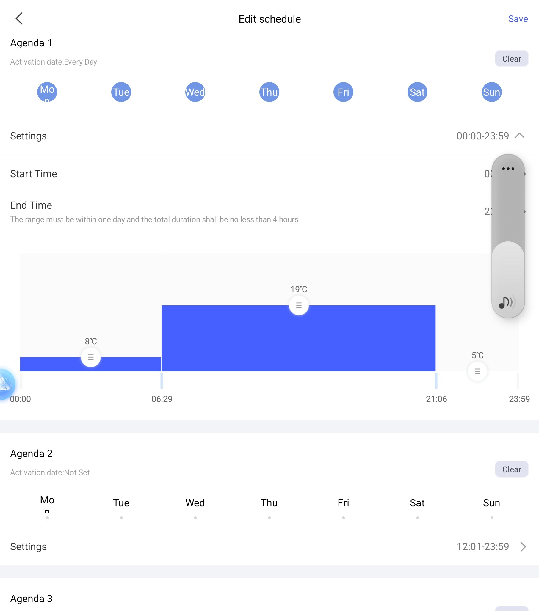

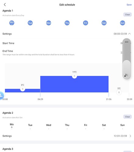

I was trying to use the built in functionality
Trying to use this functionality but can only seem to see 3 timing blocks within a 24hr period. I am looking for a 4th block
By default, only three periods.
