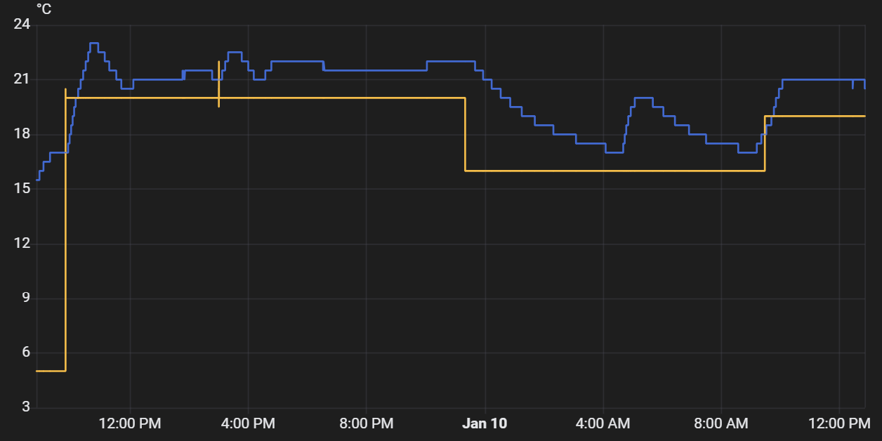

Meanwhile I got an update to Thread firmware 1.0.0.8 and while there don’t seem to be any oscillations any more, the controller behaviour is still far from perfect.
Issues you can see in the temperature plot (yellow: target, blue: current):
  • There is still an overshoot, when increasing the target temperature
  • Temperature is always higher than target
  • The TRV starts heating randomly in the middle of the night
  • This morning I set the target to 19°C, which caused the TRV to heat to 21°C where it has been ever since then.
There still seem to be some fundamental flaws in the controller design.
