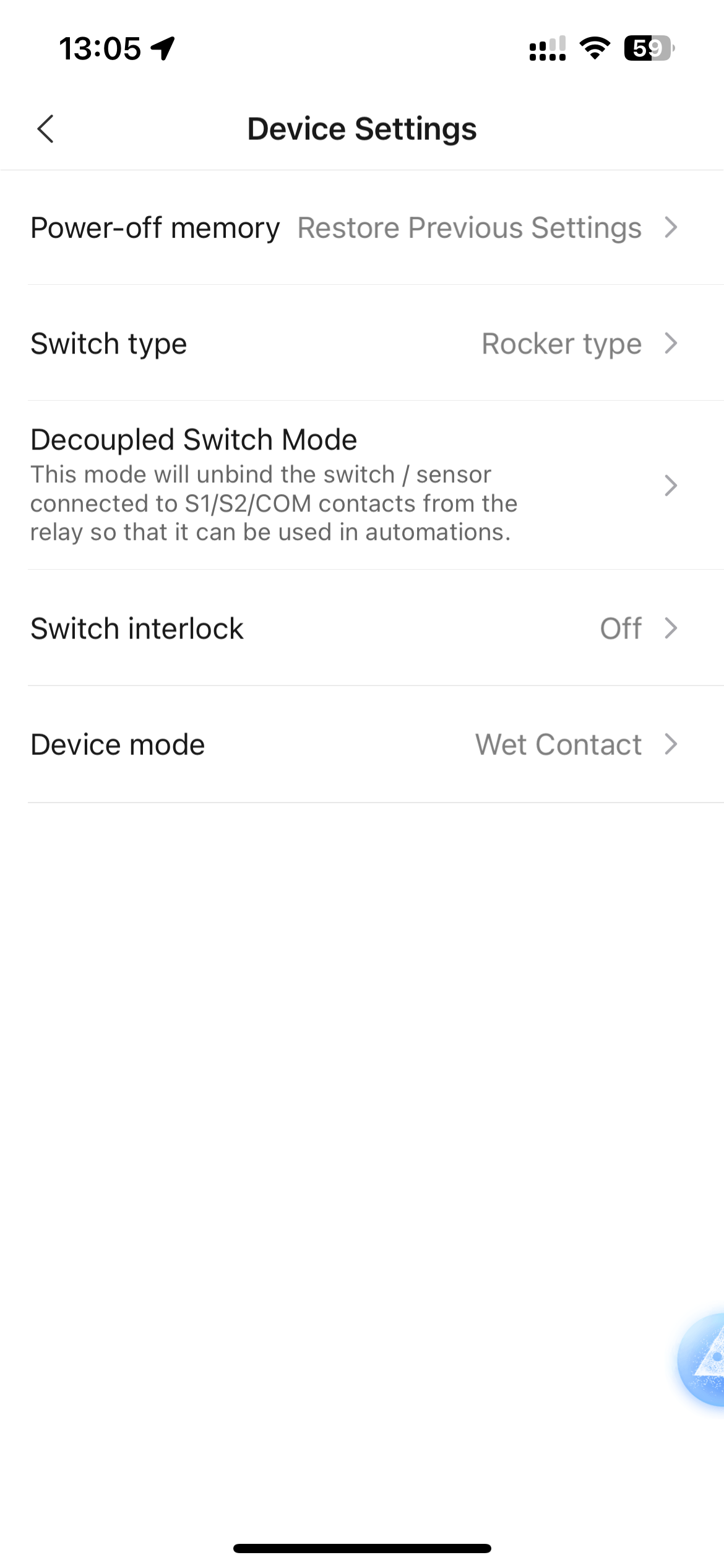

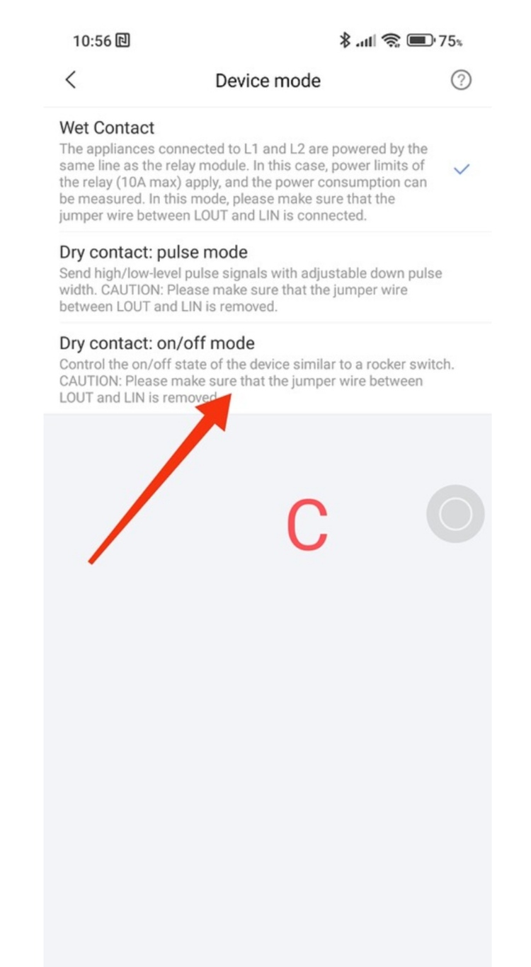

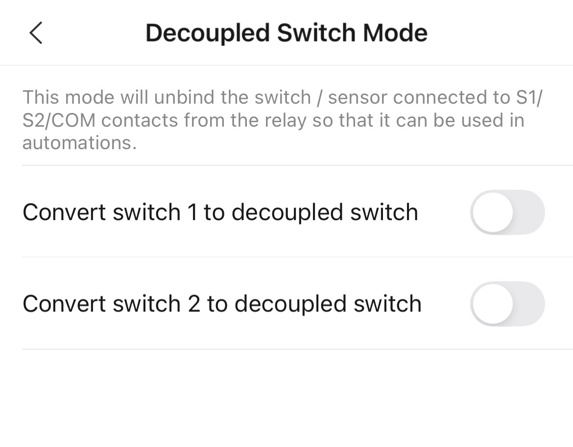

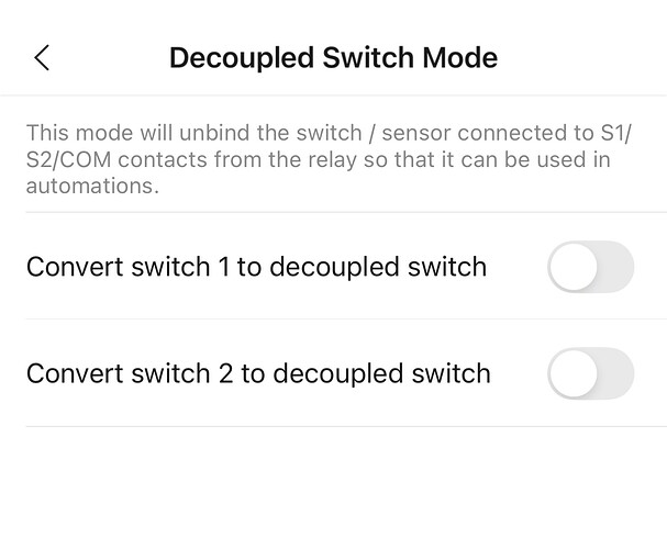

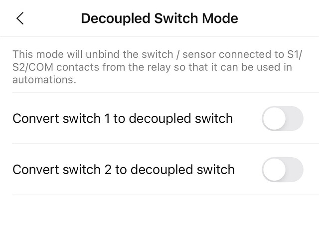

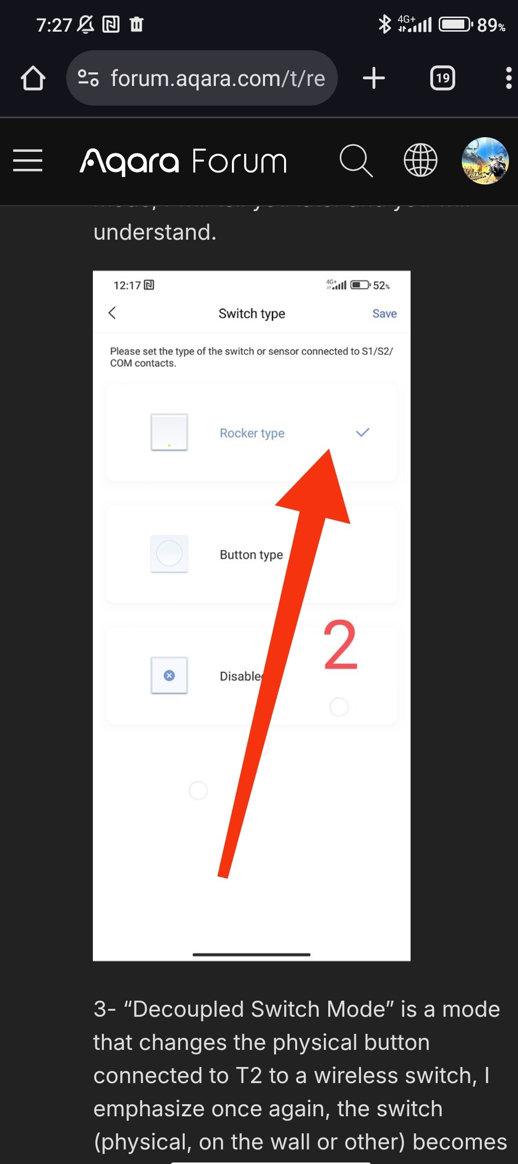

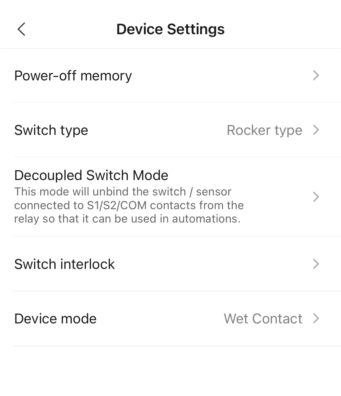

And this are the settings of the T2 module (the decoupled switch mode is enabled for both)
Change here.
My switches are buttons so I have to keep it that way, but anyway I already tried, and of course it’s a little faster, but there’s still some delay

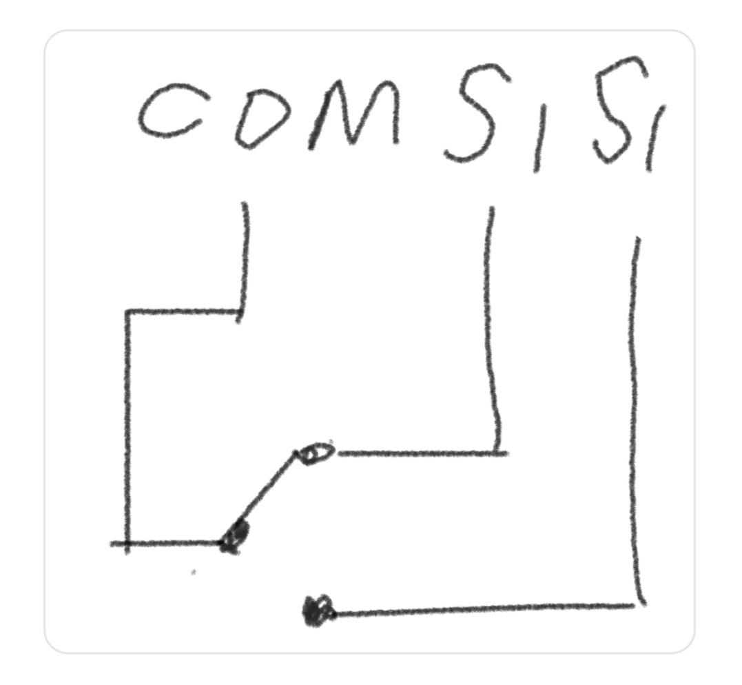

If you have a button, try connecting a “dumb” relay to relay T2 according to the diagram. Probably, when there is an on/off of the “dumb” relay, T2 will perceive it as a pulse. I repeat once again, these are my suggestions, I have not tested them.

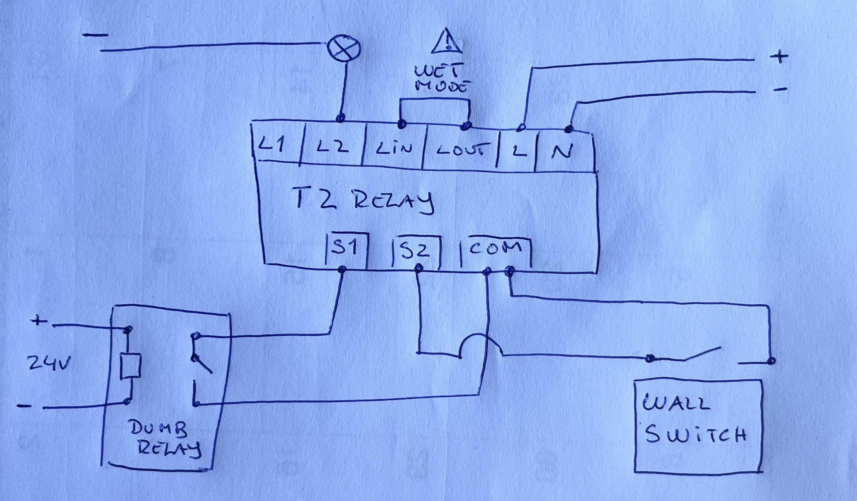

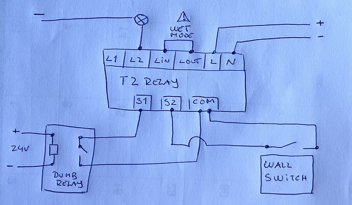

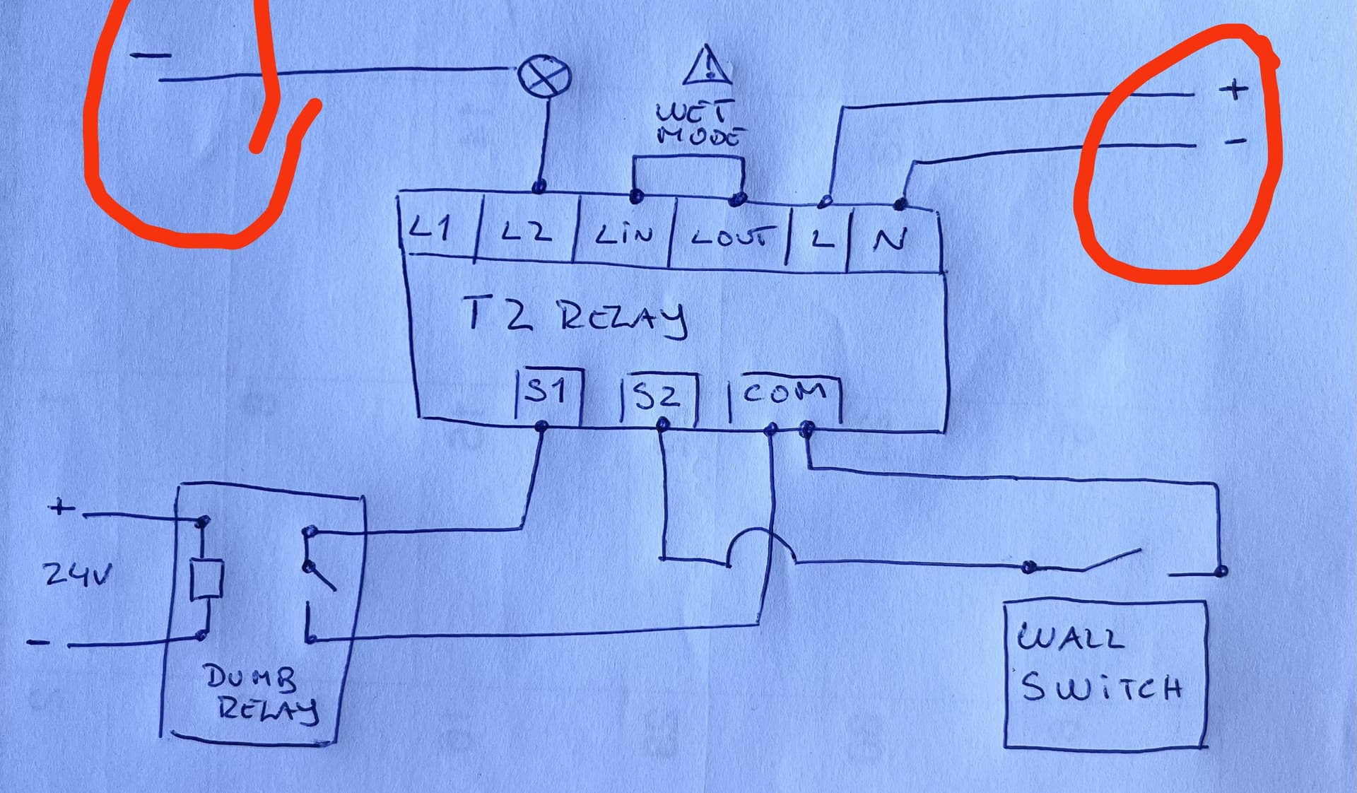

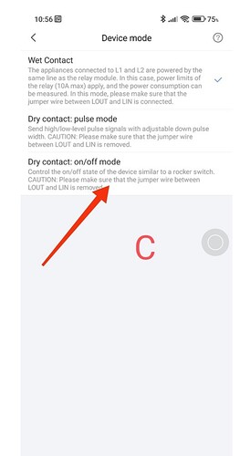

After reading again your amazing explanations I ended with the following diagram and T2 configuration. Would it be possible to have your validations and more than valuable comments? :grinning:

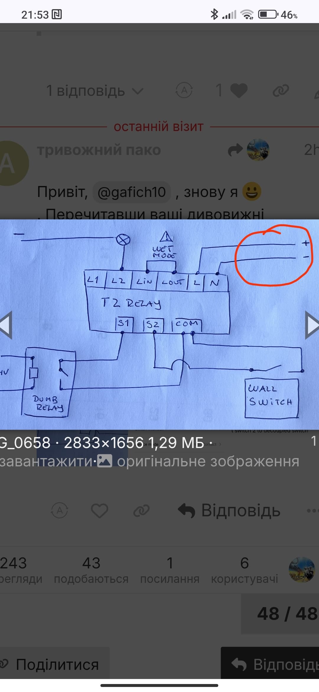

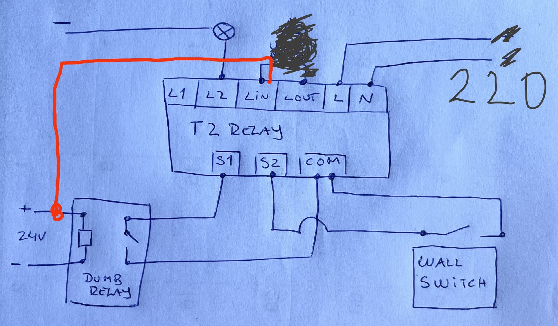

What is the voltage here? 220 or 24 +/-?
If it’s 220, then you need to do this.
@gafich10 thx for the prompt response .
L and N is 220V.
The Dumb relay is 24V.
S1 doesn’t control anything, is the switch emulator for Aqara T2 identify a status change.
L2 is to control a 220V bulb. Only Load wire goes into L2.
S2 is connected to wall switch, to control the bulb.
Being dumb relay connected to 24v, I think I can’t connect T2 LIN to it, right?
I’m using T2 to trigger an automation when S1 change status, and L2 to turn on a 220V Bulb also controlled by S2. Shouldn’t it be wet mode to provide 220V Live to L2 (bulb load)?
If the marked circles have 220 volts, then your circuit is working. You just used the “+” and “-” signs in the picture, which means constant voltage, so I thought it was 24 volts.

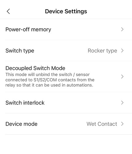

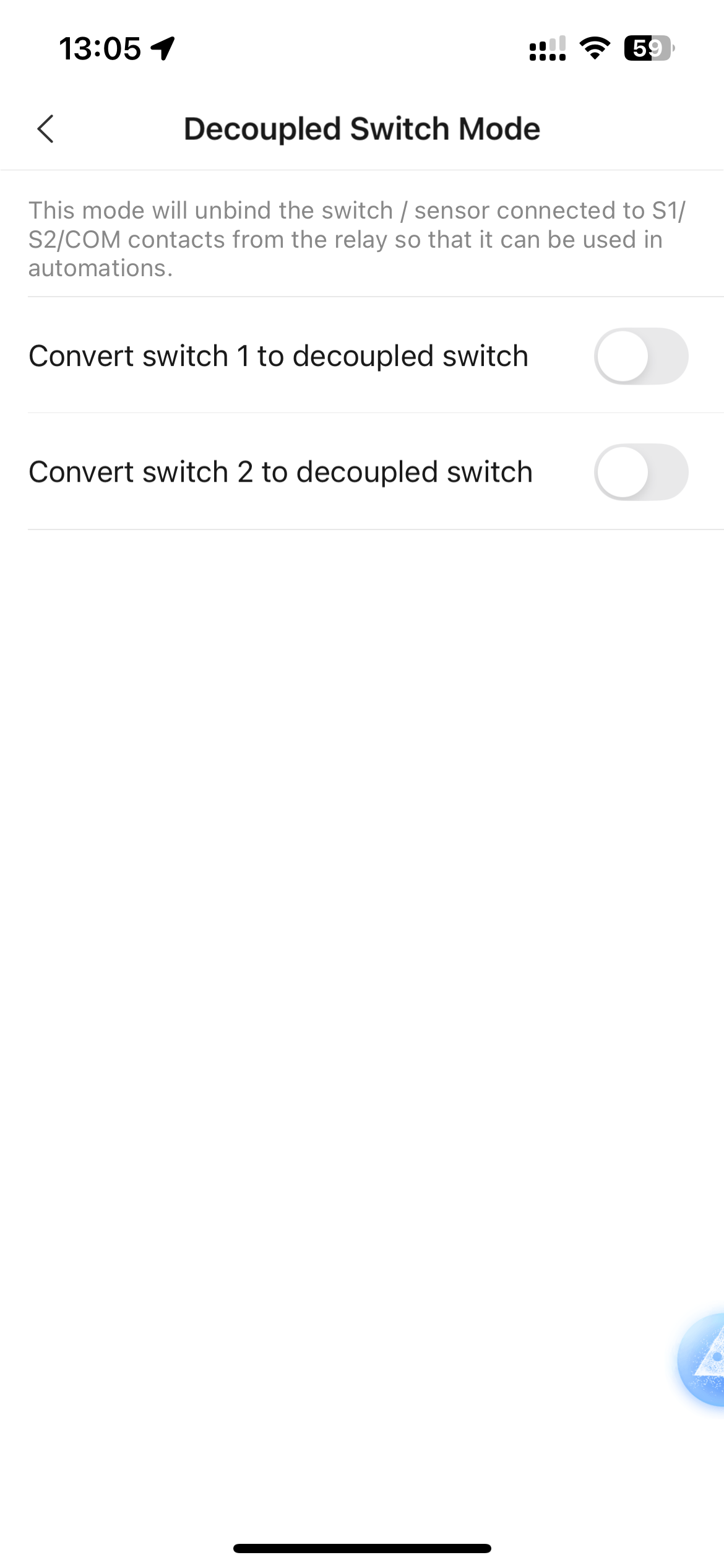

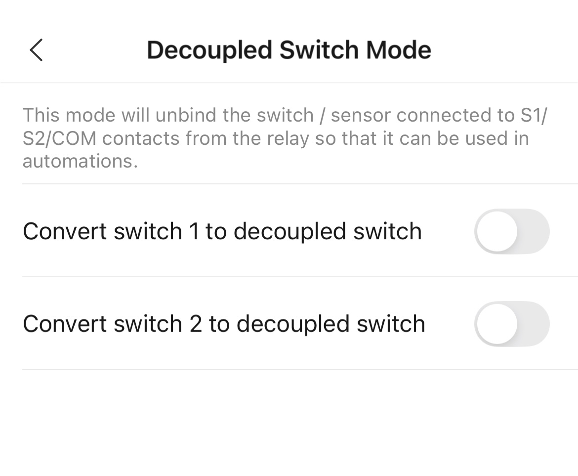

Exactly. And regarding T2 configuration, can I do it as in the screenshots I placed?
Thank you!!!
Yes :+1:

When using the decoupled switch, should T2 still read when we use S1/COM?
Hi, remember, I’m always happy to help :slightly_smiling_face:.
No, in the resolved state you can’t control the state of T2 (read data).

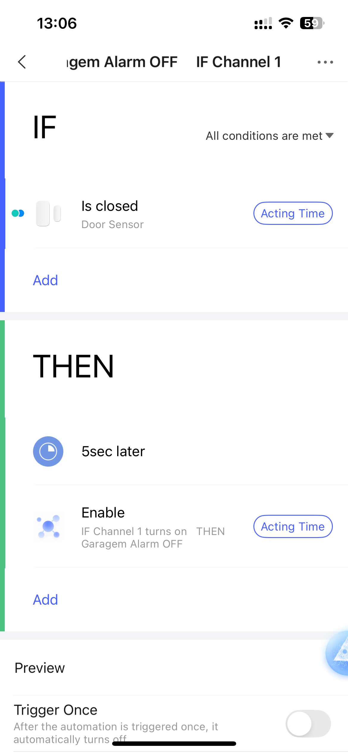

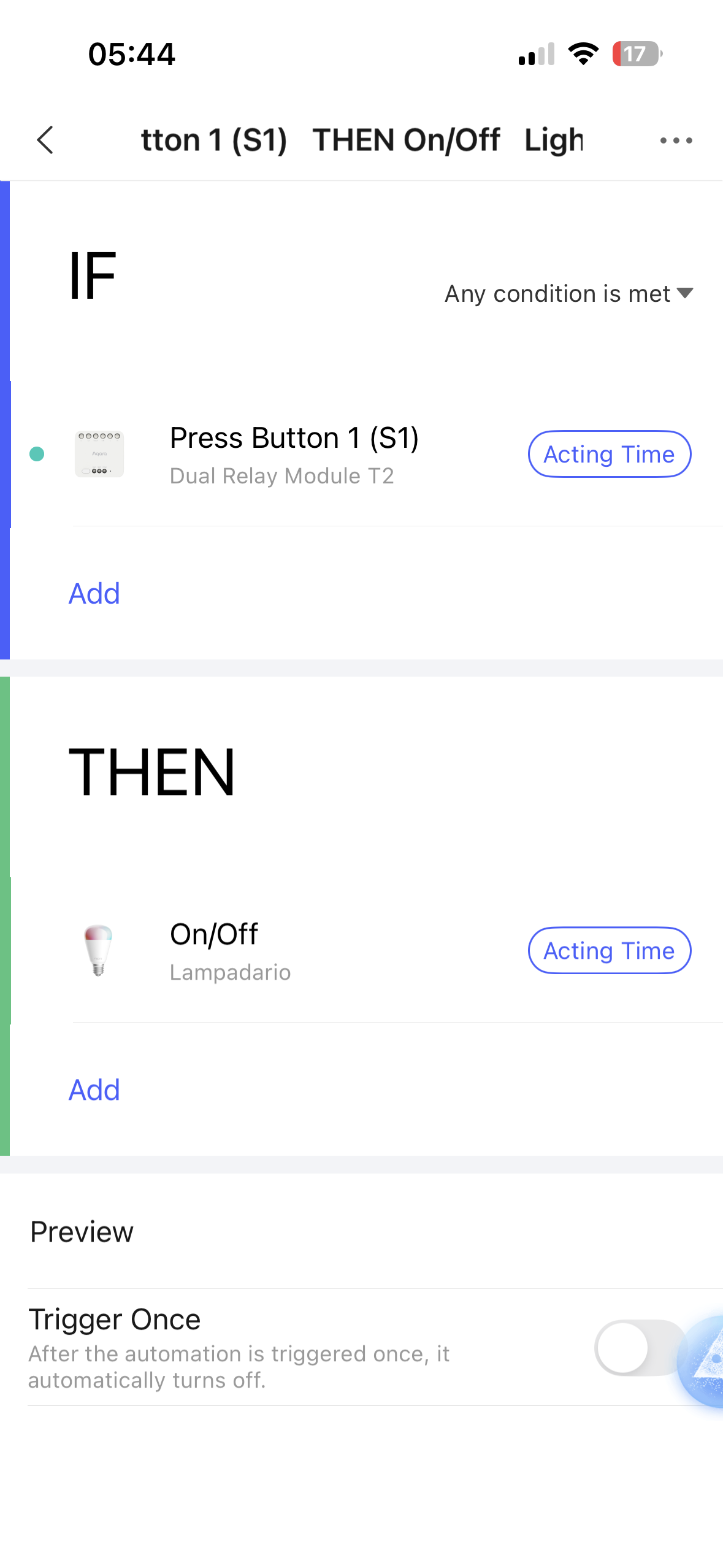

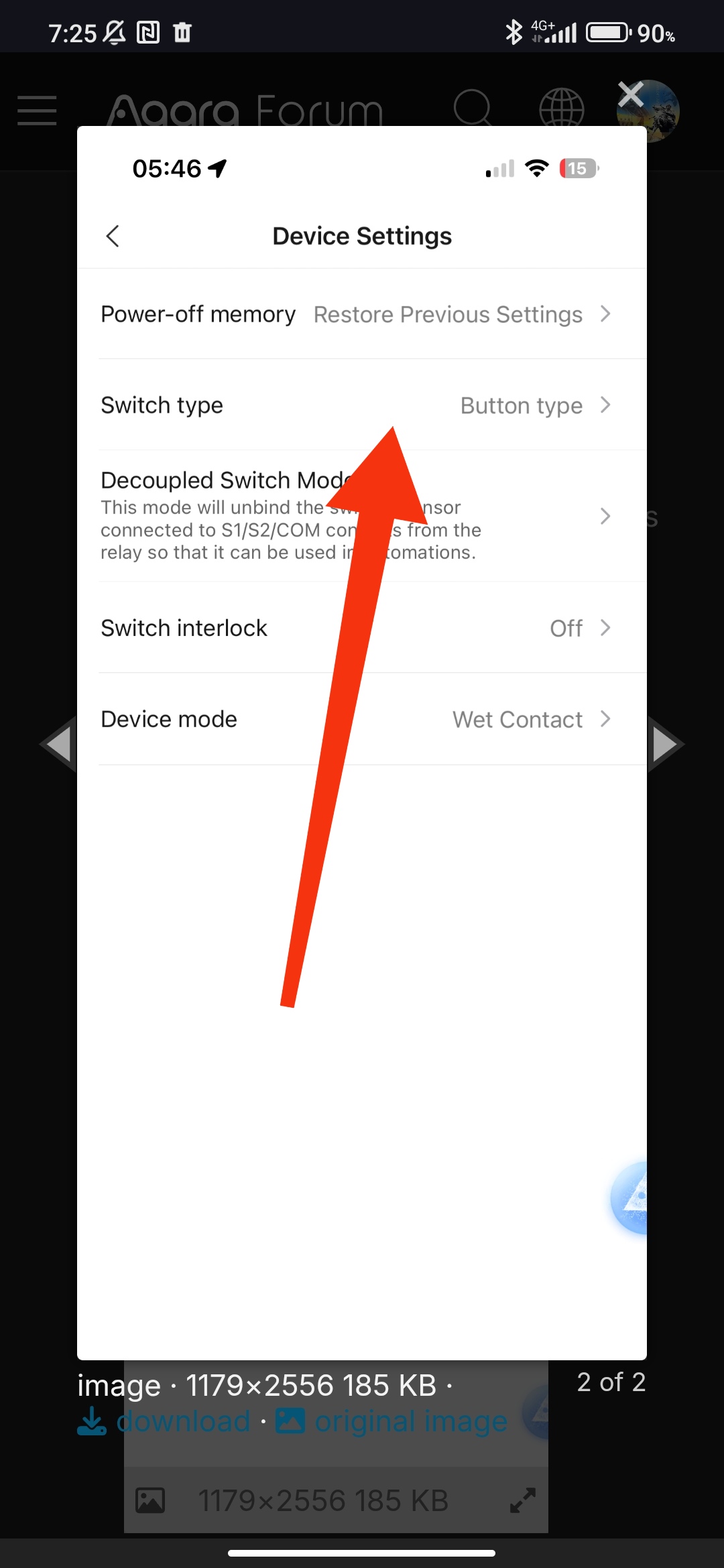

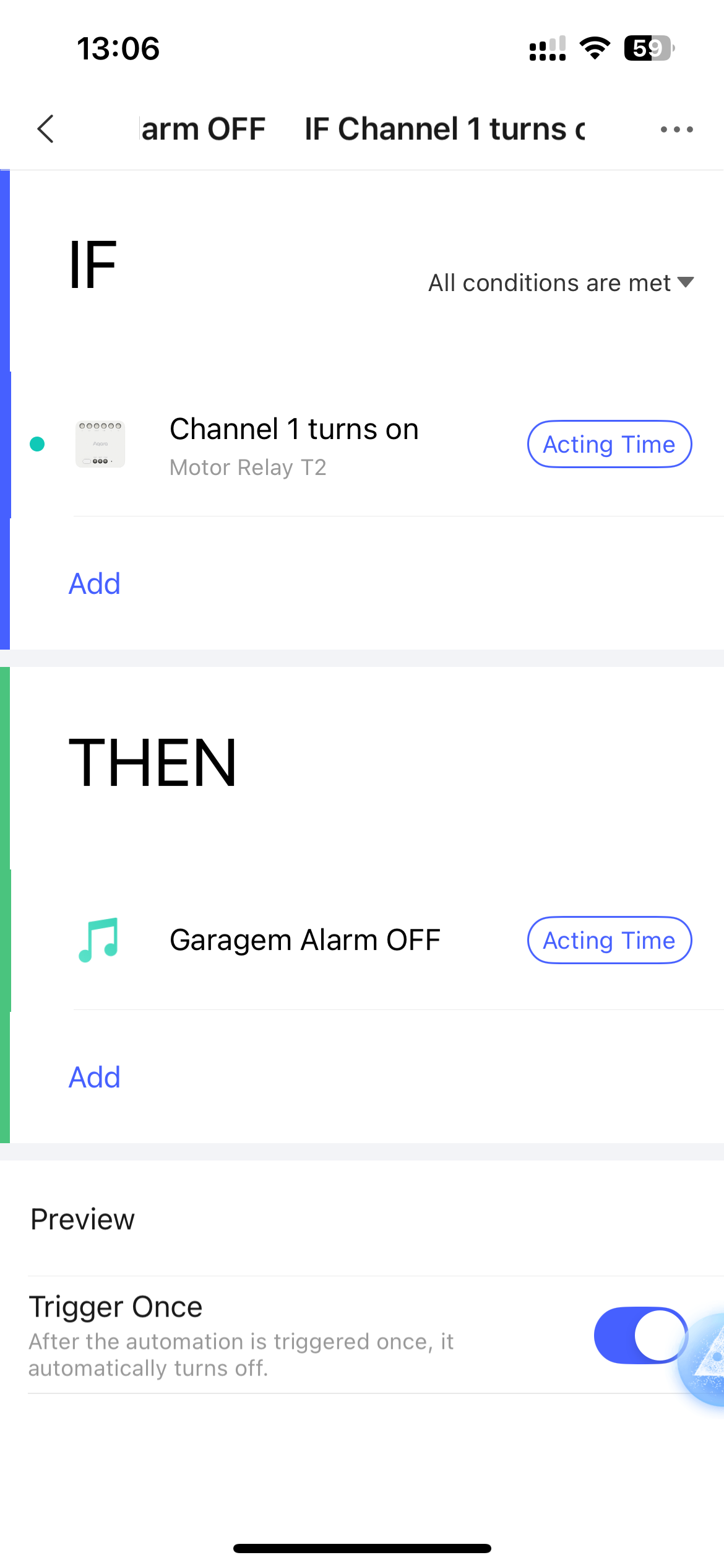

Hi, I have some ideas, but give me screenshots of your automations. I will understand their essence and give you some tips.
Hi again @gafich10 ,
Quite simple automation.

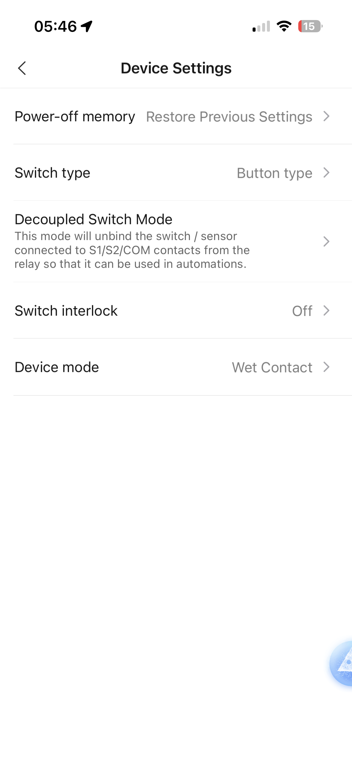

T2 Config
The automation when motor is running
Second automation that enables first one when door is closed
I have some more automation to enable disable sensors that are acting as trigger to alarm.
I still need to connect to T2 S2 and L2 the garage lights to turn on when running the first automation
