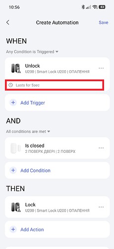

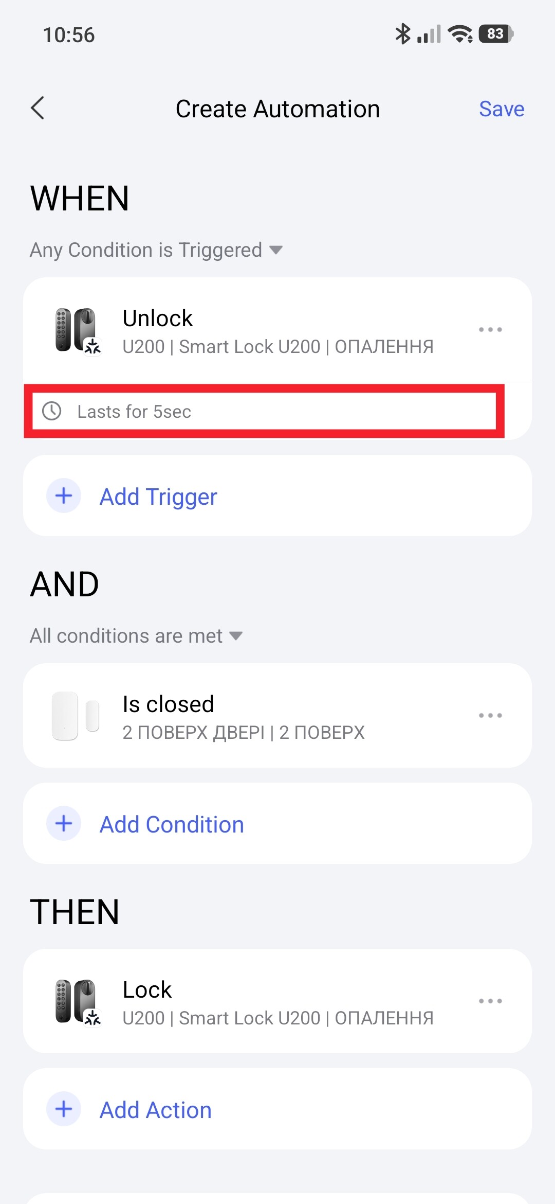

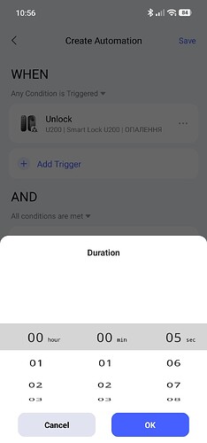

Hello, if you have an opening sensor on the door, I do it like this. Explanation, if the door is opened by the lock and physically closed, then the lock will automatically close again, pausing for 5 seconds for the IF condition. Be sure to set the settings that I showed.

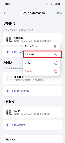

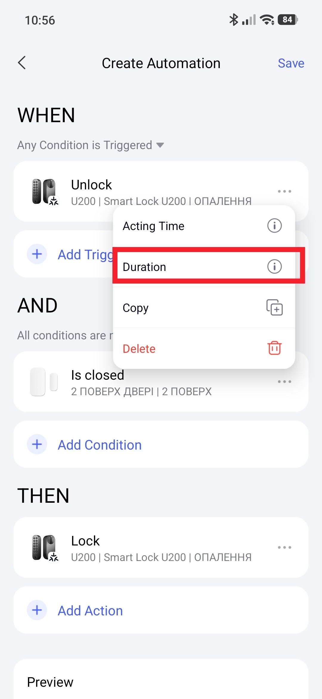

Hello, @AqaraOfficial , see how important this parameter “…” “Duration” is for automation.
