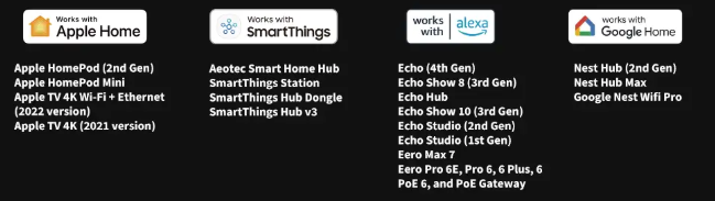

The crucial part is the Matter Controller you use, because it provides the door lock functions for the respective ecosystem. So if you want to use the door lock via Aqara Home, you need an Aqara Hub; if you want to use Google Home, you need the Google Nest Hub Max; and for Apple Home, you need an Apple Home Hub (such as an Apple TV 4K). For Home Assistant, a software Matter Controller like the Matter Server, which is installed as an app (formerly add-on), is sufficient.
Image Source: https://eu.aqara.com/products/aqara-smart-lock-u200
