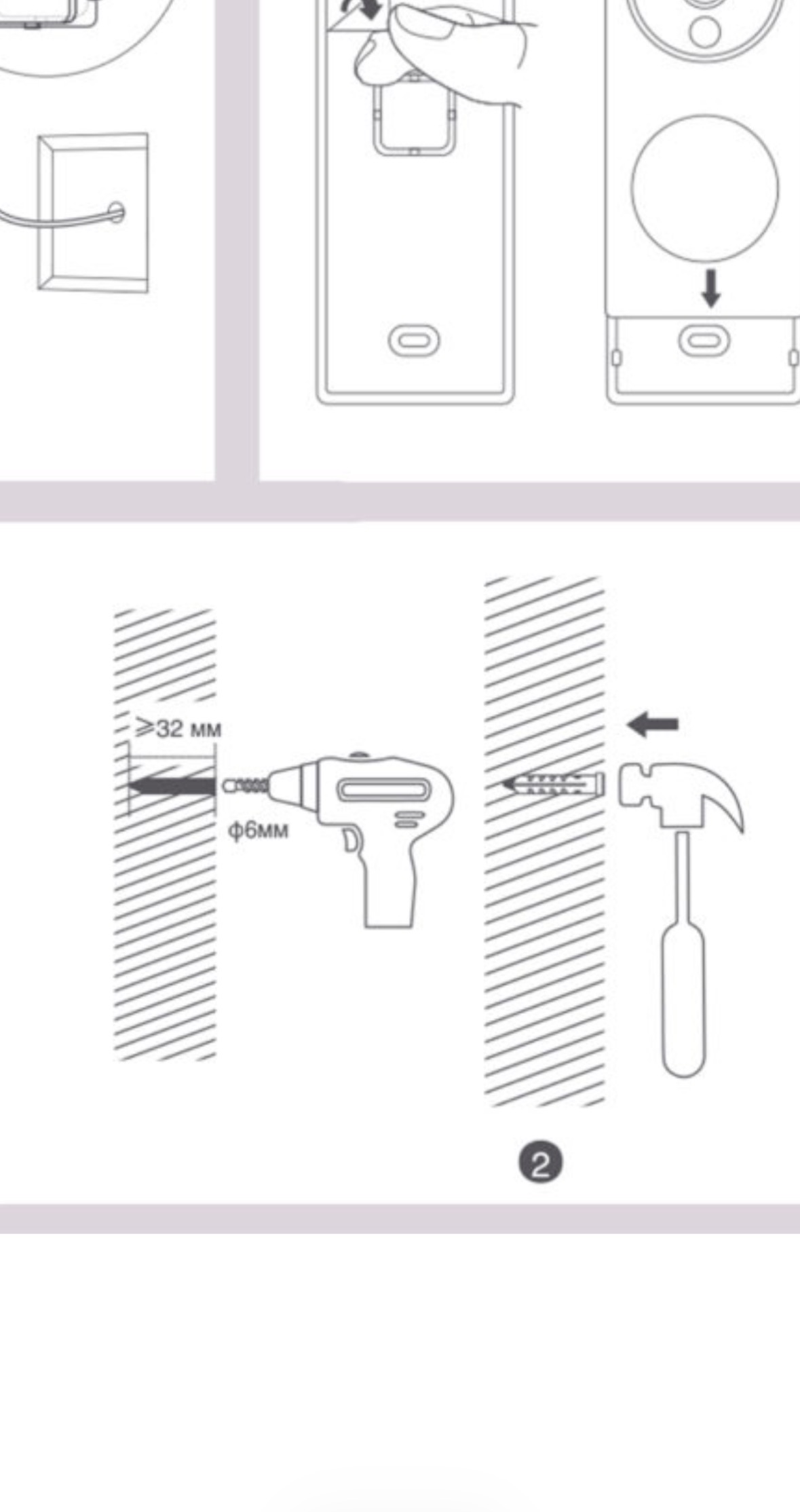

Thanks, unfortunately this just shows the diameter of the hole to drill. Not sizing of the anchor itself or the screw that goes into the anchor.

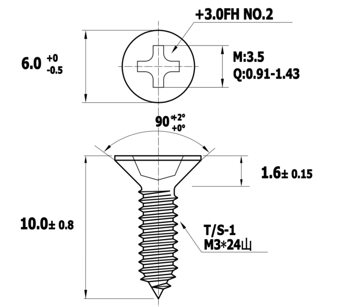

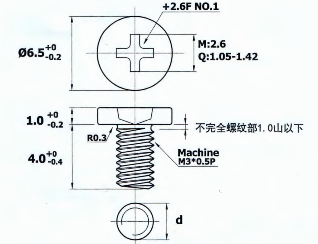

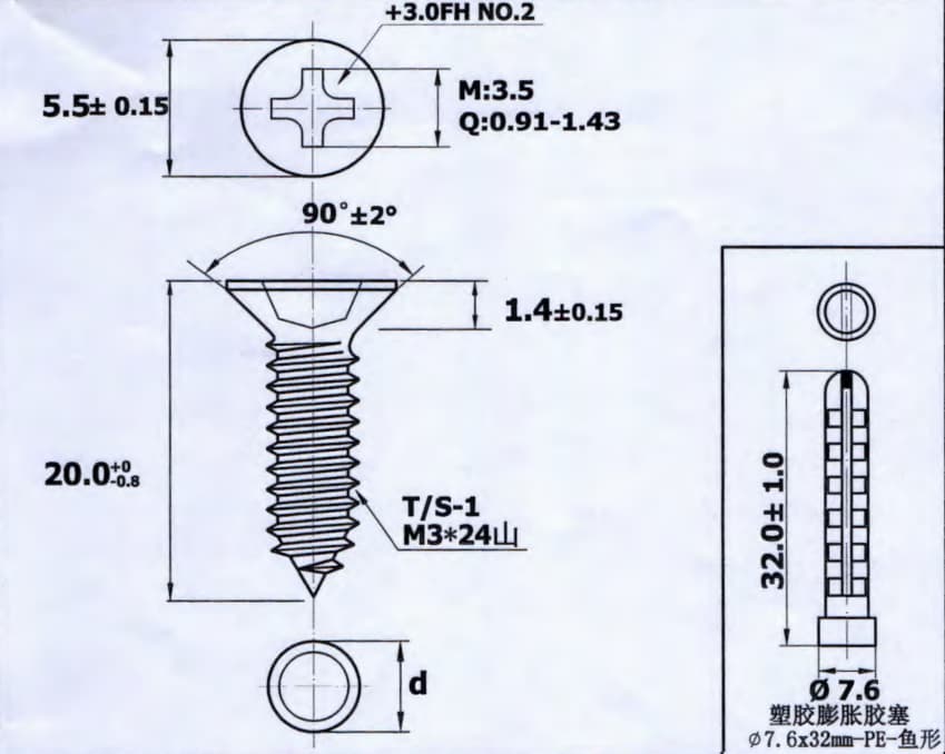

I have showed all of the anchors & screw for G4/G410(they use the same ) below:
Wall Screws
Wedge Screws
External power terminal Screws
Any anchor with the same screw size should work.
