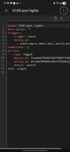

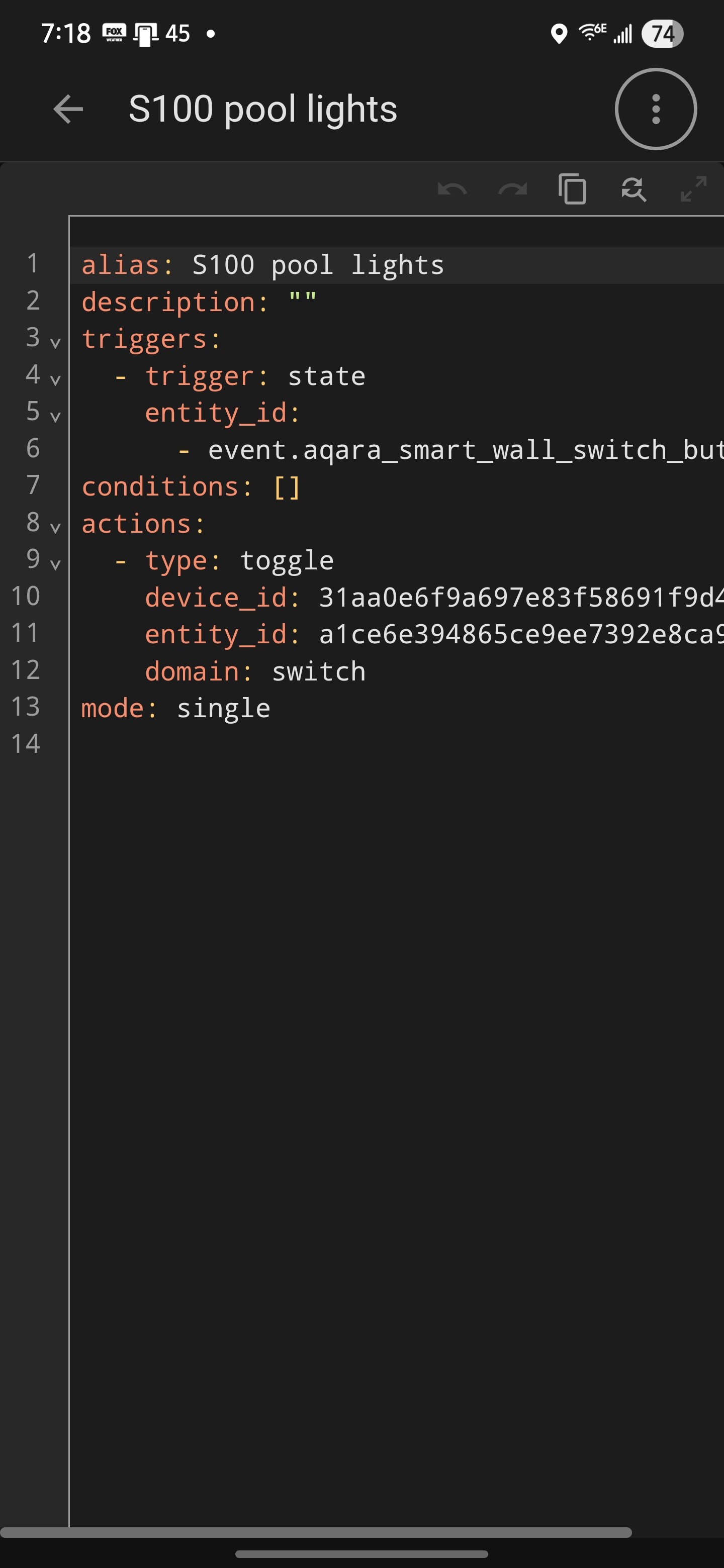

I have the S100 Connected to the Aqara M3 and then shared to Home Assistant

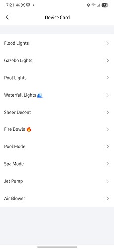

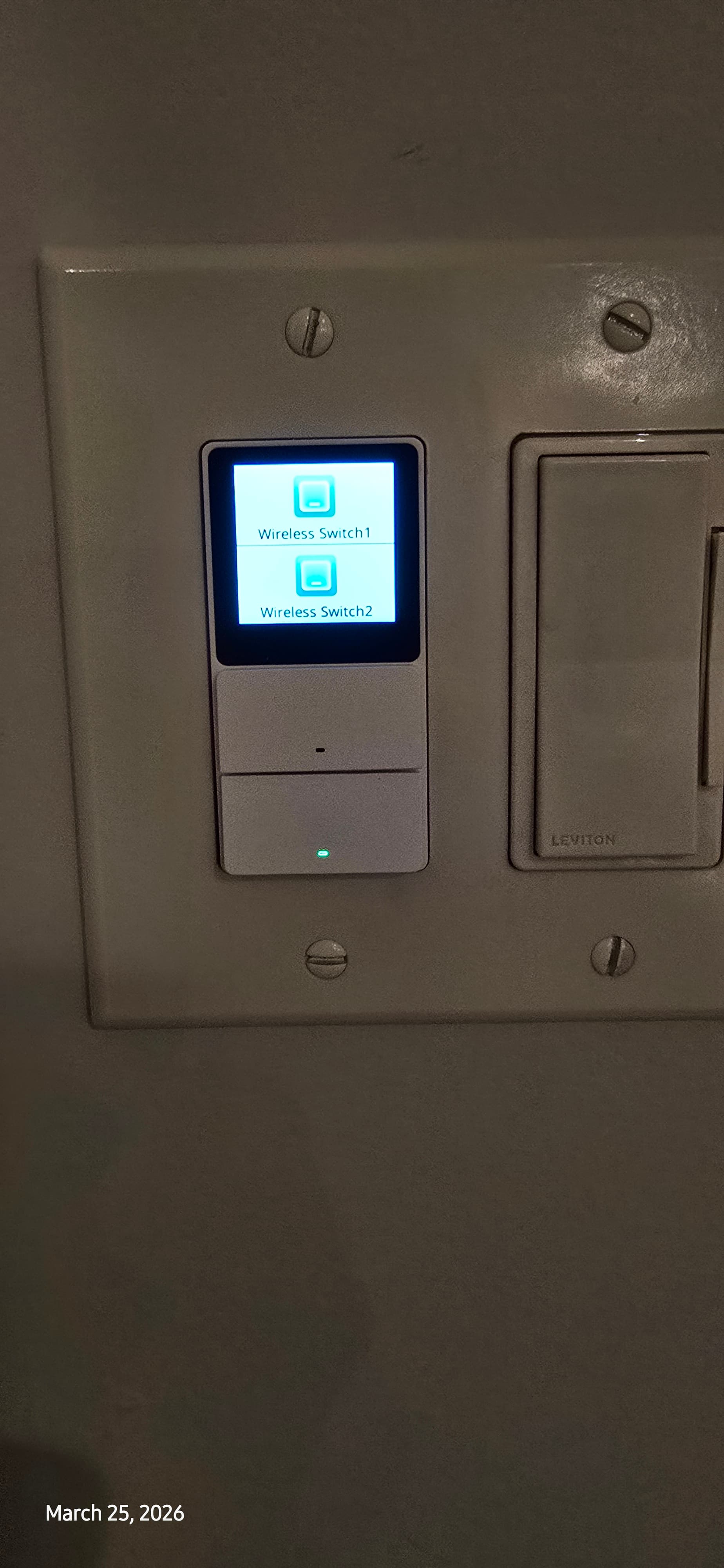

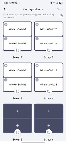

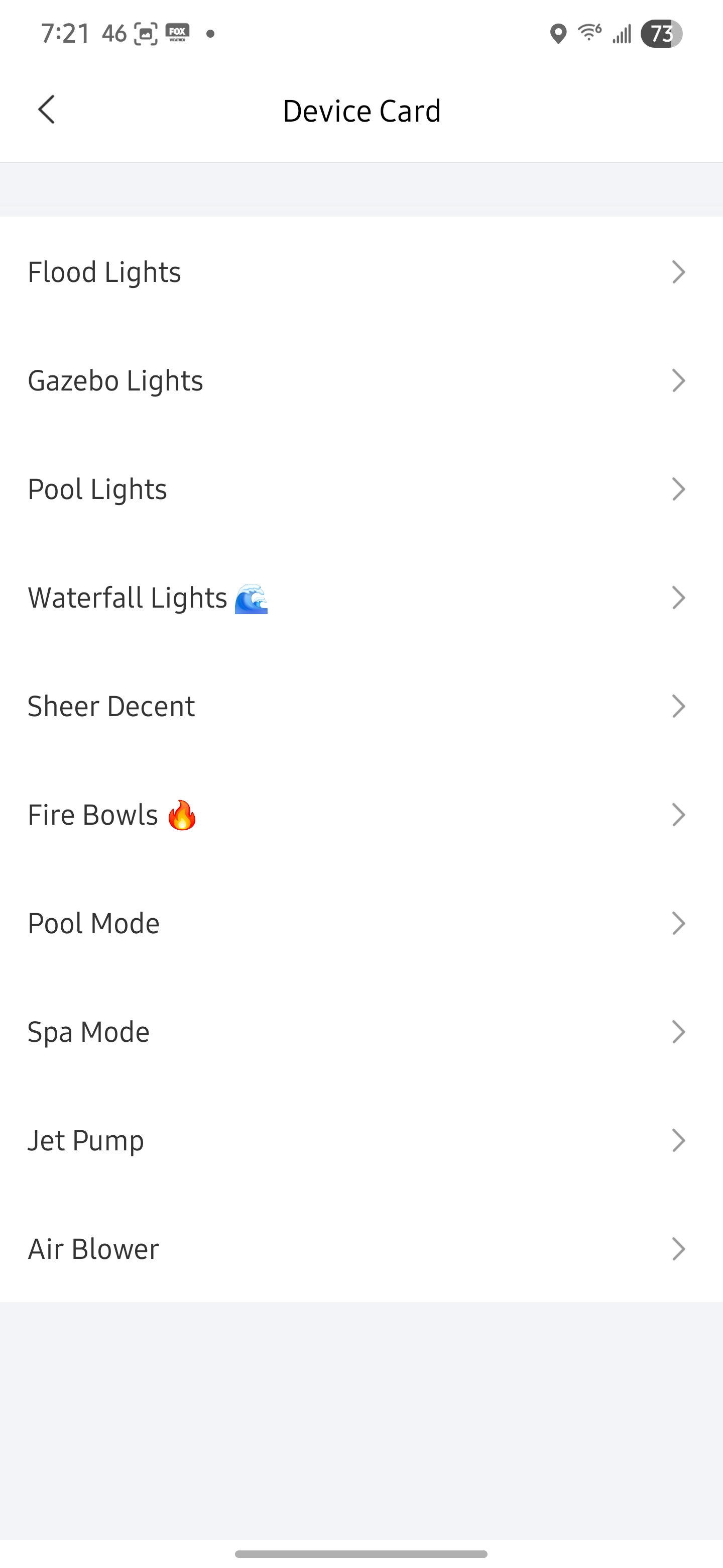

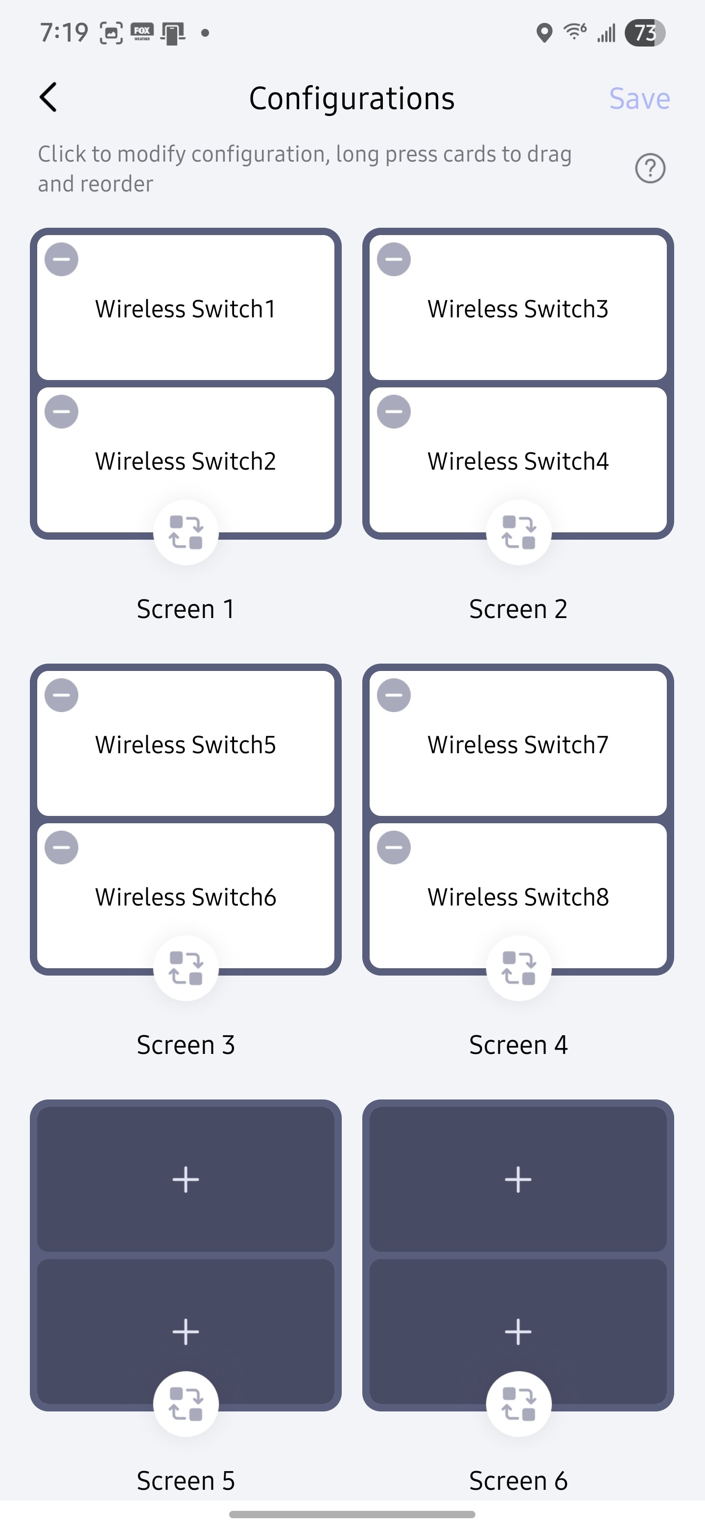

. In Home assistant I have wireless switch1 (on screen) connected to my pool lights via AqualinkD/Home Assistant and it turns the lights on and off as expected. How do I change the display to read “Pool Lights”? I have already updated the ‘card’ in Aqara Home but it doesn’t update on the switch. Would also like the background to go black when it’s off and white when it is on like it does with the H2 devices connected to the Aqara Hub. Is this possible?
1、When connected to Home Assistant, you cannot rename the device because renaming is a feature exclusive to Aqara.
2、The background turns black when the light is off and white when it is on. This functionality—where the background turns black and white—can be achieved with a two-way relay switch. However, when you tap the wireless switch on the screen, it is merely a tap operation; since it is unclear whether the switch has been successfully activated, the background cannot change between black and white.
