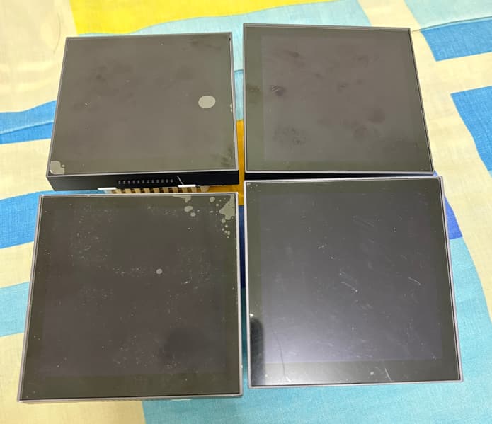

Anyone got S1E black screen issue. I got 4 out of 6 S1E breakdown after 1year. All 4 black screen and 3 still touchable. The failure rate is just so high 66.7%:rage::rage::rage:

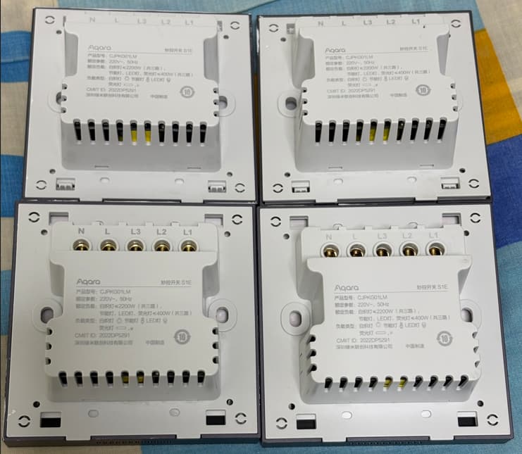

Faced the same issue. Black screen, but still functioning. I guess Aqara already aware of the led issue (my hunch due to overheat), hence the released of newer S100 panel. I got S100 as replacement yesterday, almost the same with S1E. you can see the improvement on the S100 design with much better airflow design. Extra hole on top and bottom.
Since my whole house is using Aqara product, yes, I got no choice and buy another 2pcs S100 to replace and let’s see how long it can last
I have four S1E switches purchased in April 2024, last week, two of them got black screen (but still functioning). USD 90 for a switch, just 2 years life span and I’m not the only one.
Lucky, I found the LCD panel parts in TaoBao which cost me USD 35 each, and fixed the switches.
