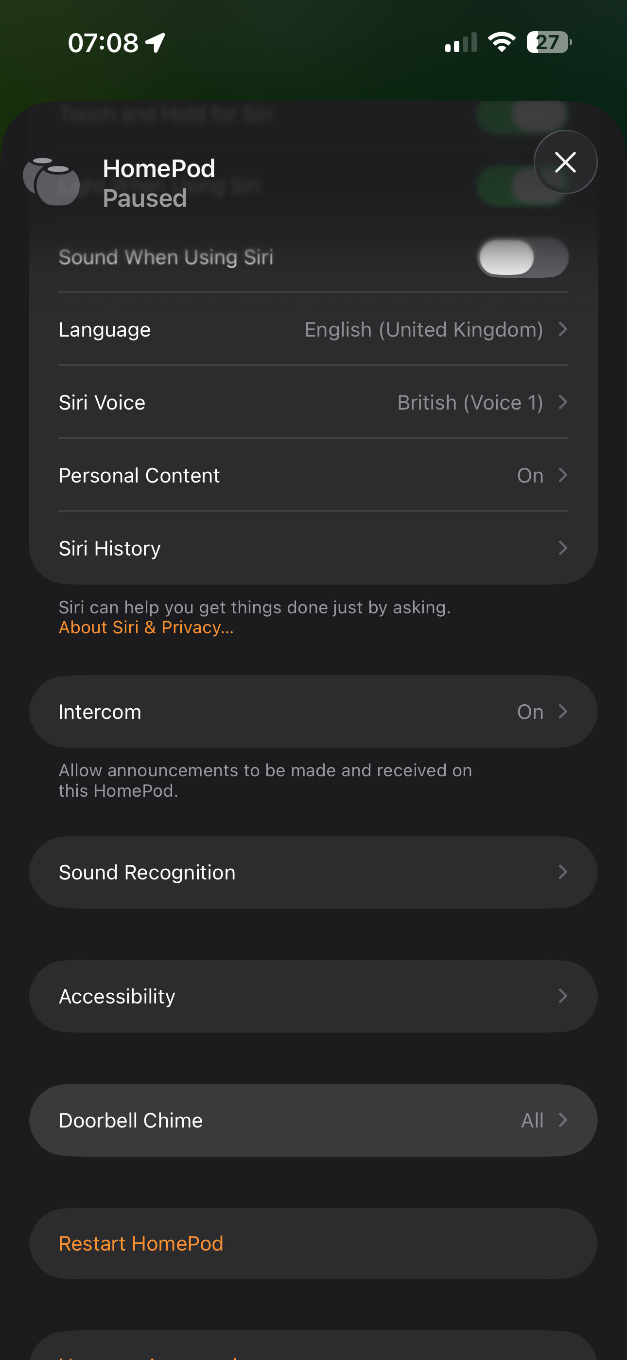

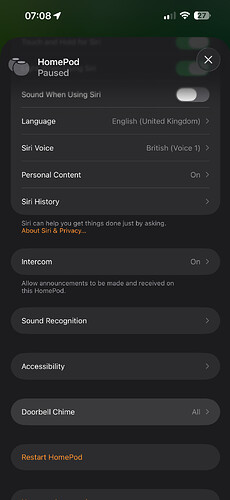

Go to Settings (:gear:) for any HomePod via Apple Home. All the way near the bottom is your Chime enablement.
Apple love to bury things in settings
Exactly. It can be accessed from the HomePod settings or also from the general settings of the house.
