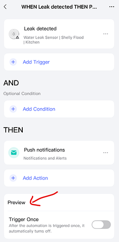

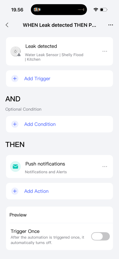

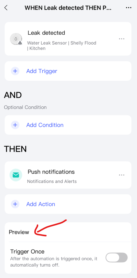

Here is a screenshot

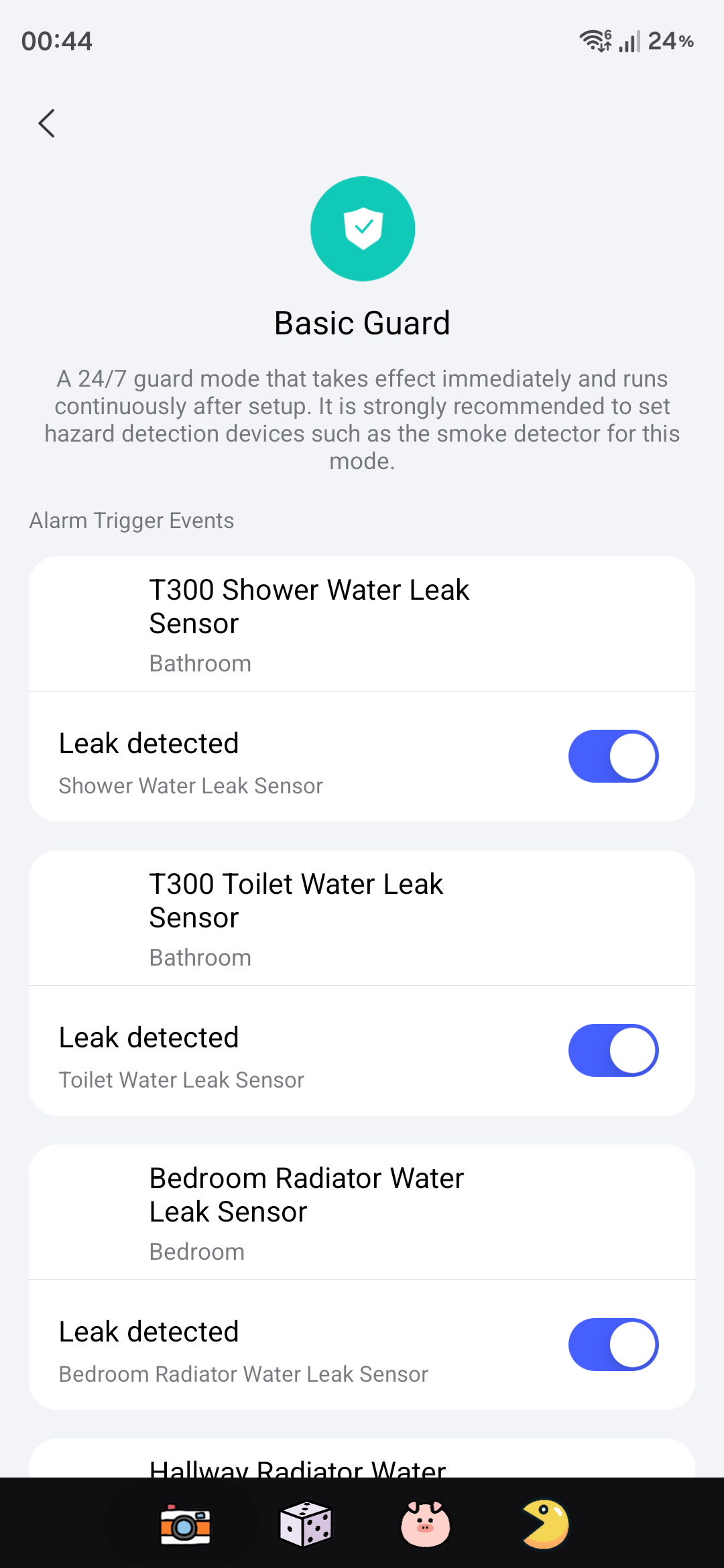

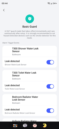

add it to basic guard, it will always trigger notification
Have you clicked Preview to see if the notification works?
What does the device show in the Accessories section of the Aqara Home app when you select it and the sensor has been flooded?

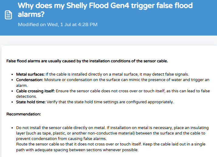

Wrapping it directly around the pipes would likely cause issues.
Image Source: Why does my Shelly Flood Gen 4 trigger false flood alarms? :
The sensor so detect water but the automation doesnt trigger.
How do i see the preview?
When you tap “Preview,” a notification should pop up. If you don’t receive a notification, it might be due to your smartphone’s settings.
Interesting update , when previewed i get an error message 7155 Push notification not supported :person_shrugging: what and why ? This makes no sense
