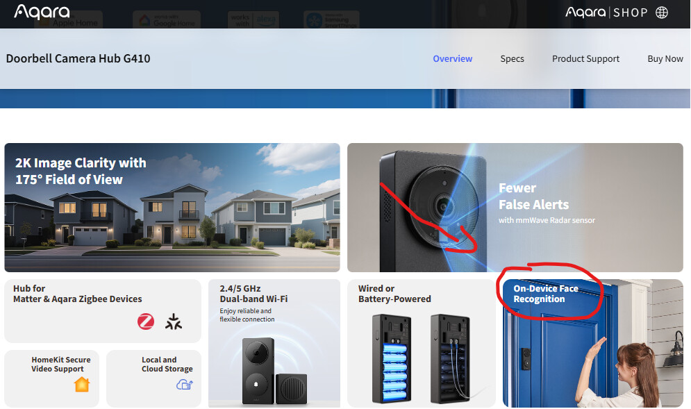

The G5 Pro is equipped with a built-in NPU (Neural Processing Unit), which enables device-internal AI object recognition and noise detection.
I couldn’t find any information about a built-in NPU for the Doorbell Camera Hub G410, but the shop at least mentions “on-device face recognition.”
