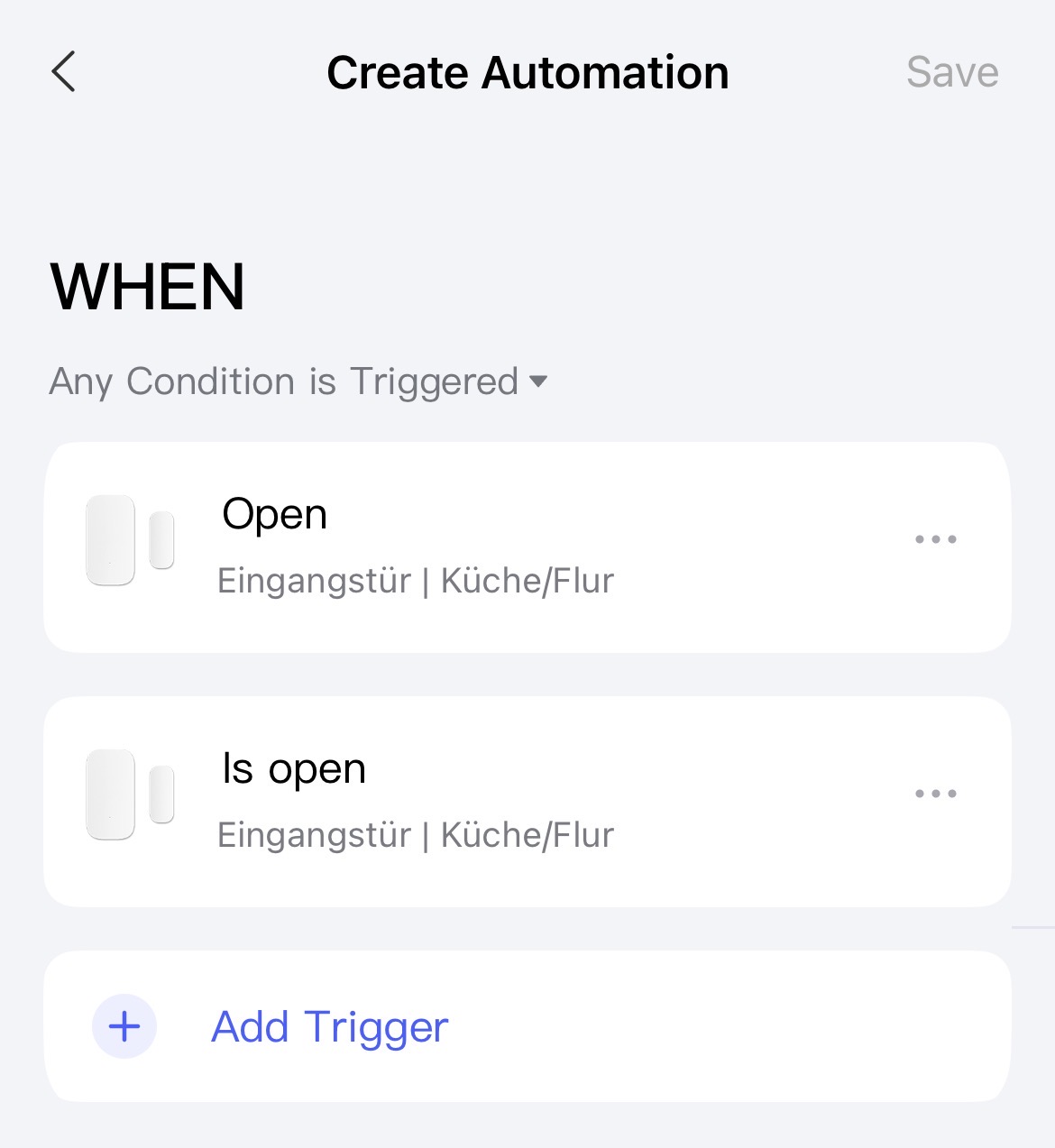

Lets start simple with just two devices; an Aqara hub and a door and window sensor and create two automations.
Automation A:
When:
Trigger = door and window sensor - option = Open
IF: …
THEN:
Acion = Send a message
Automation B:
WHEN:
Trigger = door and window sensor - option = Is open
IF: …
THEN:
Action = Send message
Now, switch off automation B
Open the door or window with the sensor and a message will be sent.
Close the door or window with the sensor and no message will be sent.
Automation A is working correctly.
Now, switch of automation A and turn on automation B
THIS IS WRONG.
In automation B I’m asking for the status of the sensor (is it open or closed) but I am not telling it when to run.
Automation B should not run at all.
Both automatons are giving the same result after opening the door or window and that is confusing.
Am I wrong here?
In your reply please focus on the WHEN section and how it works or should work in your opinion, otherwise it could get complicated very soon.
Workarounds are not the point here.
Hello, please make a screenshot of the automations. In addition to your question. Thank you.
Hi. He wants to know why both “Open” (type: event) and “is open” (type: status) are triggers in the WHEN block. Neither makes sense. Personally, I would say that only the event trigger in the WHEN block and the status trigger in the IF block make sense.

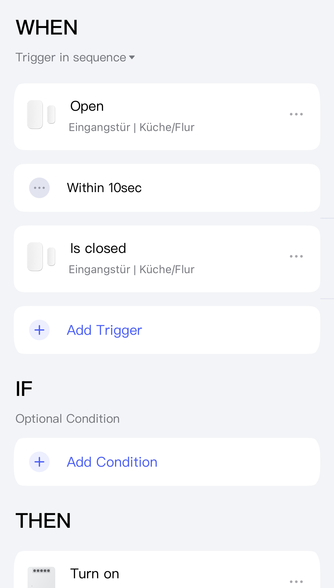

Hello, to explain, I will use two sensor conditions. (°) - instantaneous, one-time, an event occurred in time. (°°) - permanent, this is a state that is not instantaneous but includes the moment of triggering (°). In mathematics, you can write it like this, (°)=[(°)] and (°°)=[(°);(°°)]. Based on my description, your automation A and B are working normally (B=A).
I agree, in automation 2.0 there is a problem with the initialization (triggering) of (°) and (°°), this condition currently works as an instantaneous WHEN for the “Run anything” selection (°), and in the “Run sequence” selection as (°°).
I always use the status (°°) (for example in 1.0) in conjunction with another condition, another sensor or relay state. You know, when you give 1.0 two conditions (°) it says “Fix automation”, then you change (°)->(°°), this status (°°) is just for such conditions (example for the opening sensor).
Thanks for the explanation, now I understand that both types make sense in “Trigger in sequence”. My automation doesn’t make sense, but it works.
It makes sense, paired with a motion sensor we get a good automation that can control the state of the process open/closed/open/motion THEN.
